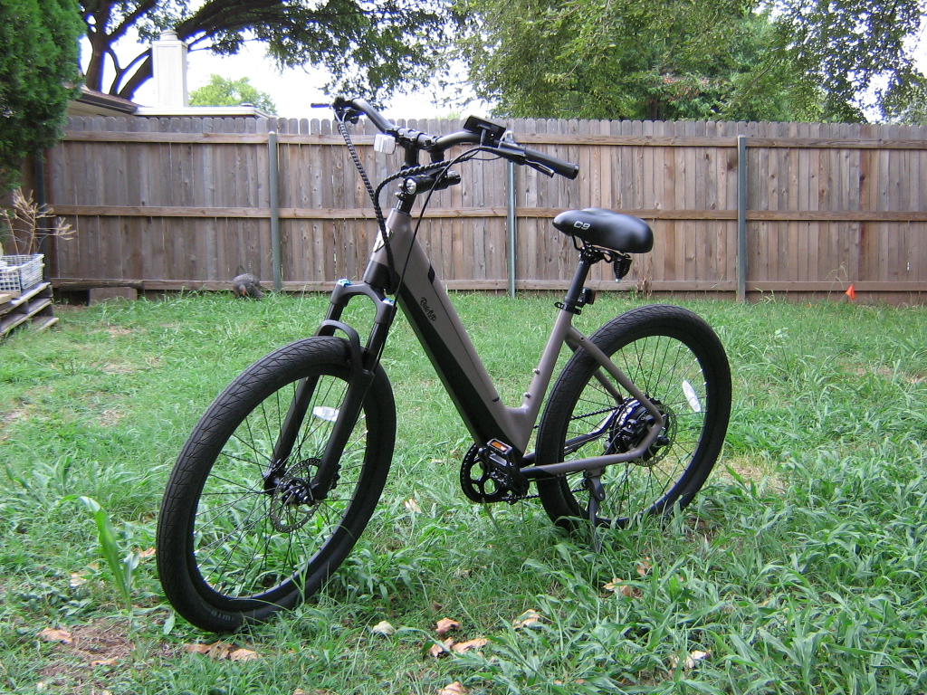

Here's a new photo of my ride, after installing the new stem to raise the handlebar, the new C9 seat, and a 1000 lumen "headlight" (flashlight in clamp mount).
I now have a nice upright riding stance, which is what I was after.
