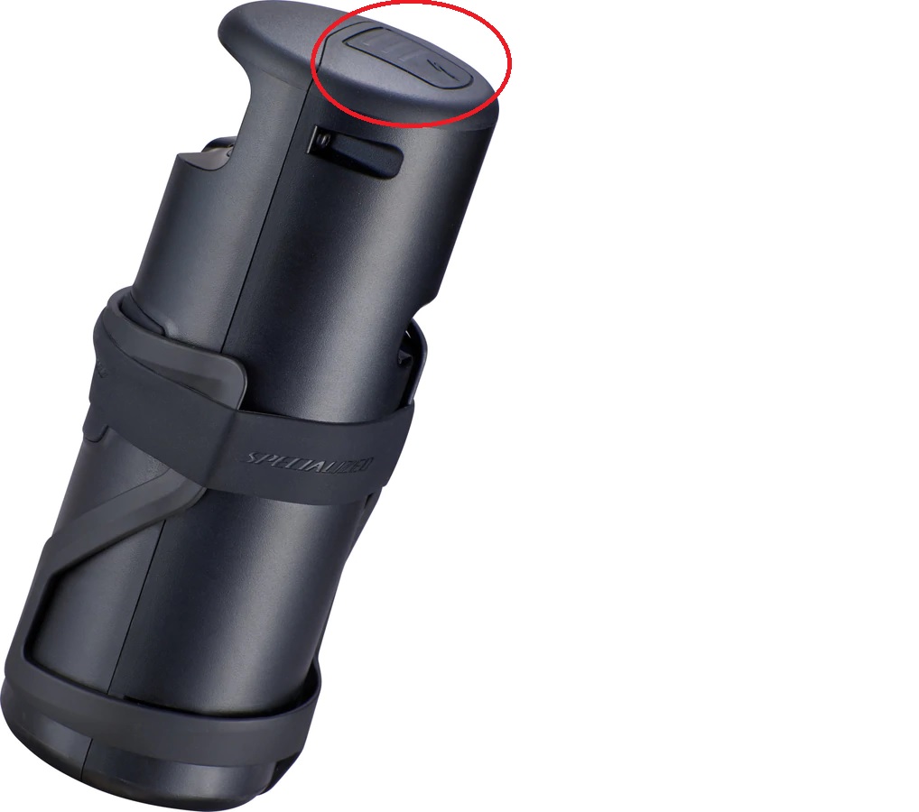

Follow up question,
What does this "red circle" do?
Stefan Mikes
Europe
Brwinów (PL)
It is the state of charge indicator. Press the "S" once and 1 or 2 or 3 bars will light up.

etgo
weird.. I pressed mine, nothing happened.
I plug the RE to the bike, TCU detect the it, blue and green lights display.

A stupid question: Has your RE been charged at least once?
Put in on charging. You will notice the green bars flashing.
etgo
Yes, I plug the bike charger to RE.
I plugged the charger to outlet, charger indicate red light .
Then I plug the charger port to RE.
RE did not indicate any light (no light at all).
After 30mins+ charger indicator turns to green (I assume RE already full charged), unplugged them all.

Strange. Why do not the LEDs work?
Can you check the battery charge with Mission Control after you have connected the RE to the e-bike?

Are you pressing on the Specialized Logo nearer the bottom of that display area. Not the LED bars.
