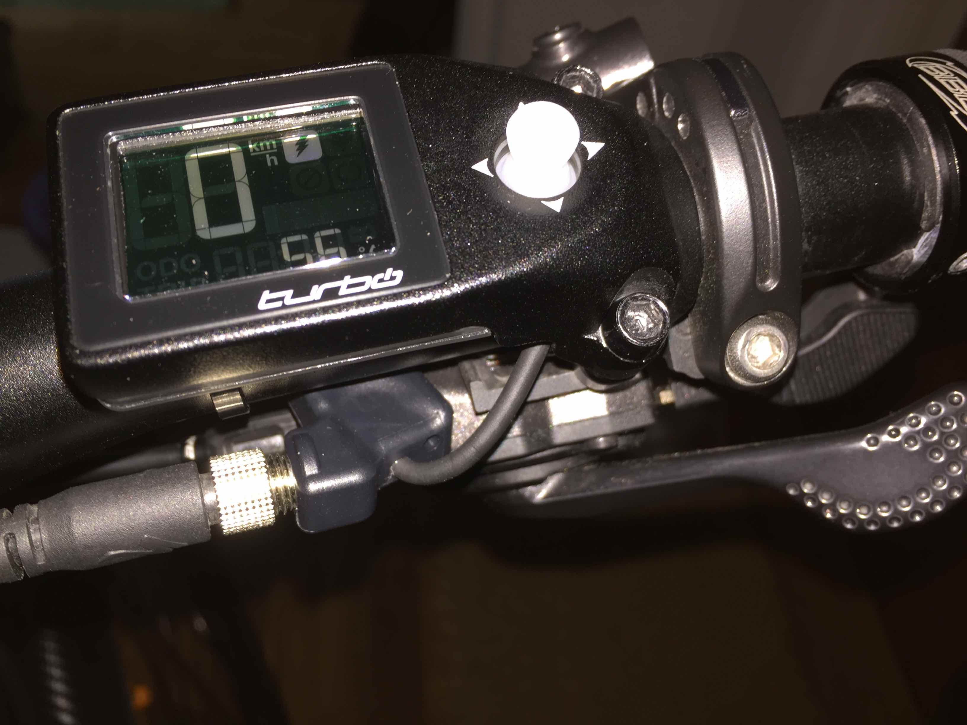

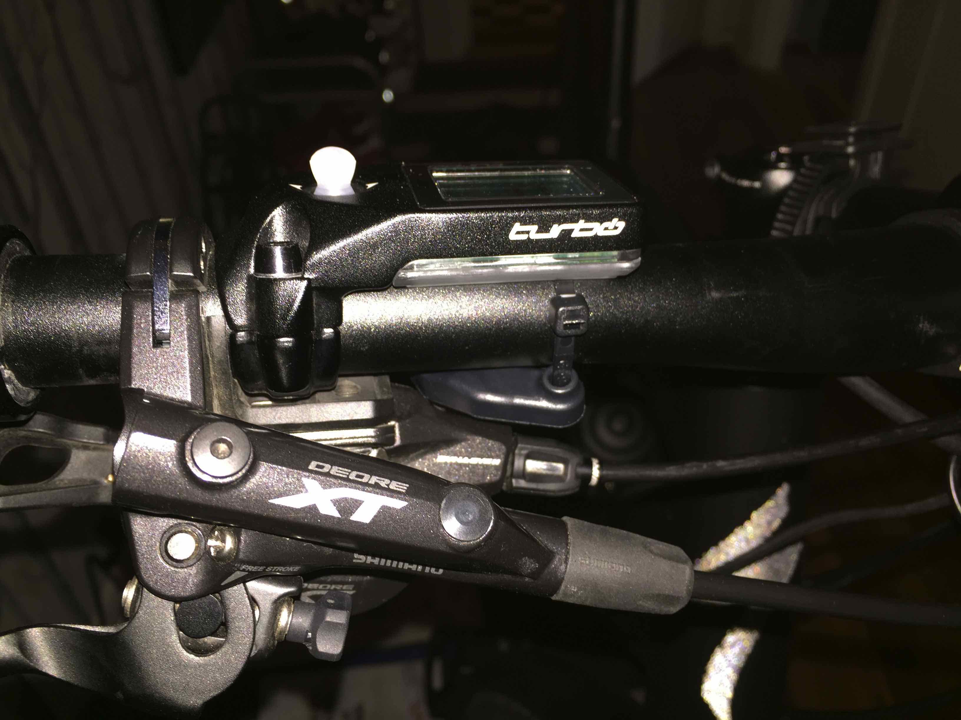

Just got back from Specialized dealer and they swapped display with a new display. It's new improved display instead of a smal cable underneath display on the old model they made some changes a short cable goes into a new connector device and zipped to the handlebar. Is much better solution. It happened to me a few time when I parked my bike outside grocery store and the display cable got hooked into handlebar on the bike next into mine. If their other bike own is not carful and yanked to get out his bike it could easily broke my display cable or other way around.
View attachment 7451 View attachment 7454
I have the same display in my Turbo FLR 2016. No problems with the display so far (1 month and a half of use). I was wondering if it's better to protect it with some nylon when it's raining. I do not trust too much in waterproof electronics (I don't remember reading in the manual that was waterproof though). Which dealer did you replace the screen? I am interested to know, as the bike shop where I bought the bike knows nothing about Turbos.
