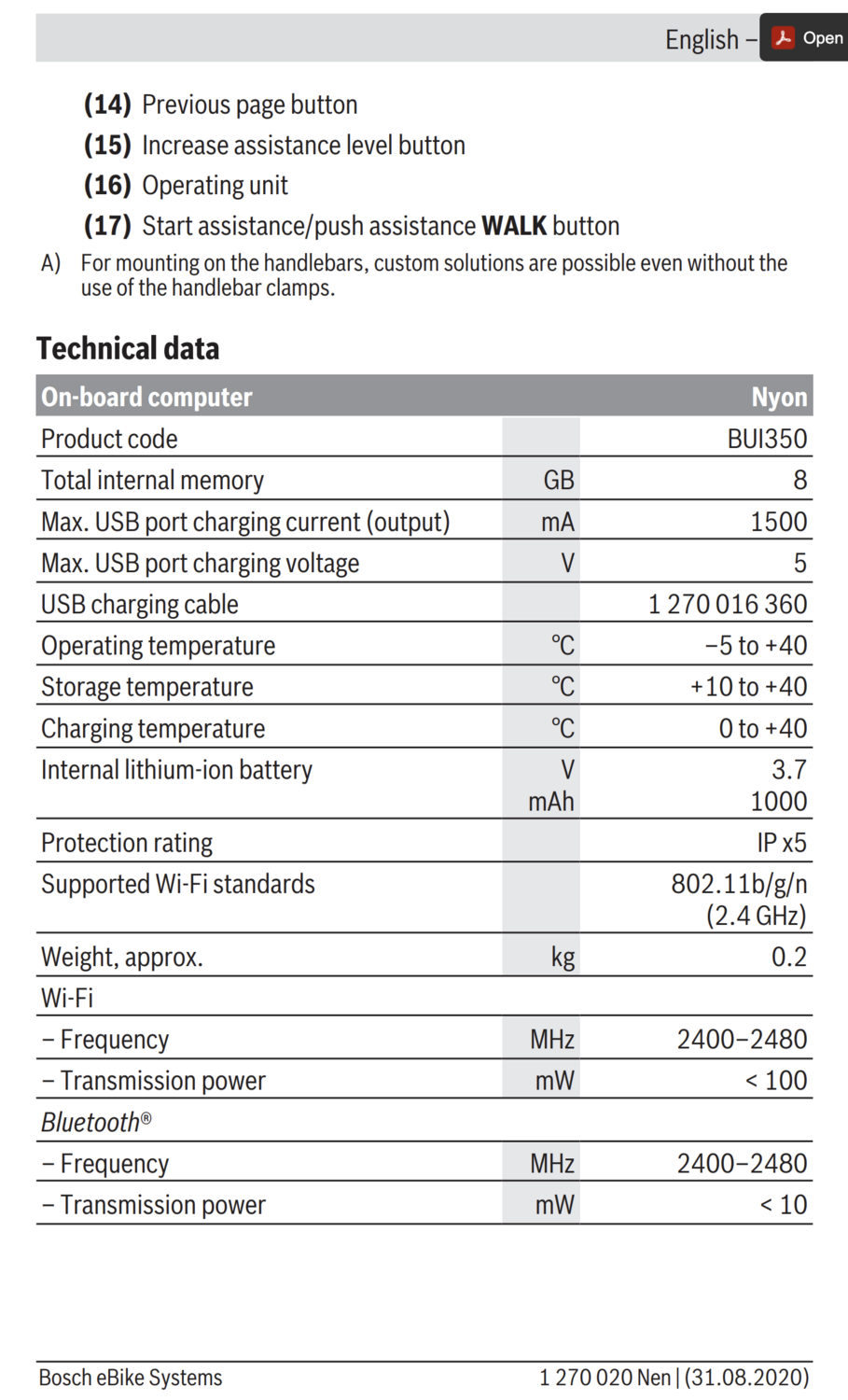

I believe you, but Bosch's documentation is all over the place. The 2020 Nyon manual on page 11 says "Max. USB charging current (output)" is 1500 mA. If it was input, it would just say how many milliAmps the unit consumes while charging. The fact that it specifies "Max." and "output" would suggest that the hardware could perhaps charge another device but evidently they've turned it off in software.

Good morning, @sakumar ----thank you for bringing this to my attention. I can see where this message on our site could be clearer. I will push this on to the folks in the office so that may be edited.
Purion-- no third-party charging
Intuvia- 500mA third-party charging
Kiox- 1,000mA third-party charging
Nyon- no third-party charging
Smartphone Hub- 1,500mA third-party charging
