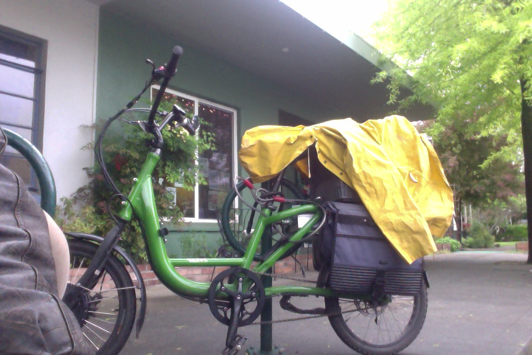

It seldom freezes here. The barn I park my bike in is not heated. I use my bike nearly every day - rain or shine, and I am out and about nearly every day and routinely plug the charger in when I park it at home. When I am out, the bike is parked and locked out in the open and we have had a lot of rain. Have continued having electrical problems off and on. Each time we have applied a treatment (changed the cables - cleaned the connections) the system works great for a few weeks or even 2 or 3 months, then starts acting up again. I think I may have found the problem though this week after it was parked and ridden through yet another heavy rainstorm. I think it was the throttle, as I could get the drive wheel to spin by wiggling the cable connection.
The cool weather effect on battery life was driven home by riding it on a trip to the county seat on a 45+/- degree day. The roundtrip is about 50 miles. I have the large battery and thought I could make it. I pedaled the last -relatively flat - 10 miles. It was very slow going and took me a couple hours. I do not want to make the same mistake again. It will be interesting to try the trip again (with backup) when summer temperatures return.
I was wondering if anyone had found a good kickstand for the bike. The off the shelf and suggested ones for the bike are both inadequate. The double stripped its gears and the single is about an inch and 3/4ths too short. I have to carry a block of wood with me to set under it to keep it from falling over when I have a load.
