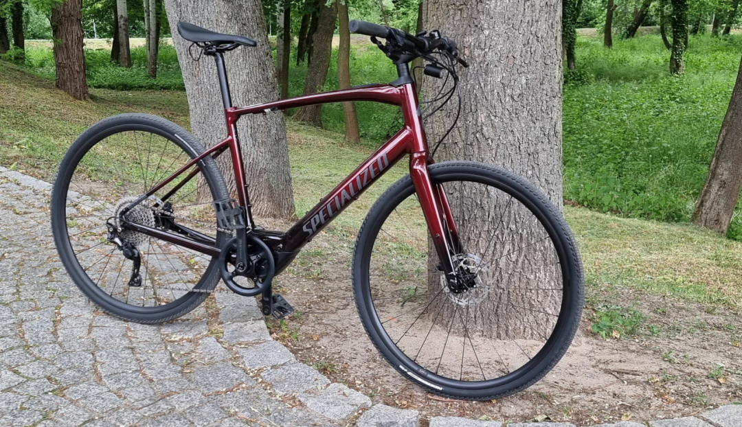

Ah, the hub-drive motor by Mahle. No, thank you. I ride a Mahle mid-drive motor called Specialized SL 1.1 ;) 48V, 240 W, 35 Nm.
As fine Shimano equipped e-MTB Orbea makes as they totally missed the train with their e-road and e-super lightweight bikes :)

I also have one minor complaint about Vibe. When it already delivers flat pedals with the Vibe bike, then Orbea could put some better quality pedals. In fact, the pedals are not as bad for pedaling as they are inaccurately made, so they are audible. It could be better with a € 2,500 bike, or simply deliver a bike without a pedal.
This is how it is done in the market. The most expensive bikes and e-bikes come without pedals because the aware rider would use their own preferred pedals anyway (it is as if you were offered with shoes that you wouldn't like). A bit less expensive bikes and e-bikes come with generic pedals, as it is assumed you need to be able to ride the bike until you have installed your own pedals. For instance, some people cannot live without "clipless" pedals and cleated shoes. Some (as I) cannot ride without large platform pedals with traction pins -- and matching shoes. The pedal replacement is the first thing the aware cyclist does to their bike.
BTW: Stefan, I’m using the words “less” and “more,” which is absolutely different from the term “looks like” that you used. Thus, turning pedals mounted on a classic BB is a drastically different experience compared to turning pedals mounted on a motor shaft. And that's it, a matter of taste. But, the taste is not discussed.
It is very disputable, as the power distribution from the mid-drive motor is perceived as far more natural than it is from a hub-drive motor. I have owned as many as four e-bikes, three mid-drives and one hub-drive and my experience is totally different from yours.
Besides, it is not the matter of the motor location but how good have manufacturers designed their lightweight e-bikes to achieve their goal. Both Orbea and Specialized successfully made their goal, only the motor arrangement is different. To make it more funny, both X35 and SL 1.1 motors come from Mahle.
Interestingly similar e-bikes of similar weight.
ngg: You didn't have a chance to ride an SL e-bike, did you.
