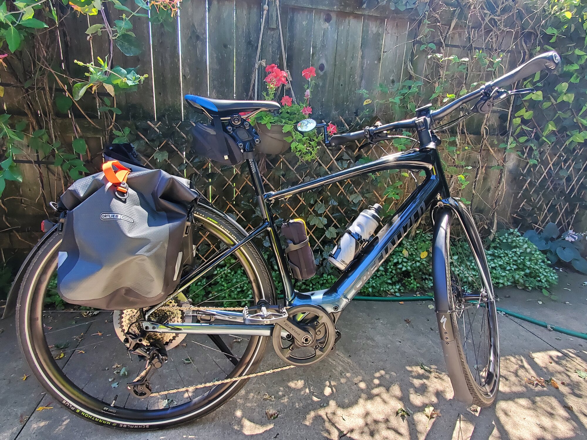

The science experiment is all set. WTB carbon gravel rims, Aerothan tubes, Onyx Vesper hub and the Marathon E-Plus tires. I haven't ridden it yet but will do so today. I say science experiment because I'm justifying this expense by saying I need to contribute to the forum community by proving whether a reduction in rotational weight and a hub upgrade can affect range. I think I've collected enough range data to get some good comparisons. Most of my range data was with the Marathon E-Plus tires but stock rims and hub. The only problem for comparison though is my collected data is all in the upper 40s and 50s as far as the coldest days. Today's ride will be at 35F. It might be March until I can get some comparable weather. I've also swapped the Thudbuster ST for the Redshift. My inclination was to use double springs for a firm ride but the body weight recommendation for that starts at 198 pounds. So I'll start with a single spring and see if it is too bouncy or soft.
Vado_WheelbuildA.jpgVado_WheelbuildB.jpgVado_WheelbuildC.jpgVado_WheelbuildD.jpgVado_WheelbuildE.jpgVado_WheelbuildF.jpgVado_WheelbuildG.jpgVado_WheelbuildI.jpg

The science experiment is all set. WTB carbon gravel rims, Aerothan tubes, Onyx Vesper hub and the Marathon E-Plus tire ... I've also swapped the Thudbuster ST for the Redshift ...
I did a 20 mile ride in mid-30s temperatures. Yes, the bike feels like it accelerates faster. But what I noticed more was greater comfort. I rode at a higher PSI and it felt more comfortable - as felt both in the hands and the hind quarters. The Onyx Vesper hub is silent
The Redshift is a winner. The single spring with a pre-load of 4 at my body weight is still quite firm. I could probably ease off that preload a bit and still have it firm enough for my tastes. I can't say I feel much difference versus the Thudbuster ST so given the Redshift has a slimmer profile and similar weight, I would say it is a good product. I think the Thudbuster ST is a bit less expensive.
