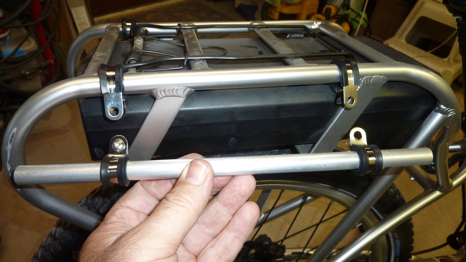

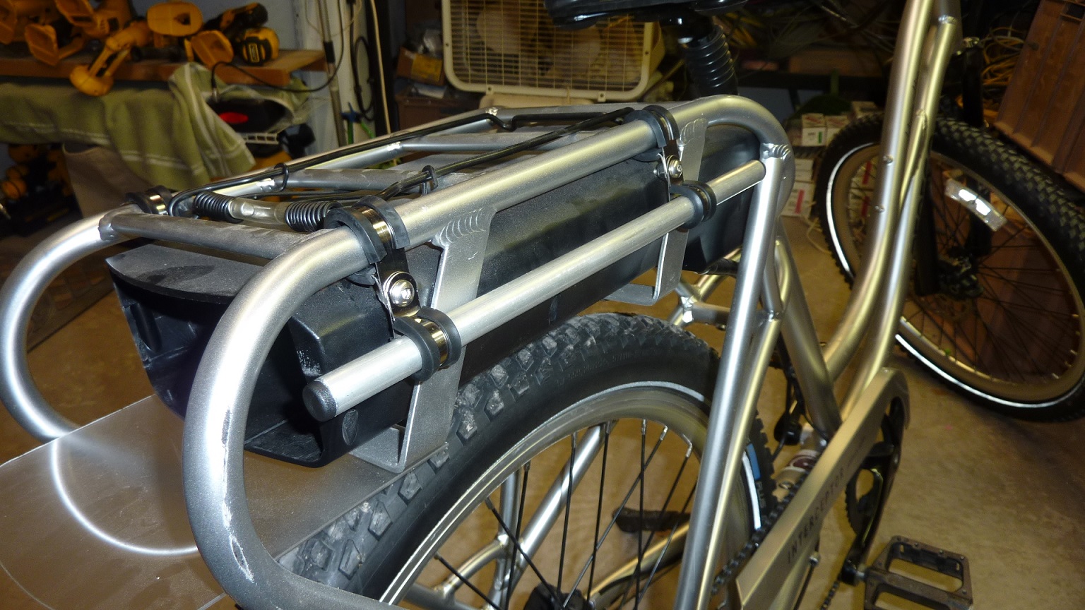

It appears the tubing used on the Rad rack might be too large in diameter for the pannier clips. You might contact Rad and Timbuk2 for their specs.

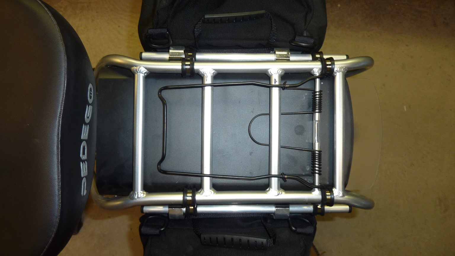

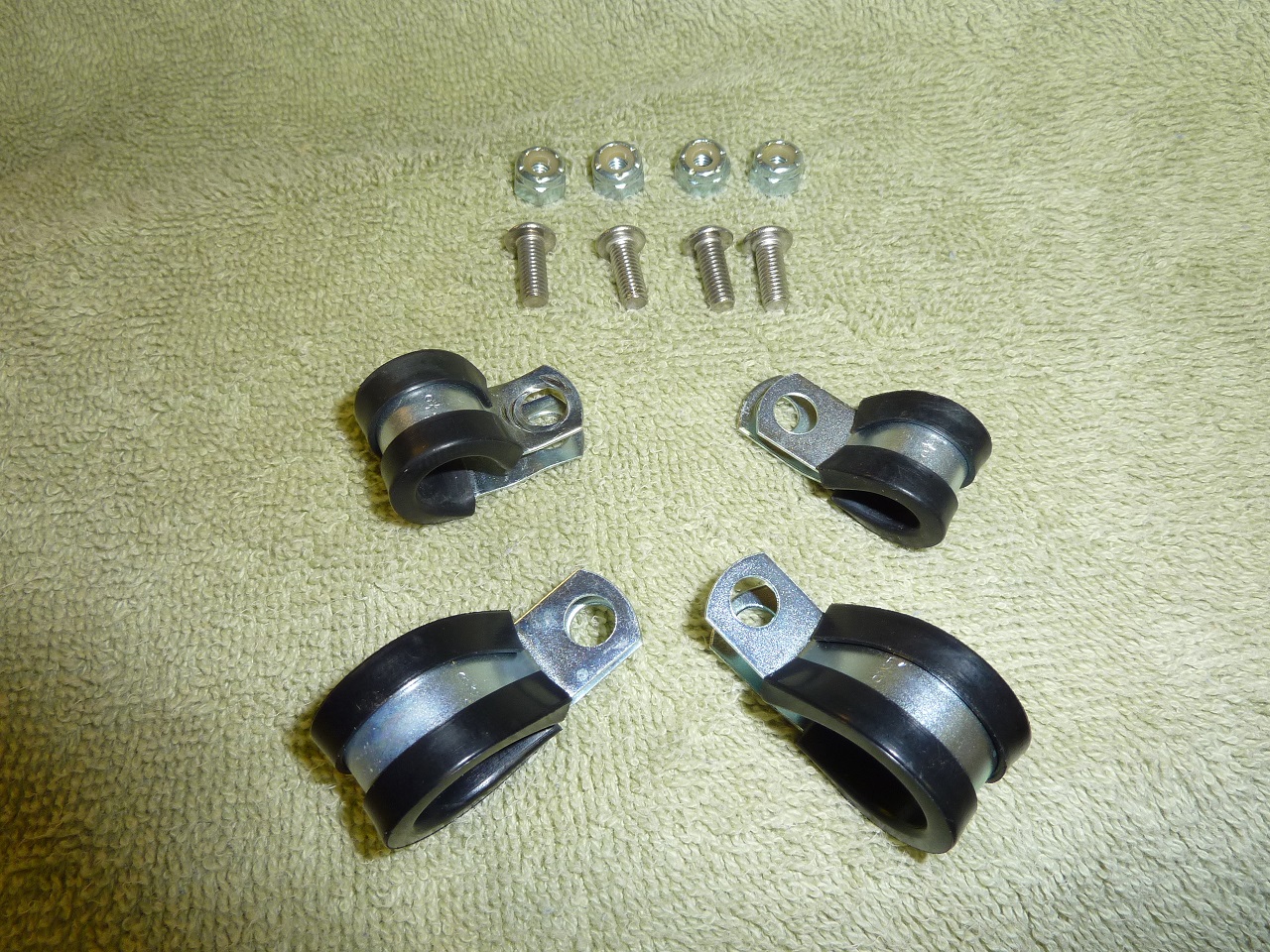

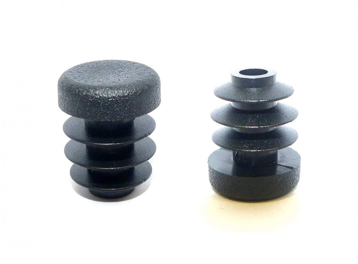

If all else fails, you can make a simple adapter with a piece of 1/2" aluminum tubing and these parts available at Home Depot:
P1070096a.jpg 61zPDf6LhLL._SL1500_.jpg P1070445a.jpg P1070449a.jpg P1070456a.jpg P1070450a.jpg

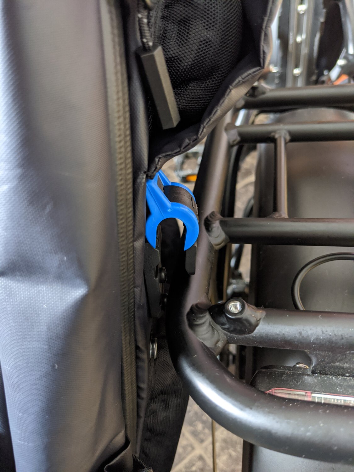

I ordered one to see if it would fit and it arrived today. Thanks Amazon Prime 😁
The looks great and is exactly what I was hoping for. It converts from backpack to pannier in seconds. However as we suspected the clips are far too small to fit into the Rad rack.
I definitely want to keep this bag it's perfect for my needs. On first inspection it looks like the clips are pretty easy to remove by just removing 2 screws from each. In fact I'd say they are designed to be replaced easily. This has got me thinking I can probably replace the stock clips with larger ones if I'm able to source some....
