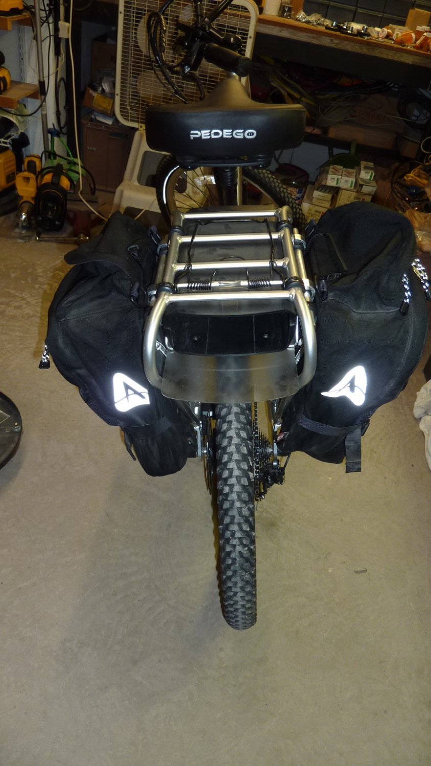

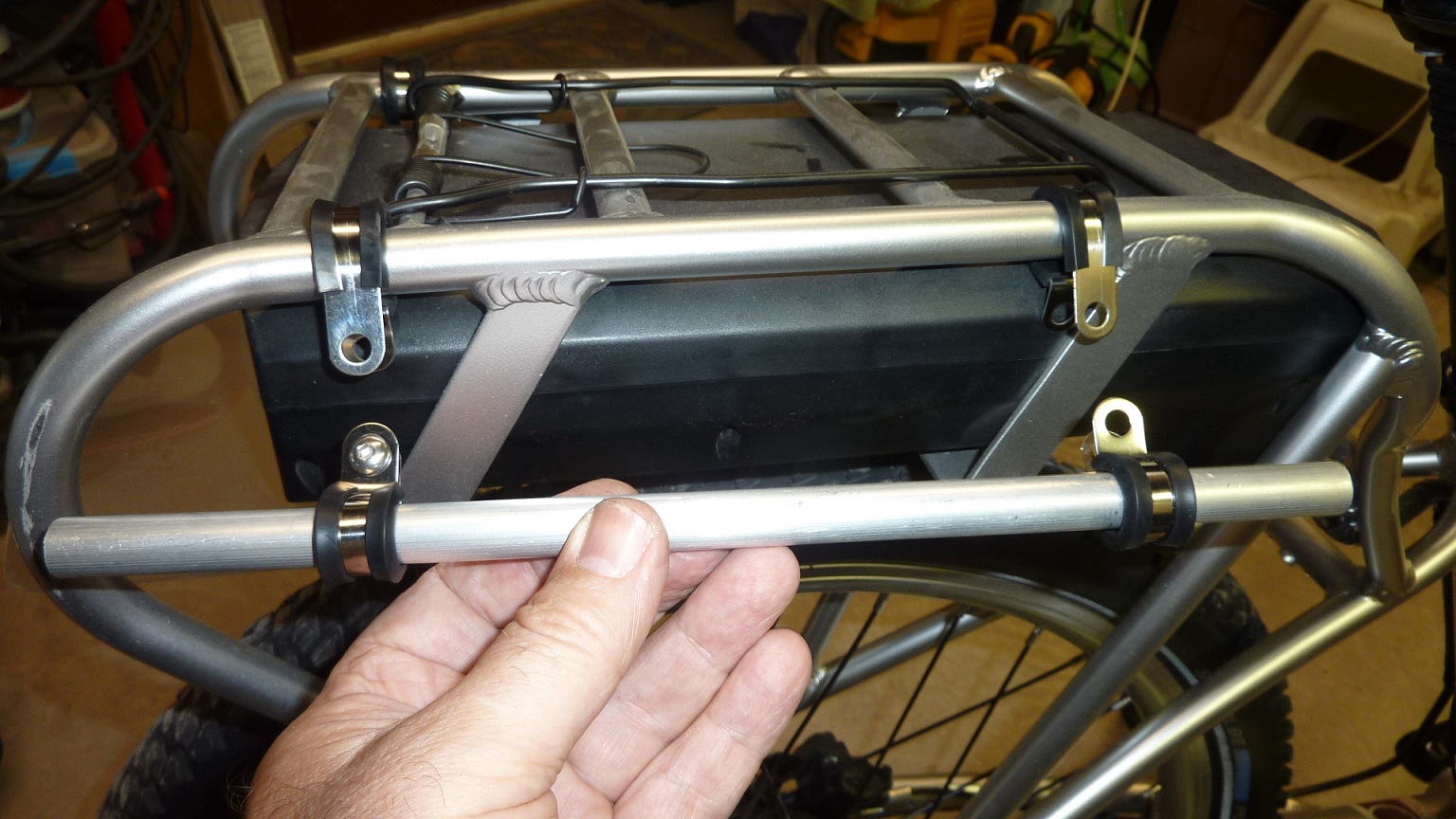

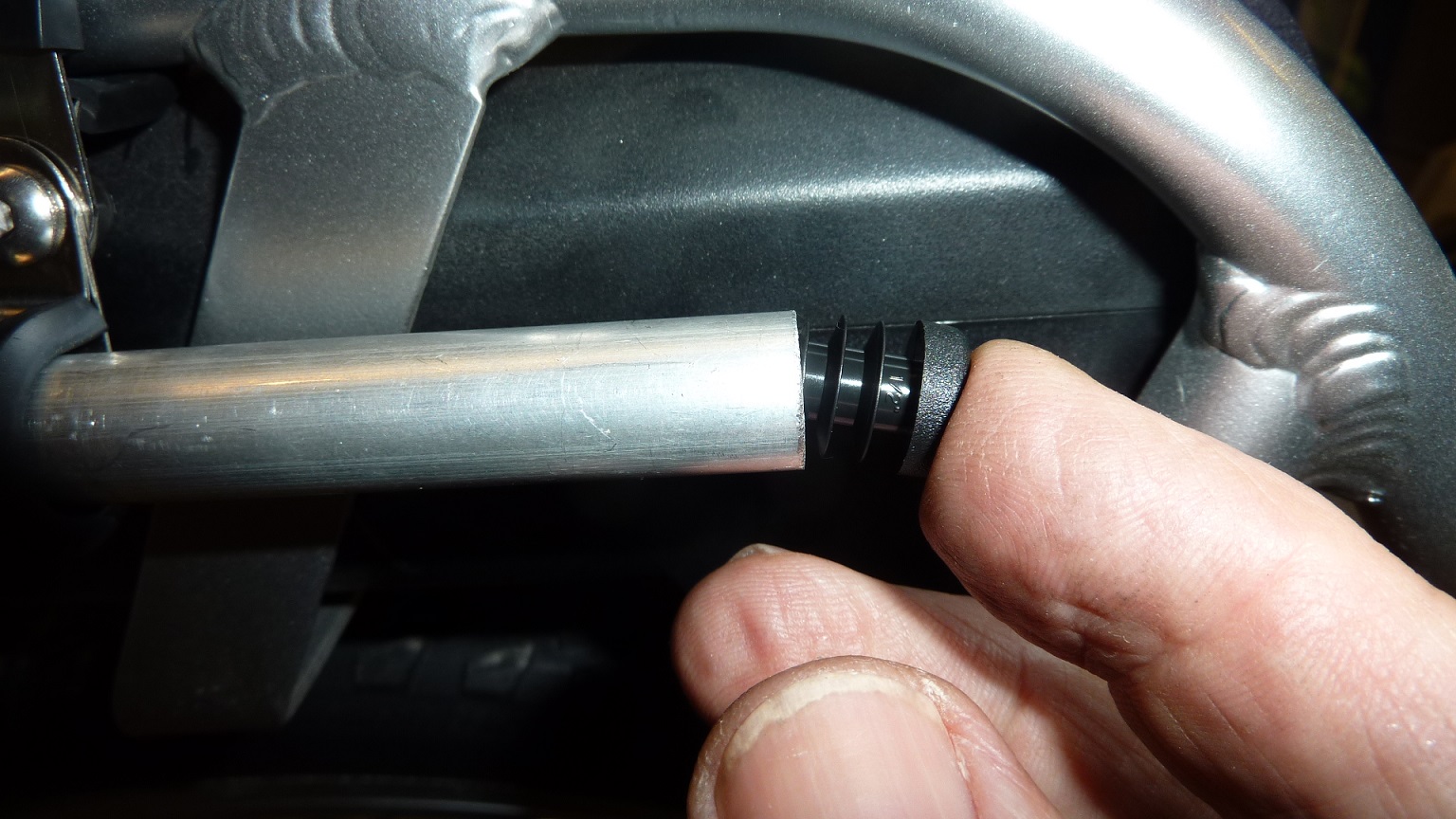

You can make a frame "adapter" with pieces of 1/2" aluminum tubing and appropriate size insulated cable clamps.

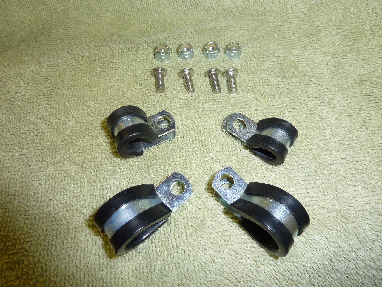

39792 The 1/2" size clamps are required for the tubing and the 5/8" size will fit most oversize bike frames.

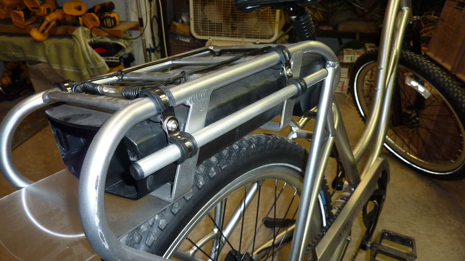

39793 A 12" length of tubing is usually adequate for most panniers. It is available on Amazon but could be obtained locally at a better price

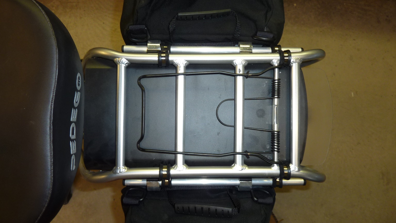

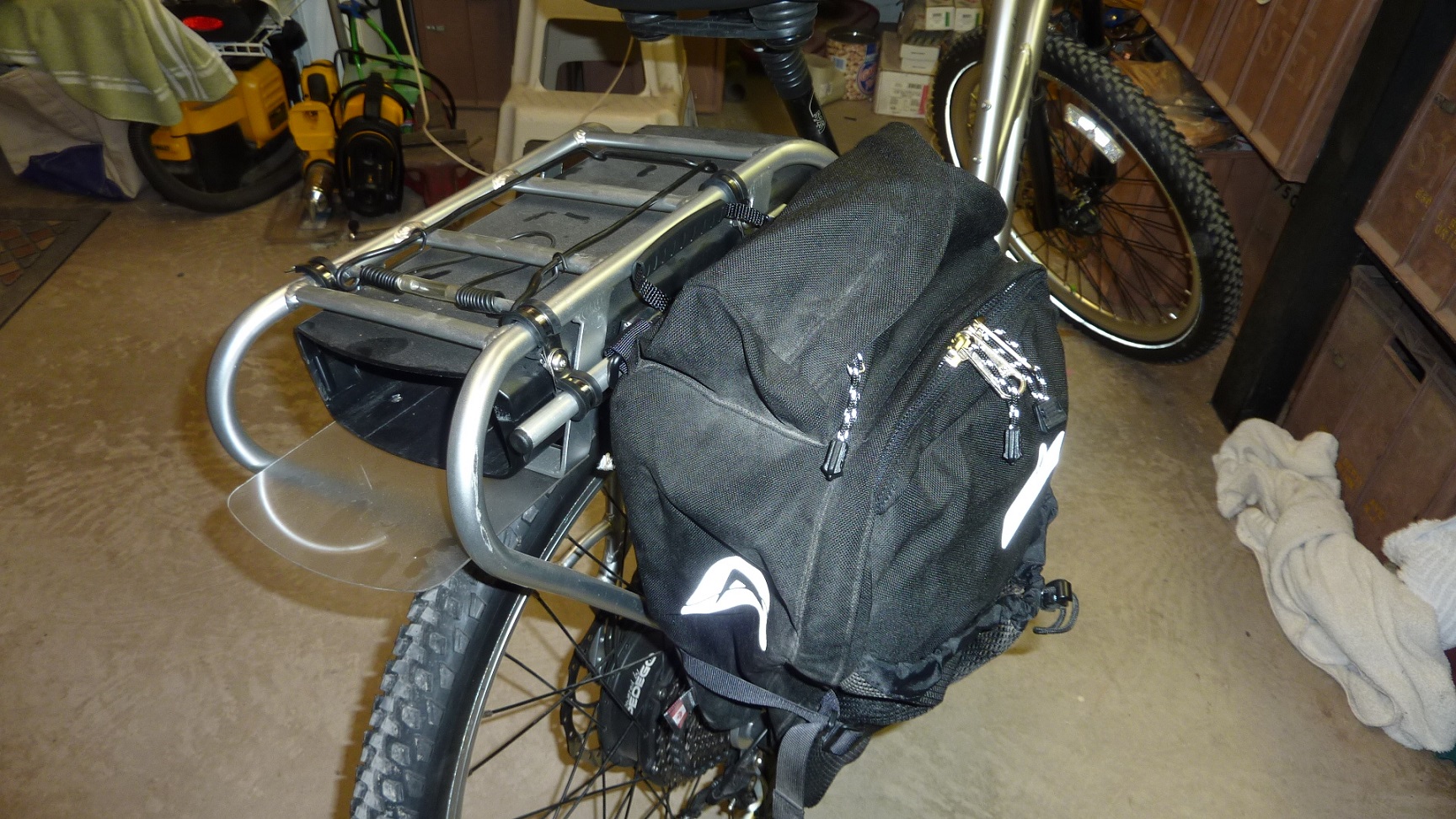

39794 For a finished look, these plugs can be used on the tubing ends.
39795 39796 39797 39798
Installation is simple requiring only a screwdriver and pliers. A hacksaw may be necessary if the 12" tubing needs to be shortened.
View attachment 39792 The 1/2" size clamps are required for the tubing and the 5/8" size will fit most oversize bike frames.
View attachment 39793 A 12" length of tubing is usually adequate for most panniers. It is available on Amazon but could be obtained locally at a better price
View attachment 39794 For a finished look, these plugs can be used on the tubing ends.
View attachment 39795 View attachment 39796 View attachment 39797 View attachment 39798
Thanks very much for your reply and advice. I think I'll give that a go!
