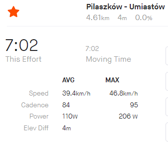

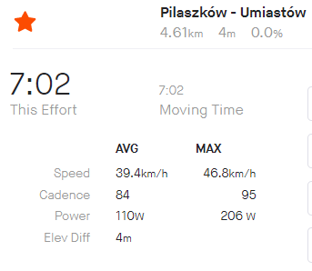

I have found it practical to rotate the cranks at 80+ rpm. The Vado motor rewards you with "enthusiastic" assistance at such cadence. Faster cadences mean Vado is apt to accelerate very fast. If I want to make impression on my traditional riding buddies, I downshift dramatically then spin. They are left in the dust.
Before this year's vacation, I swapped my 48T chainring for a 38T one. The reason was to make the e-bike a better climber. That of course, required pedalling at higher cadence to maintain the same speed. I'm so happy with the change, I'm going to keep it for a longer while. Especially, cold starts are more effective for me now.
With mashing at low cadence, you theoretically input the same leg power that should be assisted by similar power by the bike. Yet, I feel my Vado being somewhat sluggish at low cadence.
Note: I can pedal up to 110 rpm, and 120 rpm happens to me in bursts. Vado just flies at such cadences!
