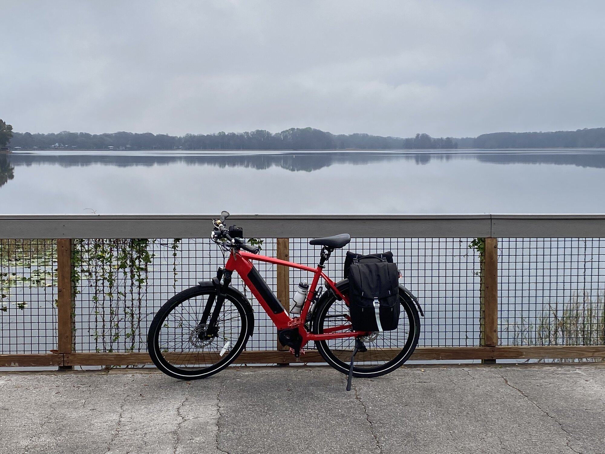

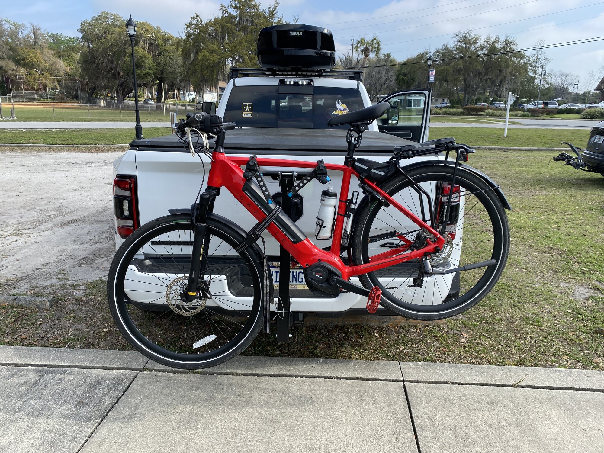

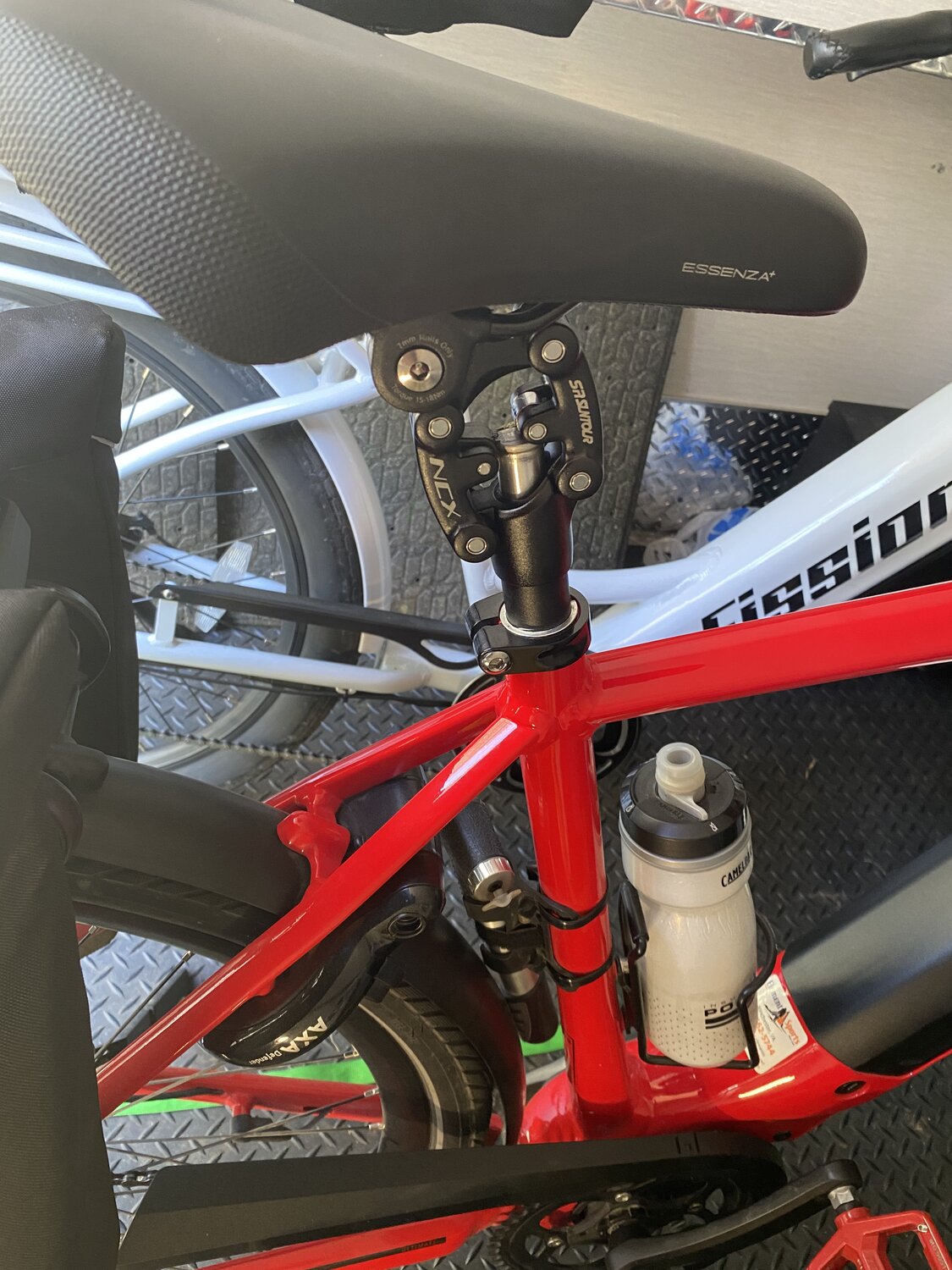

I have a Gazelle T-10+ Ultimate and love the bike!! I changed the pedals, and added a Suntour seat suspension and I find it has all I want or would need. Excellent components, strong hydraulic disc brakes and great build quality. I also added the Gazelle Paniers with the MIK rack lock system, another wonderful pairing!! Specialized seems to have more dealers nationwide, but personally I did not like their bikes as well. Your mileage may vary.
