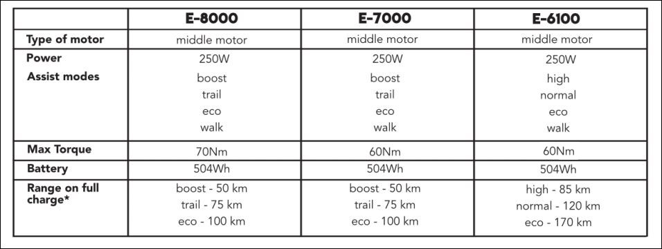

Hi Franco,
Glad you asked about the E6100 compared with the Shimano mountain bike motors, E8000/E7000, and the new EP8.
They are designed for high power & torque and offer a reduced range as a result... the E6100 is the champ for max range.
Both of my road bikes are optimized for range with the E6000, while my mountain bikes are optimized for high torque. Hope this helps. ;)

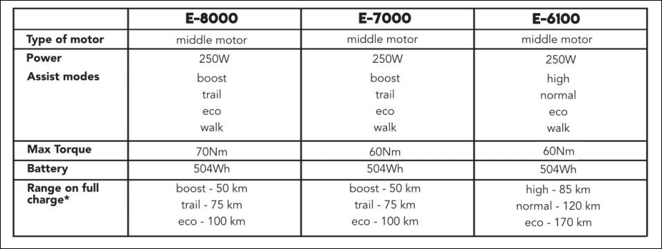

Hi Franco,
This comparison table is beautiful. Can you explain to me what is the difference between Boost and High? ... and also between Trail and Normal? ... maybe because these types of engines - I mean E8000 E7000 - are for eMTB and not for eRoad?

Franco, check out pages 44-45 of the Service Manual. It explains how Shimano got the range numbers in the chart above. The E8000/E7000 test course has a hill and an extra stop-go, while the E6100 test course is flat. It's great that Shimano publishes the specific test conditions.

I have found these range estimates to be very close to reality when I am cycling on and off-road.
