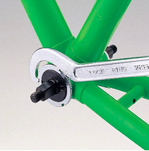

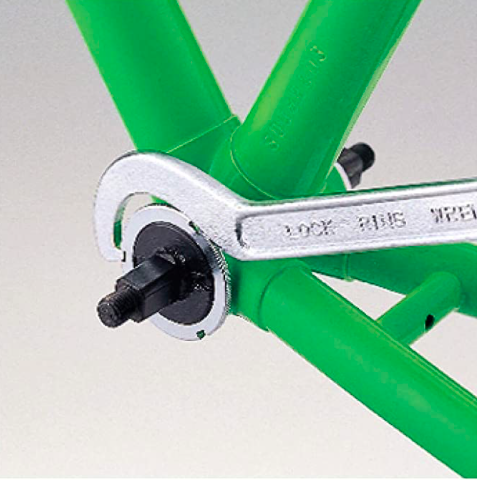

A Shimano BB socket for the secondary lock ring is useful. A simple lock ring wrench and a rubber mallet with some Blue Loctite and never a drop. Just get a stabilizer if you can't use torque settings.

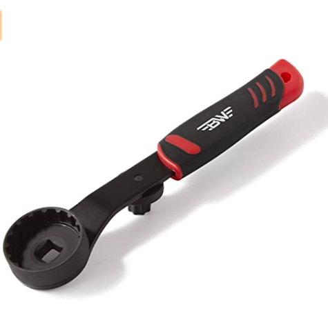

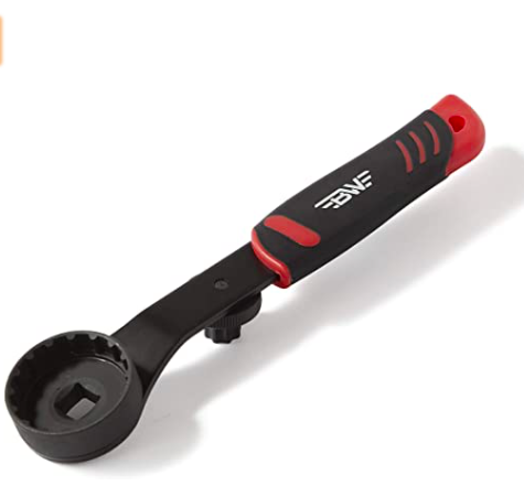

Thomas - After posting, I found a thread online stating the primary Bafang BB nut should be torqued to 60 to 90 ft lbs. (?)
From what I'm reading that will be difficulty with the Bafang wrench that comes with my kit.
Found a slightly lower priced socket here - https://california-ebike.com/shop/bafang-professional-bb-tool-bpt-1
What is you opinion of this socket? I have quality torque wrenches, but it appears that this tool is tightened with a spanner, rather that 1/2" drive? (they opted to put a shaft seal removal tool on the back side)

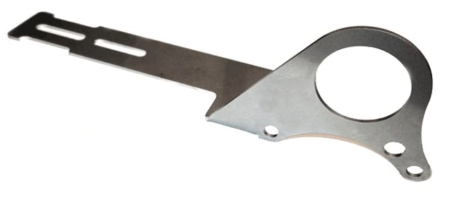

And if I'm reading your post correctly....your saying if you tighten with the stand Bafang BB wrench, use one of these stabilizer bars?

The problem with that torque arm is that it causes the motor to hang down from the BB at a weird angle. Might work better flipped and secured to the seat tube.

7. As for the torque arm, I decided to try the turnbuckle approach as it seemed more elegant than the above torque arm, and that has worked:
I like the products I work to support! The socket needs a large crescent wrench or a 1 5/16 open end. SometimesI use a rubber strap wrench. But mostly I use a Hozan lockring tool and a small rubber mallet with some Blue Loctite (never red!). Doug designed the stabilizer and left it open access. There are many cheap copies these days and the Heavy Duty is best for BBSHD. Making torque setting redundant. A Shimano BB socket is better than the rip off Bafang tools. I had a set, originally they sold the set for under $55 when Lectric Cycles and others were selling them for $135.
View attachment 59104View attachment 59105
Thank you Thomas, really appreciate your expertise! If the Hozan lockring tool is working for you, and no stabilizer bracket required (after tightening with that and blue Loctite) that seems like the way to go. As a bonus, the Hozan tool looks like it could be used for the other BB applications.
Clyde
It's my understanding that the BBSxx drives want to rotate clockwise, toward the downtube, so if you get a nice, tight install close to the downtube, and don't do many jumps that might cause the motor to break away and rotate down, you shouldn't need a torque arm.
