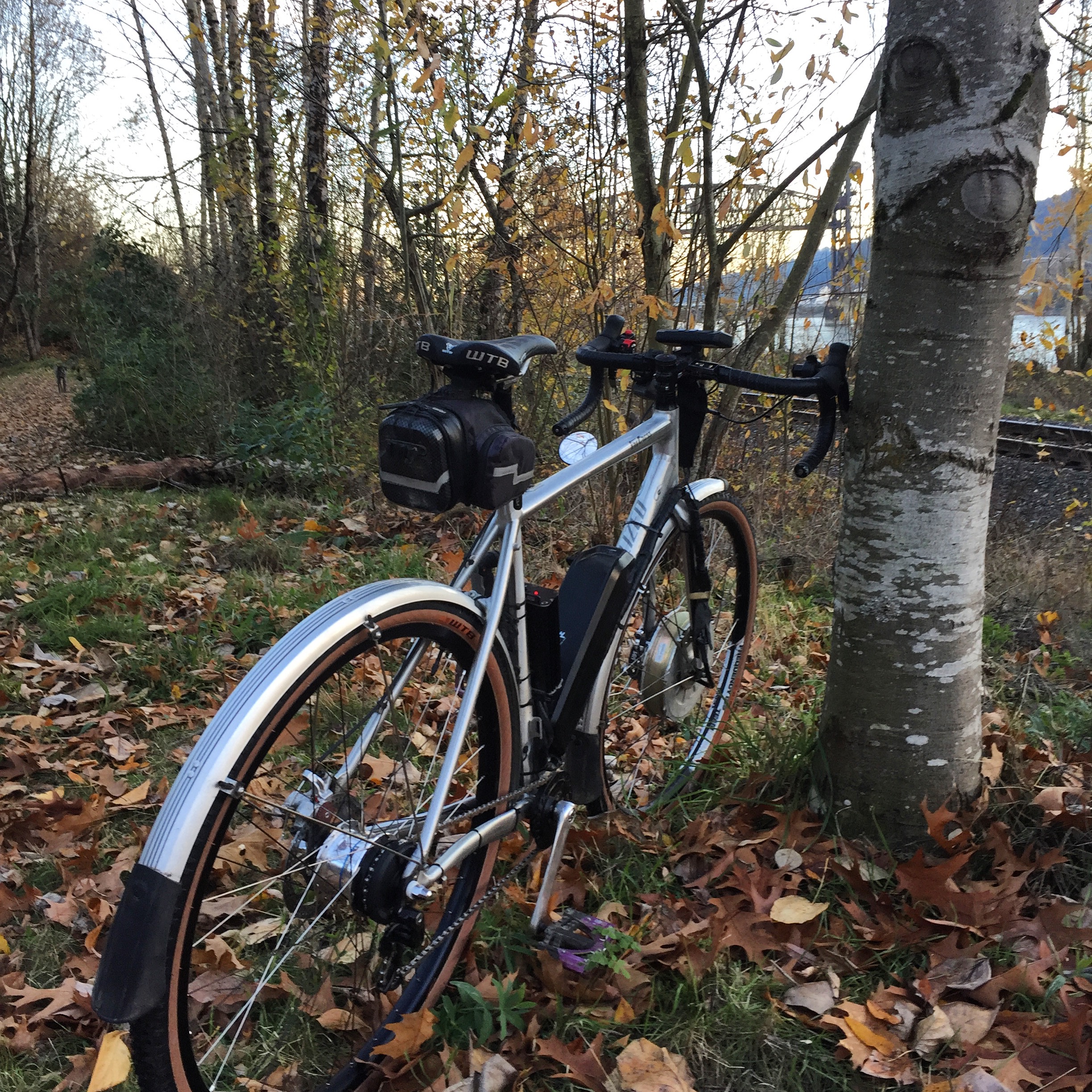

So I've been thinking about getting a Shimano Alfine 11 speed IGH for my quick-e. Did some reading and measurements and it looks like it will fit. I asked LBS and they said yeah it should be doable and they also thought that this bike should've come with an IGH to begin with given the rider it's targeting. They probably didn't go that way to keep the price down.
It's a pricey upgrade, but looking at the gear ratios for the 11sp it would actually give me a much higher top speed using the stock 42T chainring plus it would allow me to change gears at a standstill the lights.
I asked about the rims that came with the quick-e and if I could buy a new rim for the conversion, they said that they don't sell those rims at all, even if you crash the bike they couldn't even get replacements from giant. They said you just need to buy a matching size from a different brand.
With the IGH this bike would be quite the ride. I might try to get the parts online and get the LBS to lace the wheel and put it together.

I like the idea of the Alfine hub for my dirt E+2.
Paired with the greenped dongle it might make a really nice bike.
JRA
I installed an Alfine 11 Di2 on my V2 bike.
Long story short it was an expensive trial and I have gone back to a conventional cassette system.
I will warn anyone considering any Alfine hub to make sure they use the correct tab washers for their drop outs design. There are three different versions and if you use the wrong ones, especially under the additional torque applied by the assist, the hub will not stay engaged properly.
cheekee
Thanks for the advice.
