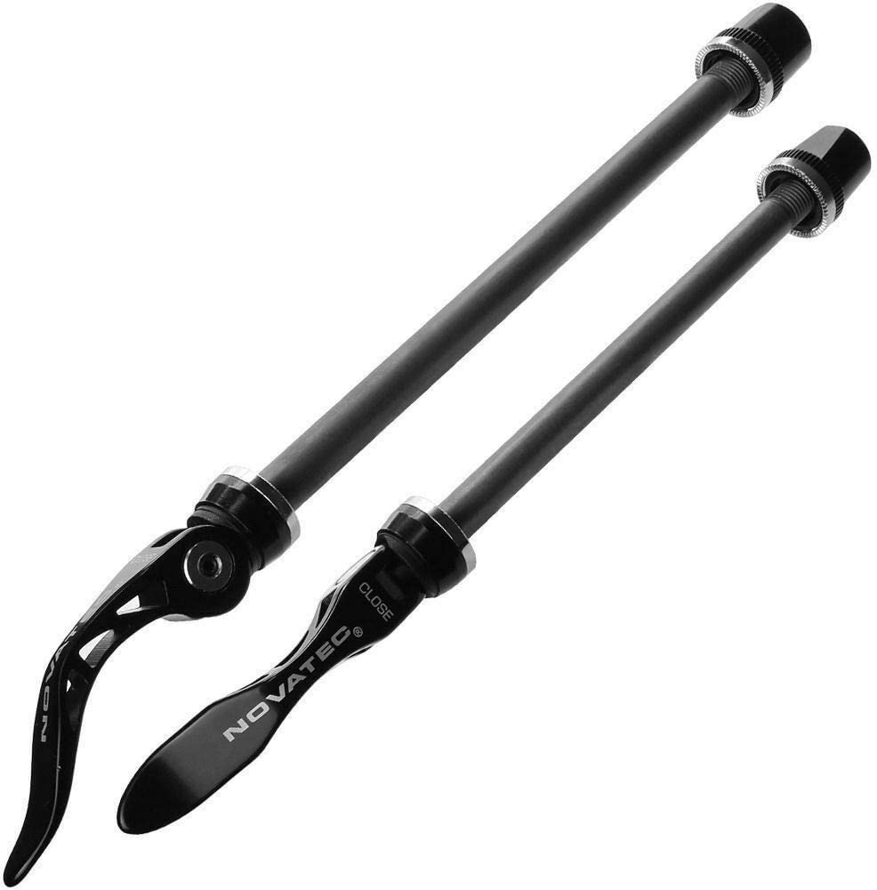

Well since they don't seem to make a longer QR bolt and the threaded rod idea won't allow me to make it QR, I ordered these instead. With this setup I just use my skewer and insert through the tube. Hope it works.

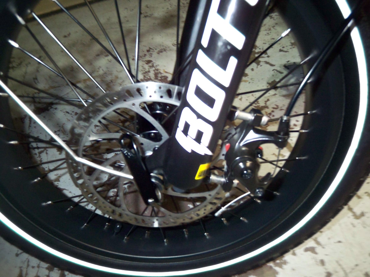

I hope it works for you! I am not certain why the threaded rod will not allow QR? I simply threaded the original QR mechanism directly onto the threaded rod, and my QR works great! I needed the extra length for my new Bolton front end, which was a tad wider than stock, because I had to mount the fender supports somewhere and the Bolton did not have a mounting spot, so I just put them on the axle!. Very simple job!

Thanks, I appreciate it but we are talking two different things here.
