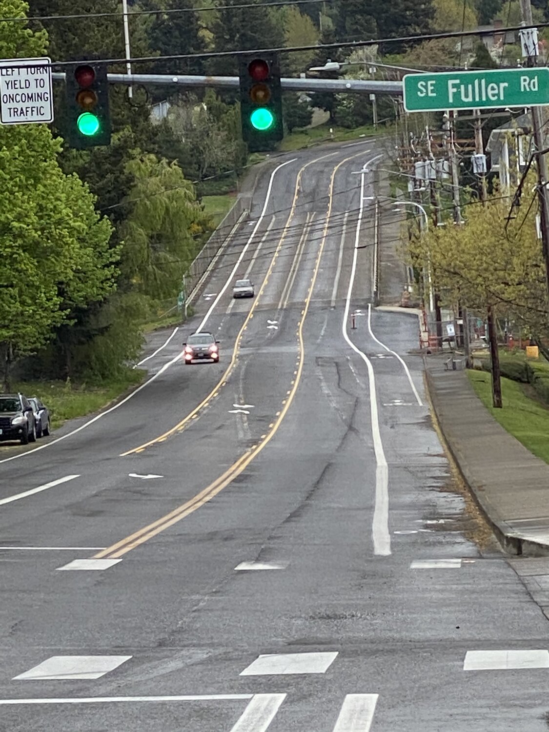

fooferdoggie
Wouldn't know until I tried but it doesn't look as steep as one of the park trails I often ride up. On that one I usually ride up the steeper side to save on the brakes for the decent on the other side.
16% grade. seven on my bosch mid drive your going to have to put out about 200 watts of your own. thats about 20 mph on a road bike.
