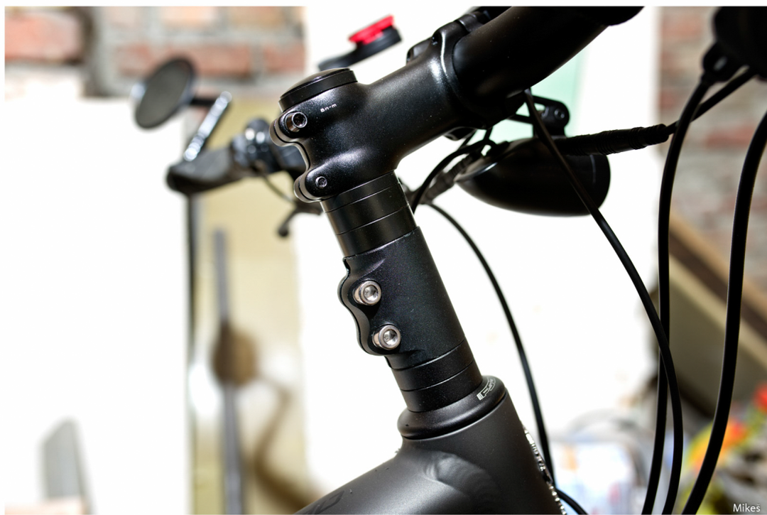

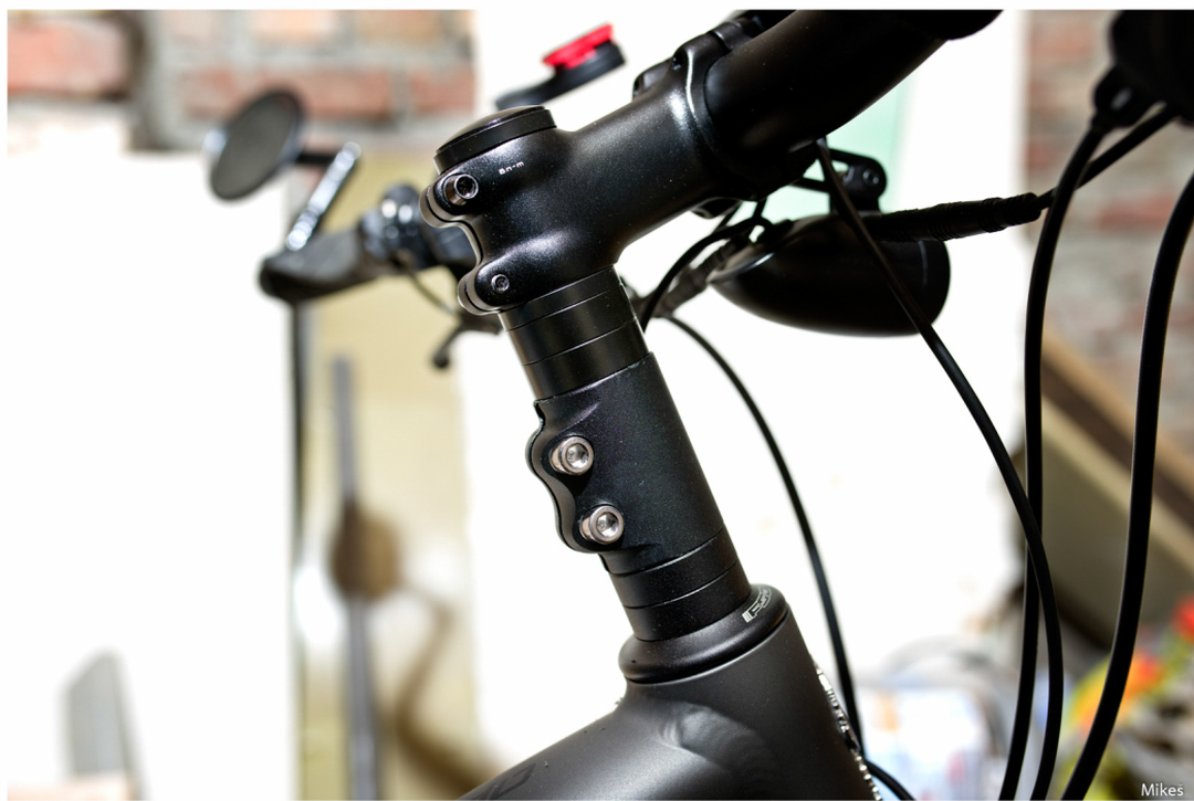

The one and only solution: So called "A-HEAD Stem Riser". It is 3" on my Vado and yes, the cables are long enough. It will change your riding position dramatically. It was the first upgrade I made to my Vado when I bought it.
The A-HEAD Stem Riser is a standard item in the MTB world, for example this one (this one is 3 1/2 inch but I recommend a 3" one):
Or:
Only make sure the nominal diameter matches the diameter of your steerer tube (it should be 1-1/8").

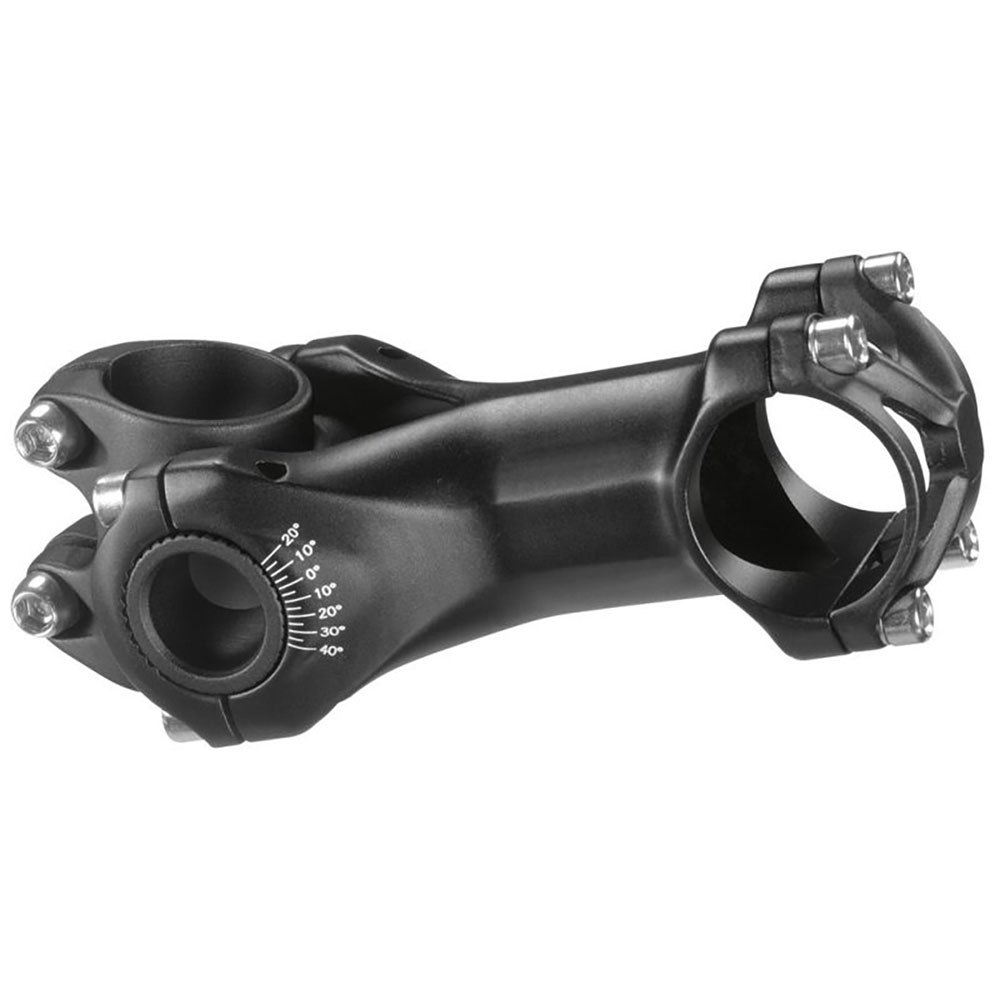

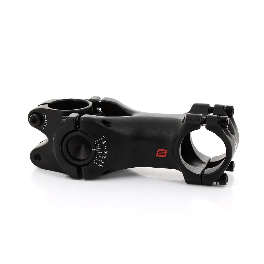

You also might consider an adjustable angle stem. They come in various lengths from 80mm to 140mm

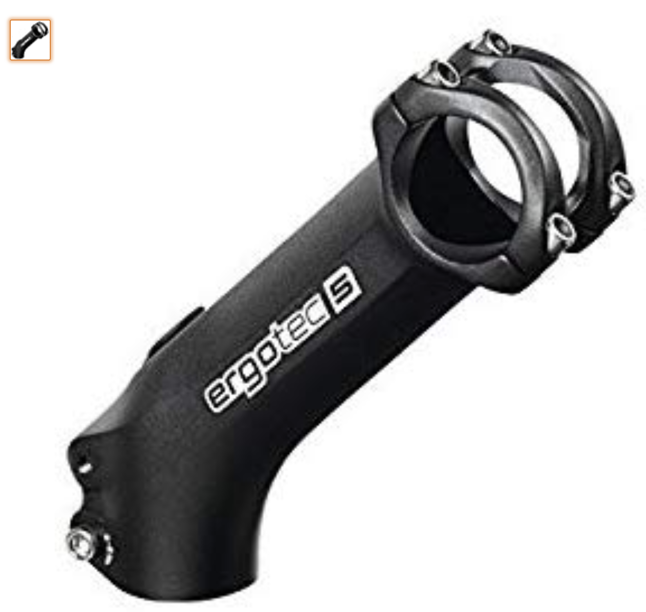

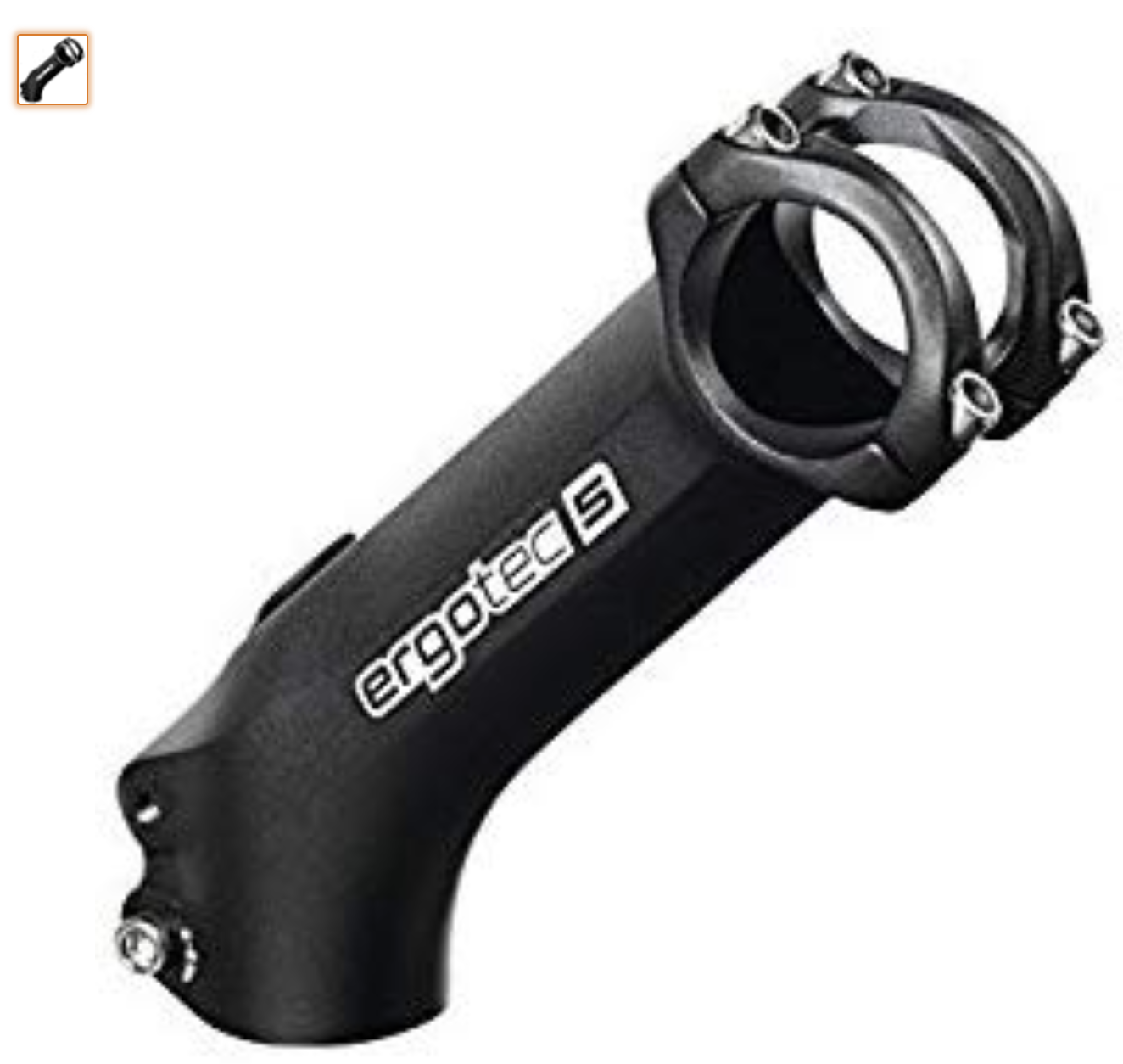

You can also consider a high-angle fixed stem. Ergotec makes an affordable one:
Available via Amazon US from a UK seller for under $40 shipped: https://www.amazon.com/ergotec-High-Charisma-Aluminium-AL6061-T6-Anthracite/dp/B006QSCVK2 for the 110mm version. And even cheaper for a 90mm version: https://www.amazon.com/ergotec-High-Charisma-Aluminium-AL6061-T6-Anthracite/dp/B006QSCVKW
About half the price of the adjustable stem, looks a bit cleaner, plus actually adds more height since the stem extends from above the top of the steerer tube.

I would start with an adjustable angle stem. Rotating it will be less likely to cause cable length problems.

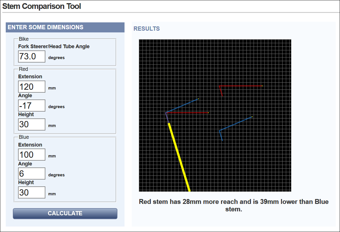

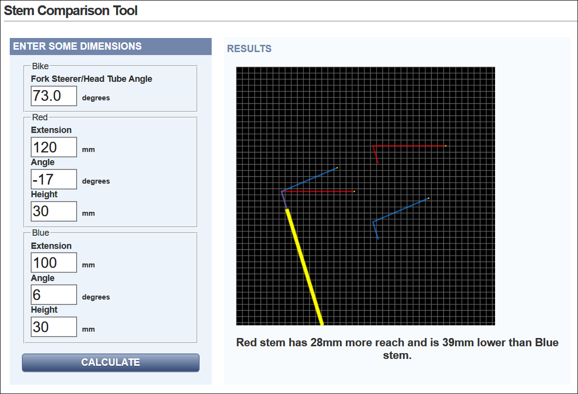

You can experiment with the rise and run on this site:

Guys, you must be aware that the Vado is a 28 mph Speed e-Bike and its geometry was meticulously planned. For that reason I stay on the opinion the an A-HEAD compatible Stem Riser/Extender is the proper and stable solution that will not change the bike's geometry and is safe for the high speed. With 3" extension (but not more), the cables would still have enough slack. Yes it is possible to use another A-HEAD compatible stem but the bike won't be the same.
Here is the rider's position on my Vado with the risen steam (only the frame size is too small for my brother as seen on the picture):

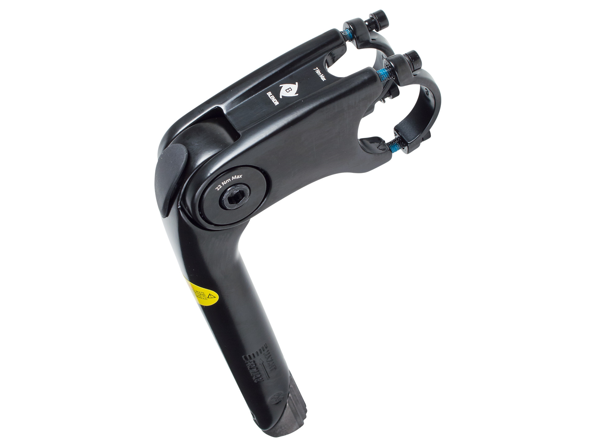

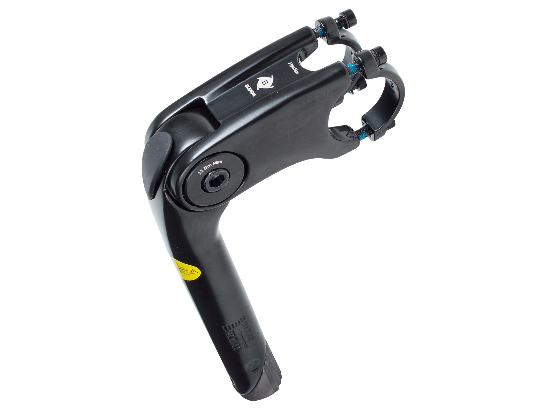

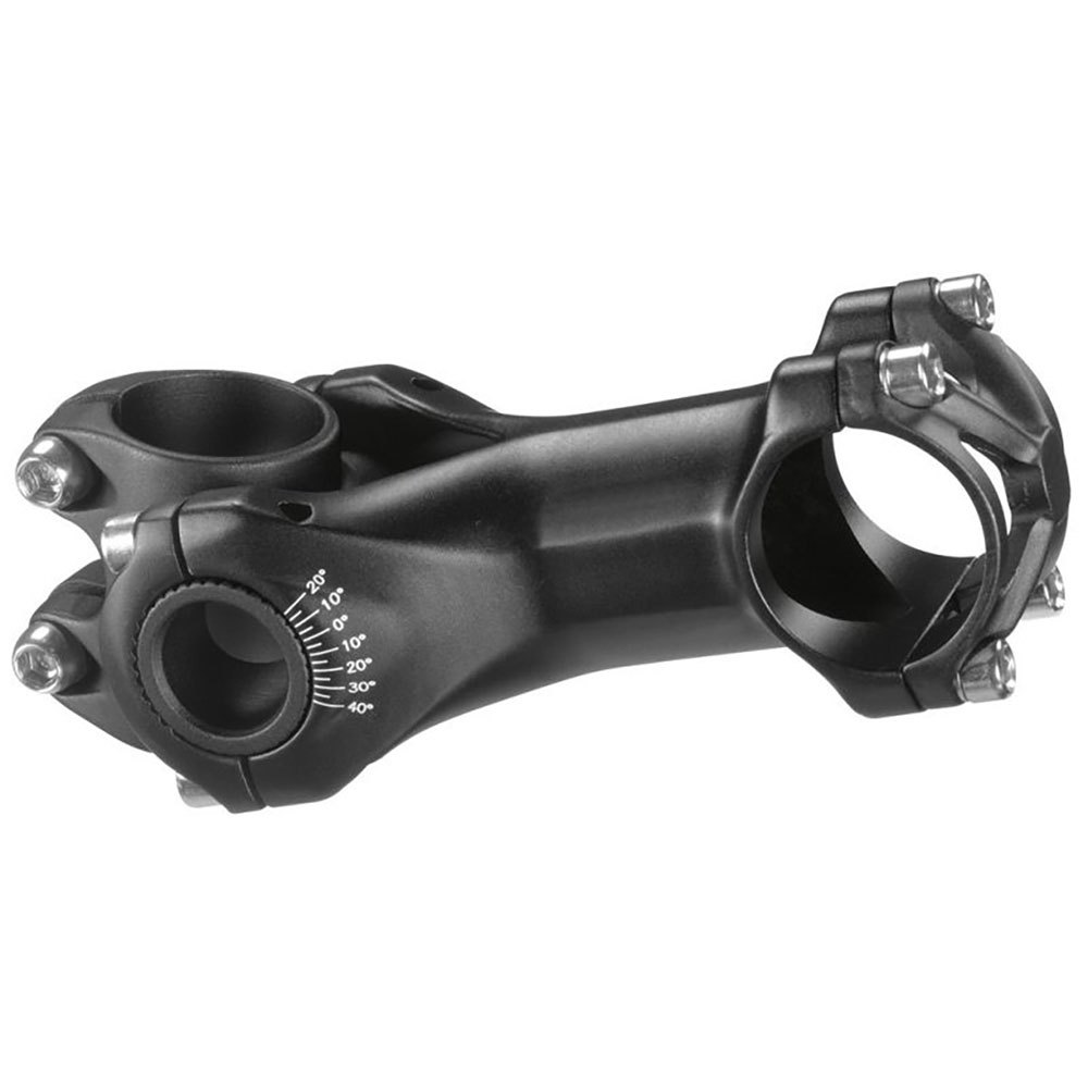

I've had one of these on my Crosstrail (geometry similar to Vado) for almost 10 years of hard use and it has worked perfectly for me -- never loosened or failed in any way. Of course, if you need several inches of rise it's not really suitable for that.
Just a note that this online comparison tool assumes your stems are built like this:
whereas the one I referenced is this:
Thus, the stem comparison tool won't work for these two.
As for adjustable stems, the one @Alaskan referenced is among the highest quality versions out there and would likely hold up to all but aggressive singletrack jumping use.
