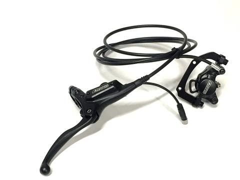

the sensor looks like this.

It's typically attached to brake like this.
Make sure to unscrew the very small screw UNDER the lever first, before unscrewing the sensor itself.
