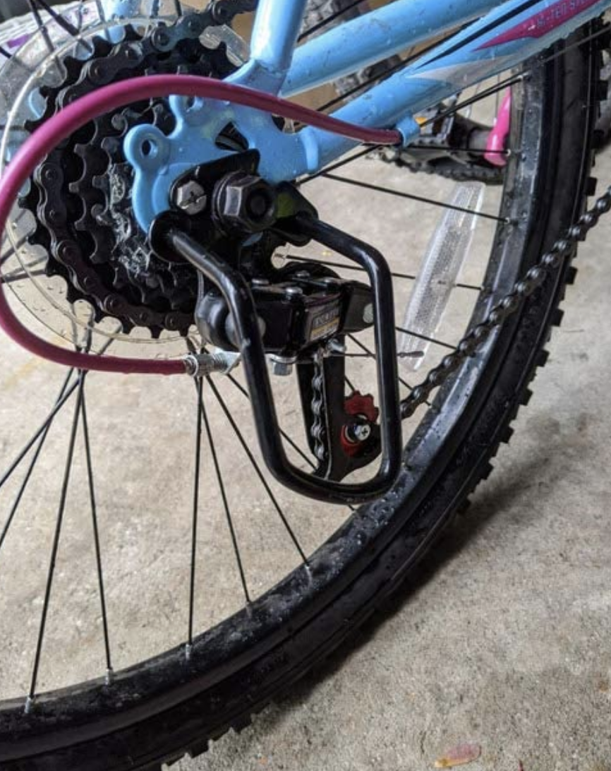

You might try a derailleur guard? It should mount no problem to the non drive side and they are pretty cheap.

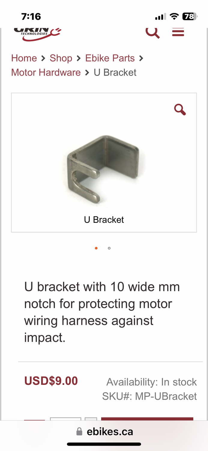

Grin had a steel guard. Basically a U
shape slotted for the axle and protection for the wire. These days better motors no longer have wiring out of the axle. Pretty easy to fabricate.
