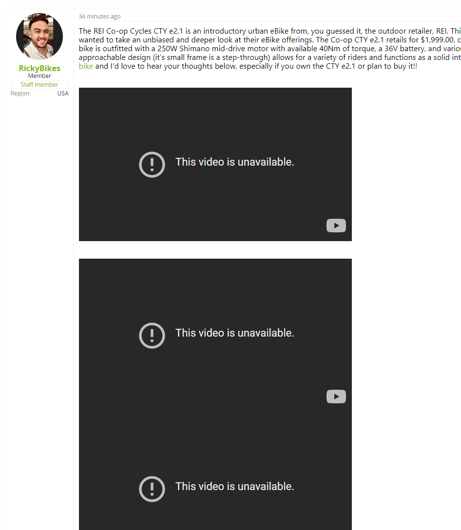

For some reason, I can't see the videos!
