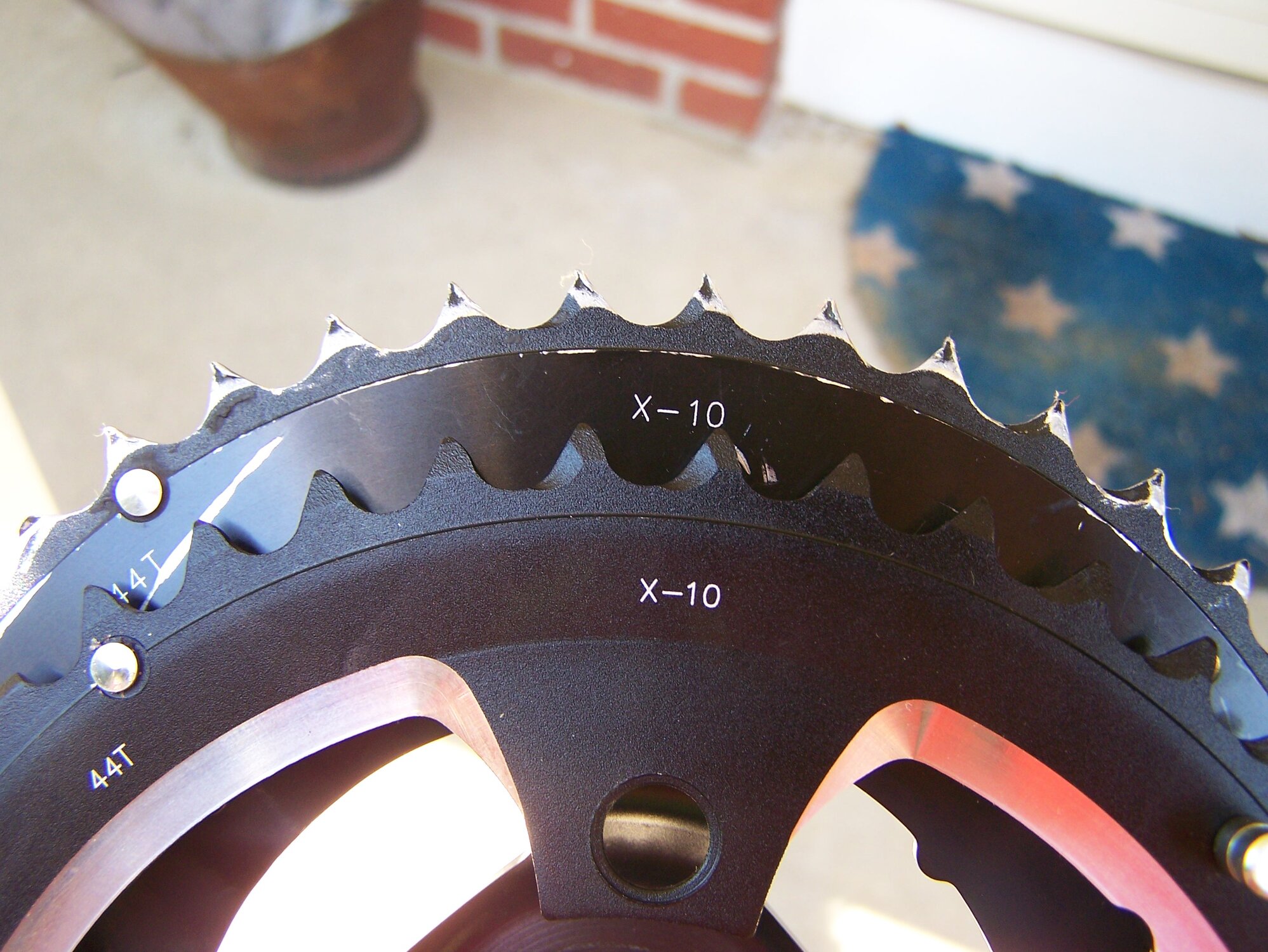

Part ways true. The first indicator for a worn chain is checking for chain stretch with the appropriate tool. I did not do this. And at 11,000 miles (17,703km), I got very familiar with the chain coming off the front chain ring when applying light pedal pressure in taking off, pedaling. My issue was very clear once I really took a look at the front chain ring teeth. The photo attached will show you what happens when you ride long term on a stretched chain (with an aluminum front chain ring); it will wear the front chainring teeth down to the point where the chain ring becomes a weapon that requires registering with local law enforcement.... 🤣
Spot on about having a light touch on the pedals, thus easing wear on the drive train. This is my philosophy as well. I'm constantly shifting to ease the tension on the drive train. A nice offshoot to this is extended battery range on your ride. The bulk of my own miles are on asphalt.
I'm constantly relubing my chain links. Frequency: about every other ride. This time also allows me to do a good look over of the bike to catch anything developing; ie, a loose bolt here or there.....
Original FSA front chain ring in the background, brand new one used as comparison to show teeth wear. Caused by excessive chain stretch (not replacing chain for 11,000 miles). Lubed religously for every other ride; my chain lube of choice was first Boeshield T-10 and later, Dupont Chain Saver Lube.
man thats some wear. on my bosch 18t chainring i could not see any wear but it was rumbling and jammed twice at almost 12k. but sicne its a geared drive thats about 30,000 miles but is also hardened steel.

Why front chain rings in most applications aren't forged steel is beyond me.
