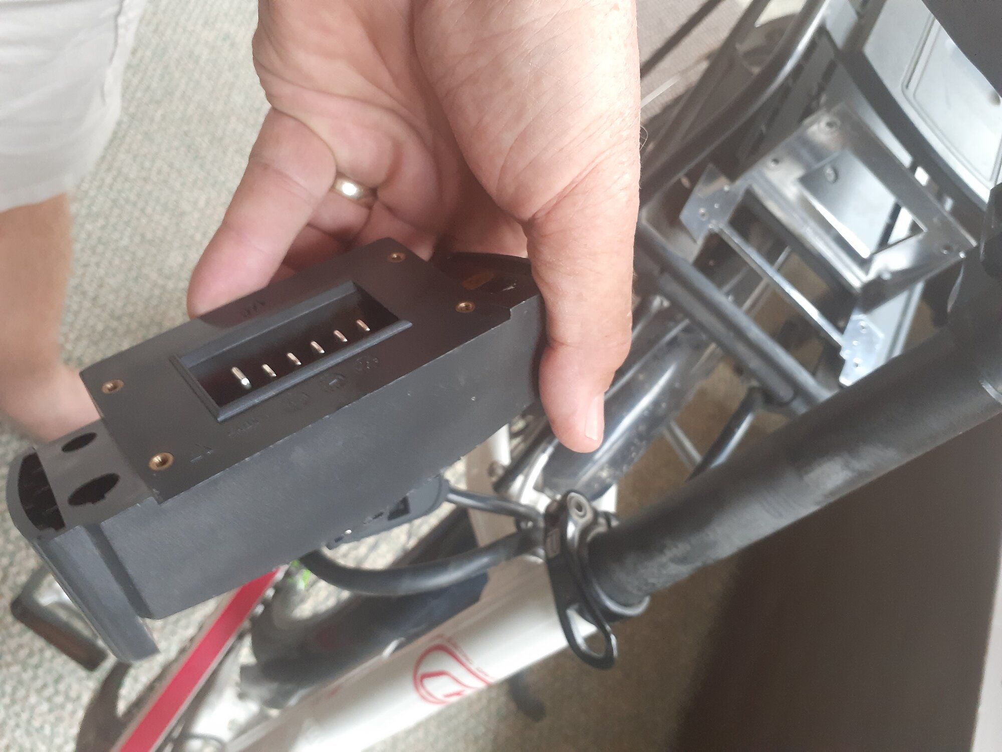

I bought a currie izip 3 path Plus with no battery. I have a 48 volt generic battery but there are six pins original plugged into control box and I need to know which ones are positive and negative I don't care about the stock look just don't want to pay $600 for a new battery

I'll attach a picture, I can wire it up I just need to know which of the six pins are positive and negative.

Okay so, don't worry about those 6 pins. You won't be using it, you will be replacing it anyways.
The new battery that you're showing has XT60 connector, does your controller have XT60 connector?
In addition, if you get that kind of new battery, you don't be able to slide it in like you can right now.. because you will be losing the battery cradle. (or rear rack battery case)

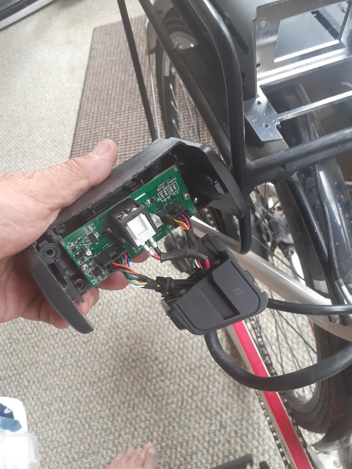

The battery I got from a supplier California he sends them in about seven days. I used him about 6 times on batteries and they all work fine so far. But I'm open-minded on whatever it takes. I tried connecting my battery to the red and black, but it bypasses the circuit board and nothing works....now I actually forgot which plug was in left side or right????? I think the positive was on left side....a little knowledge is dangerous. Lol.
I have done this on other bikes but the controller was separate. I know I have to modify rack also but that is not a problem . I just need to get power to existing system????

I wonder if I left the red nd black leads plugged into circuit board and just spliced into them with my battery wires. That might conduct power to rest of circuit board. You can see if you unplugged them it becomes divorced from circuit board...

That was unexpected.
I was asking Eunorau (they also sell on AliExpress) and they said that the compartment will hold the controller.
So when you opened the box, I was expecting to see something like this
I guess the options would be..
1) replace controller, battery and whatever else needs to be replaced.
2) send it to battery rebuilder https://ebikemarketplace.com/products/currie-i-zip-e-bike-battery-replacement
3) buy a stock battery
sorry at this point I'm not really being much of a help :confused:

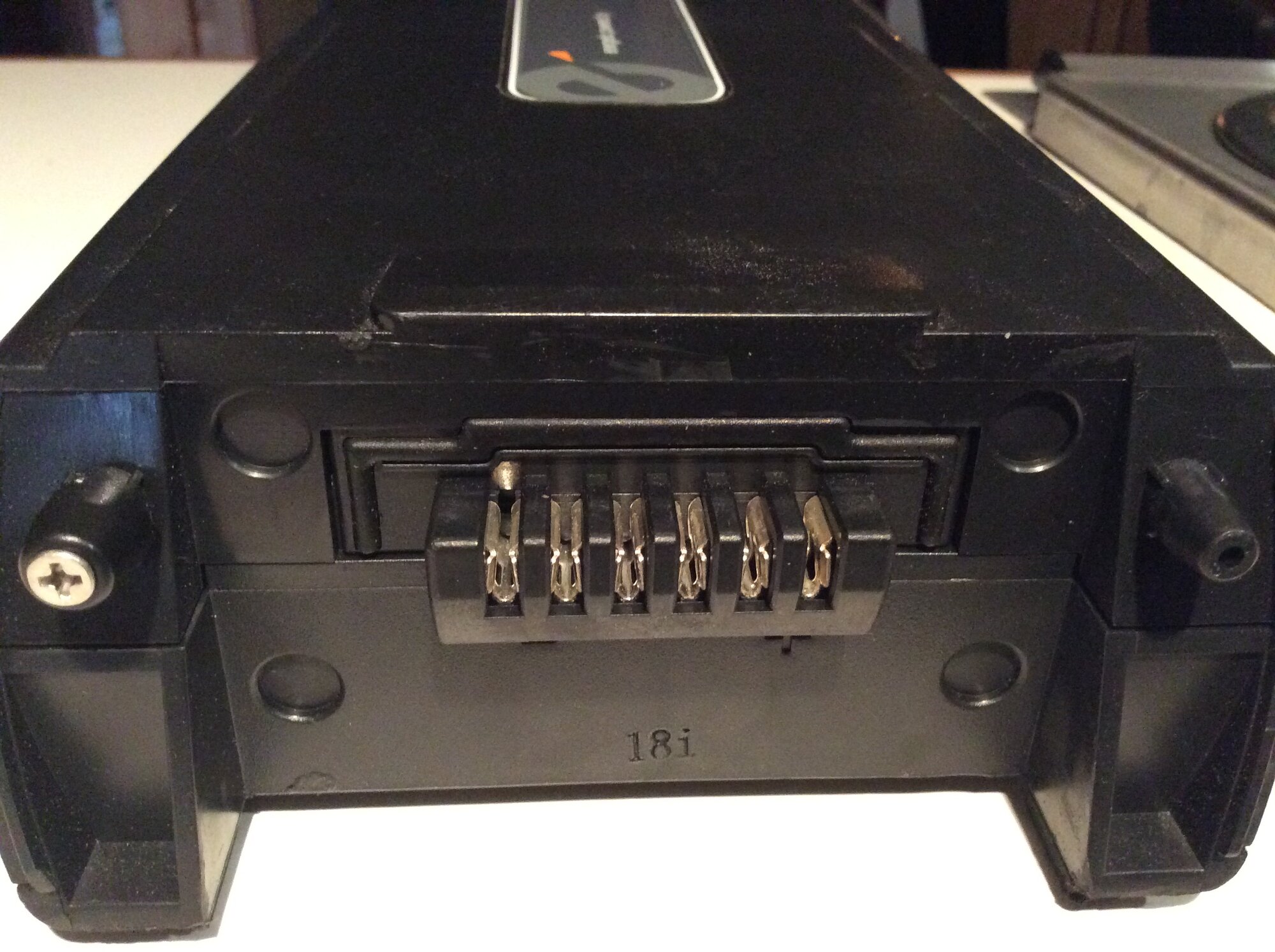

This is the stock battery. In the picture, the lug on the far right is positive and the larger far left lug is negative.
indiobill
Wow...my hero....that should help.
I attach the negative and positive on the opposite side to my battery and I got display screen. I can run through the options. But no power to the motor even when I pedaled. So i spliced in and plugged 3 negative and three positive wires to my battery and just got the display screen again and no power to my motor. I'm kind of stuck right now anybody out there got some ideas I'd appreciate it thank you
