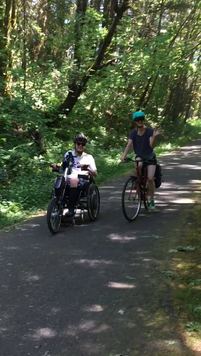

My son is a quad and we got this for him last year from Davinci Mobility. The power source is an EU spec Bafang BBS01.
He loves it as his girlfriend can barely keep up!
Disabilities are all over the map so it really depends on what your goal is.
Hub motors are cheap and might work for a lot of people.
