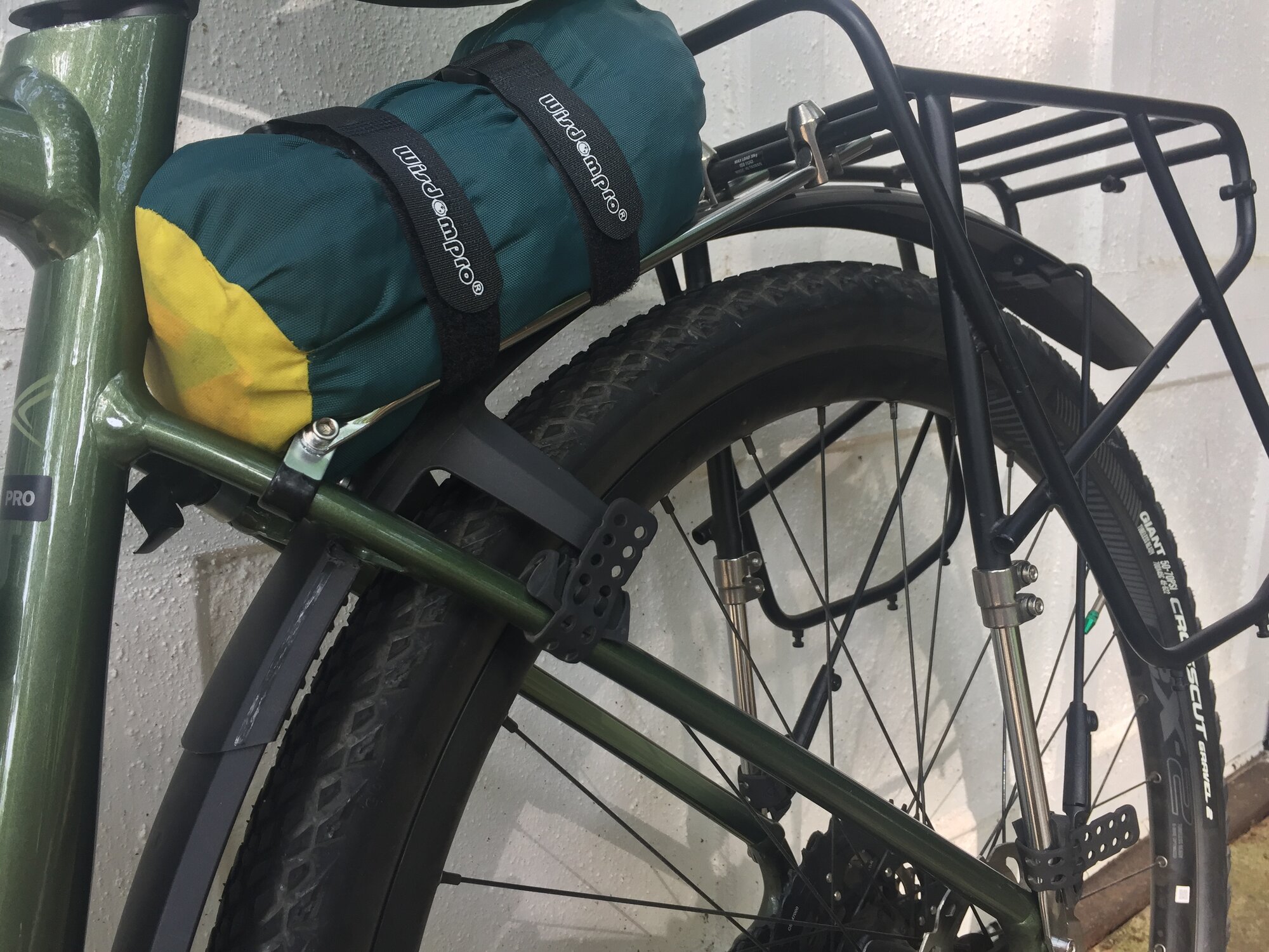

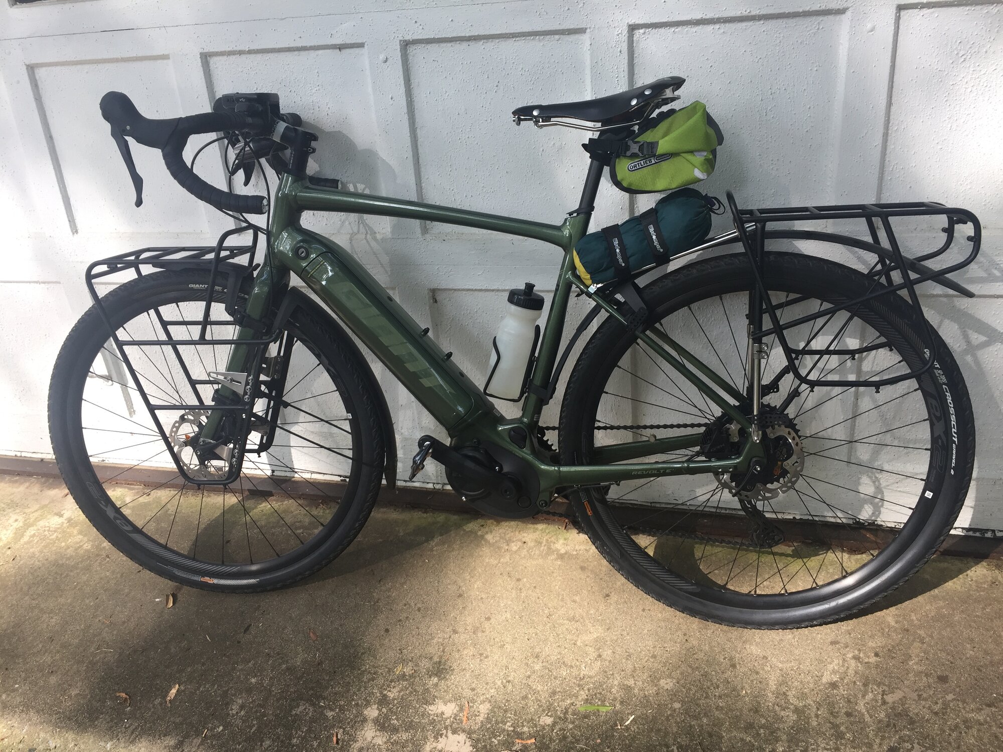

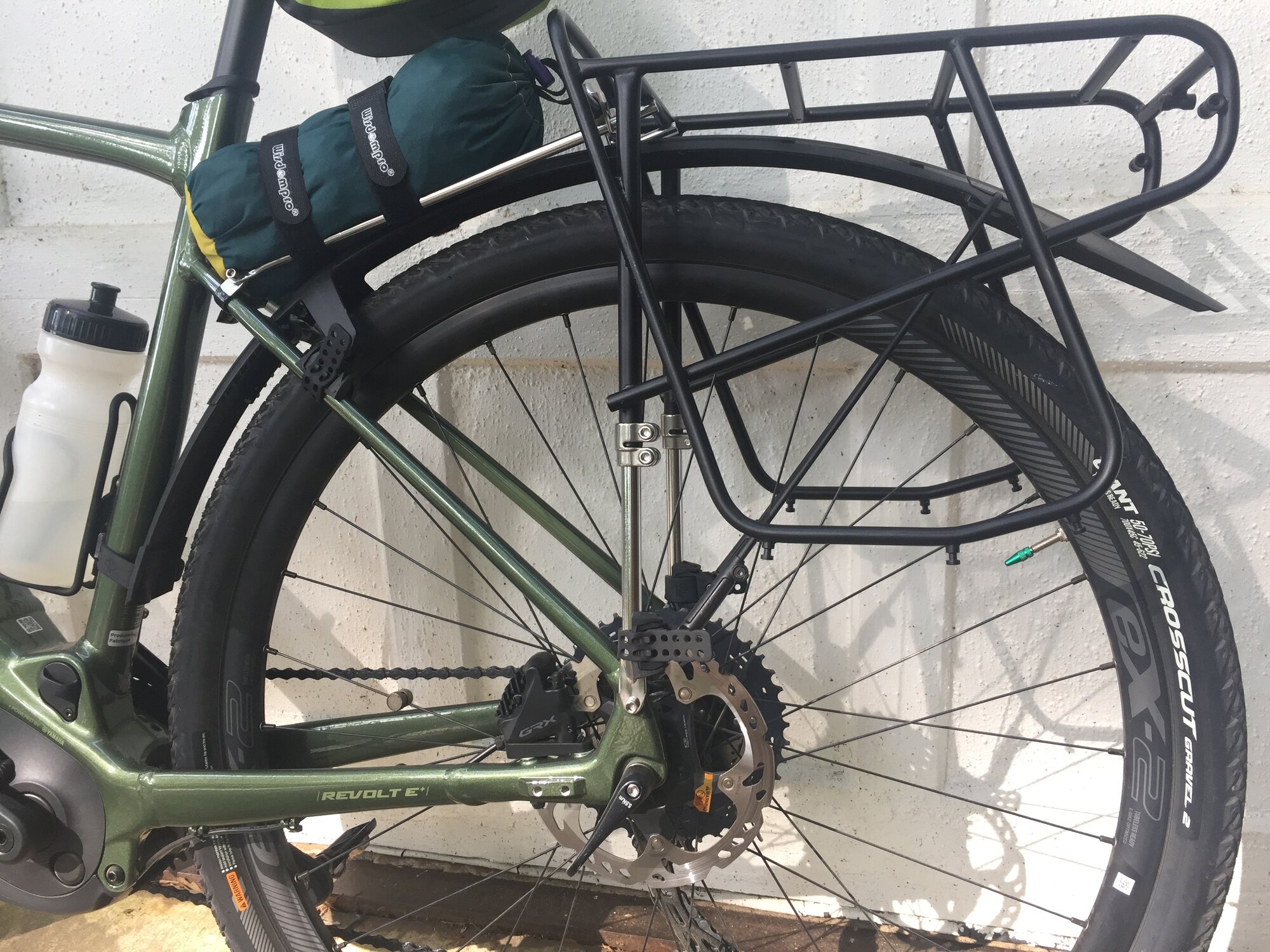

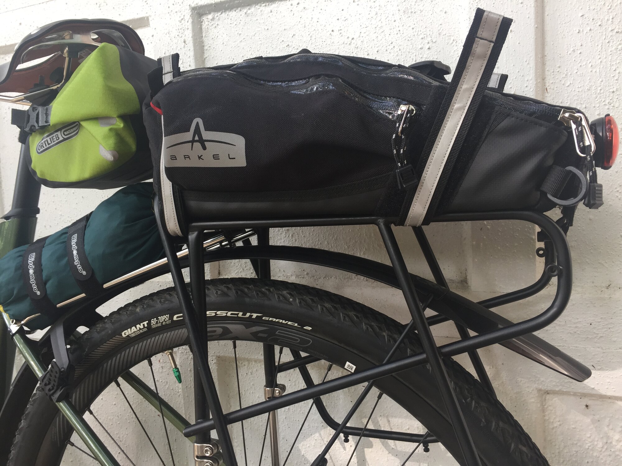

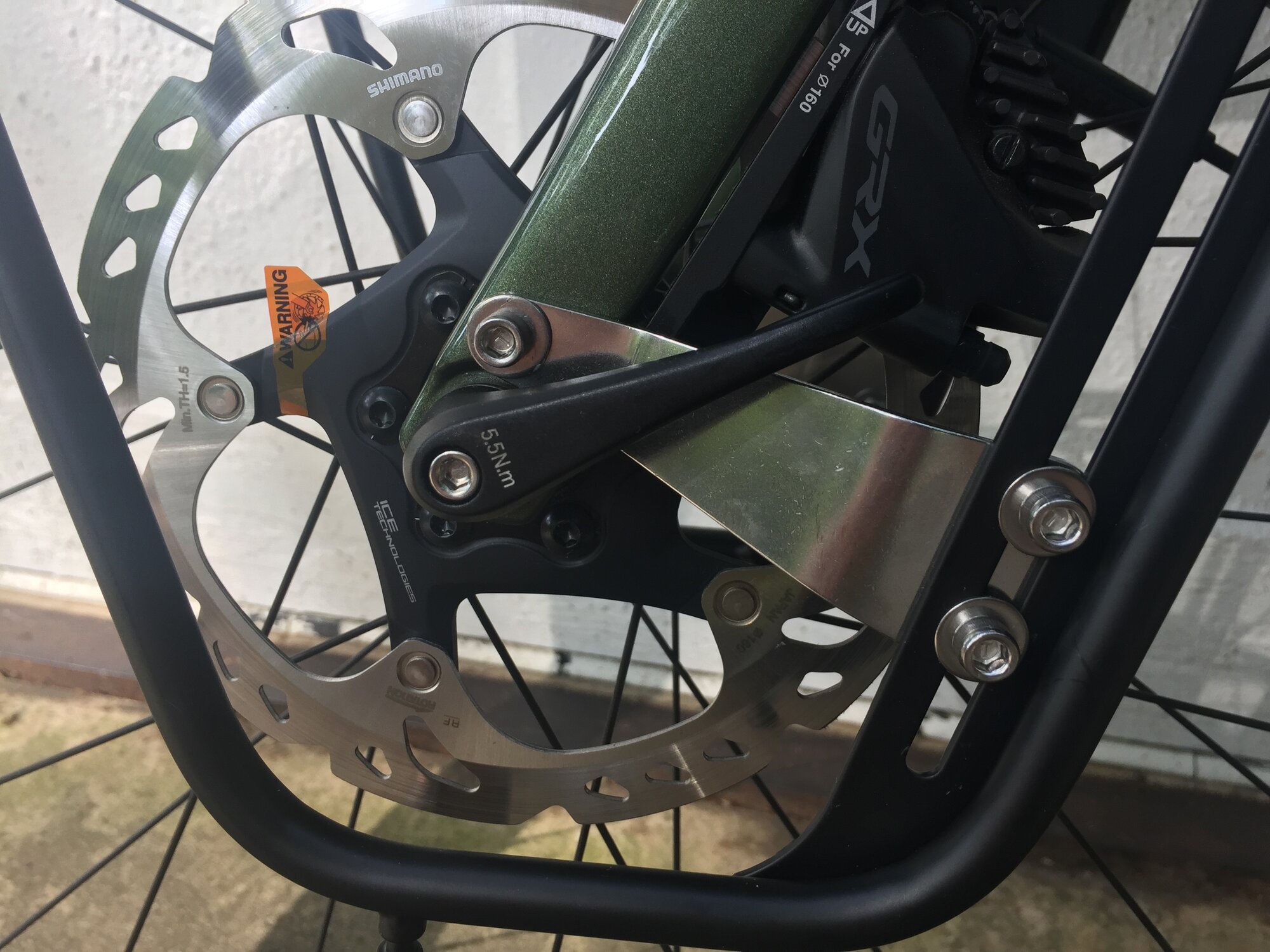

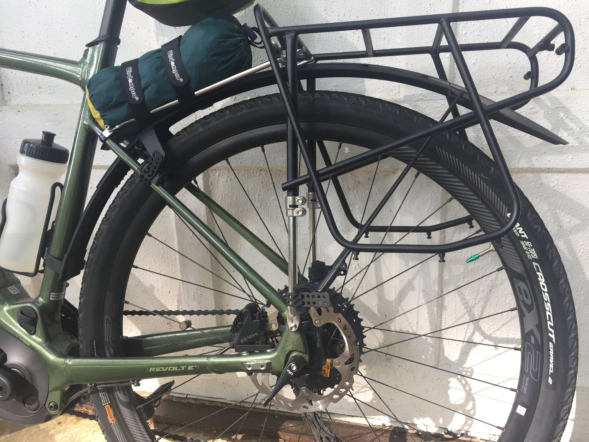

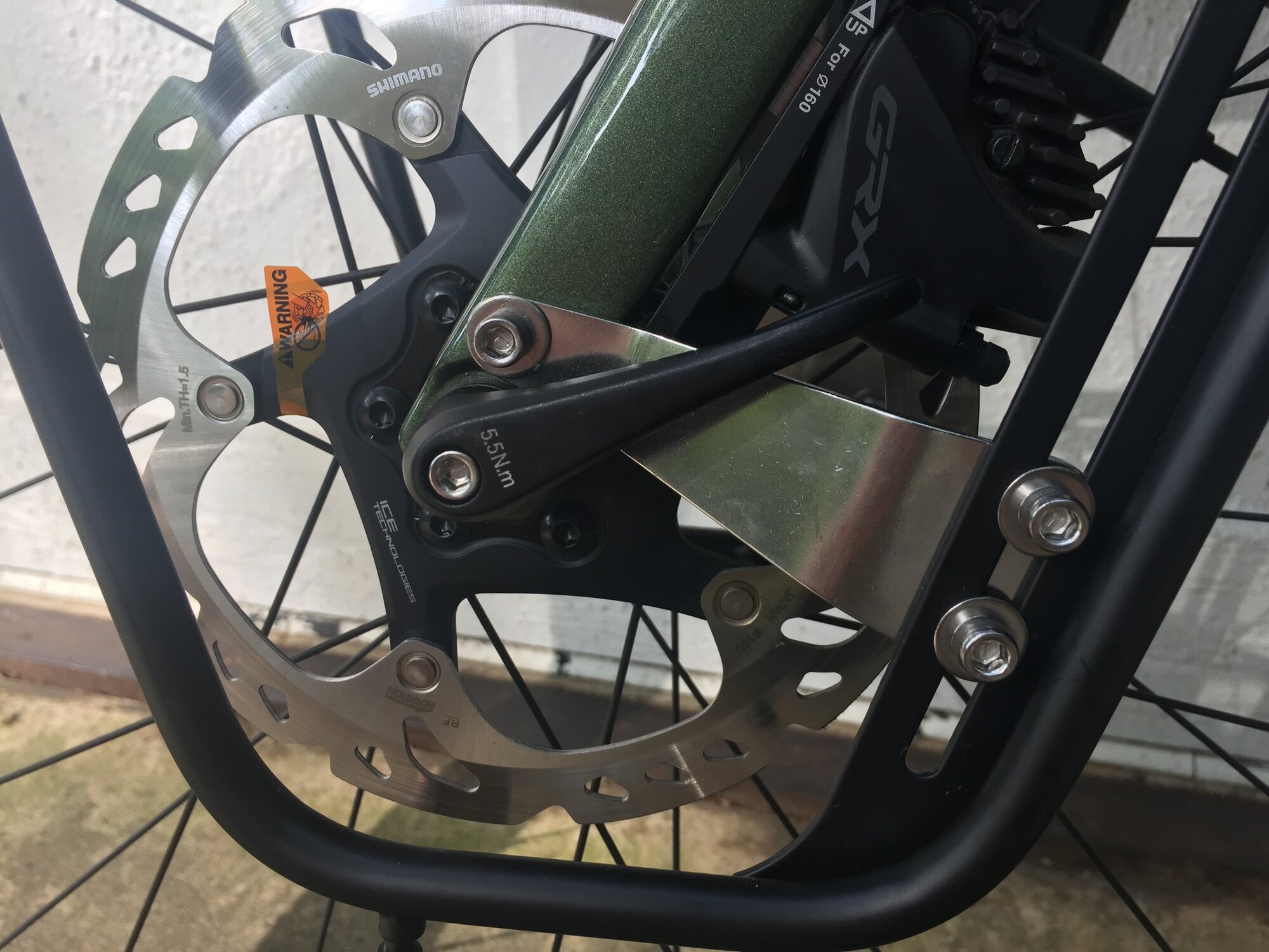

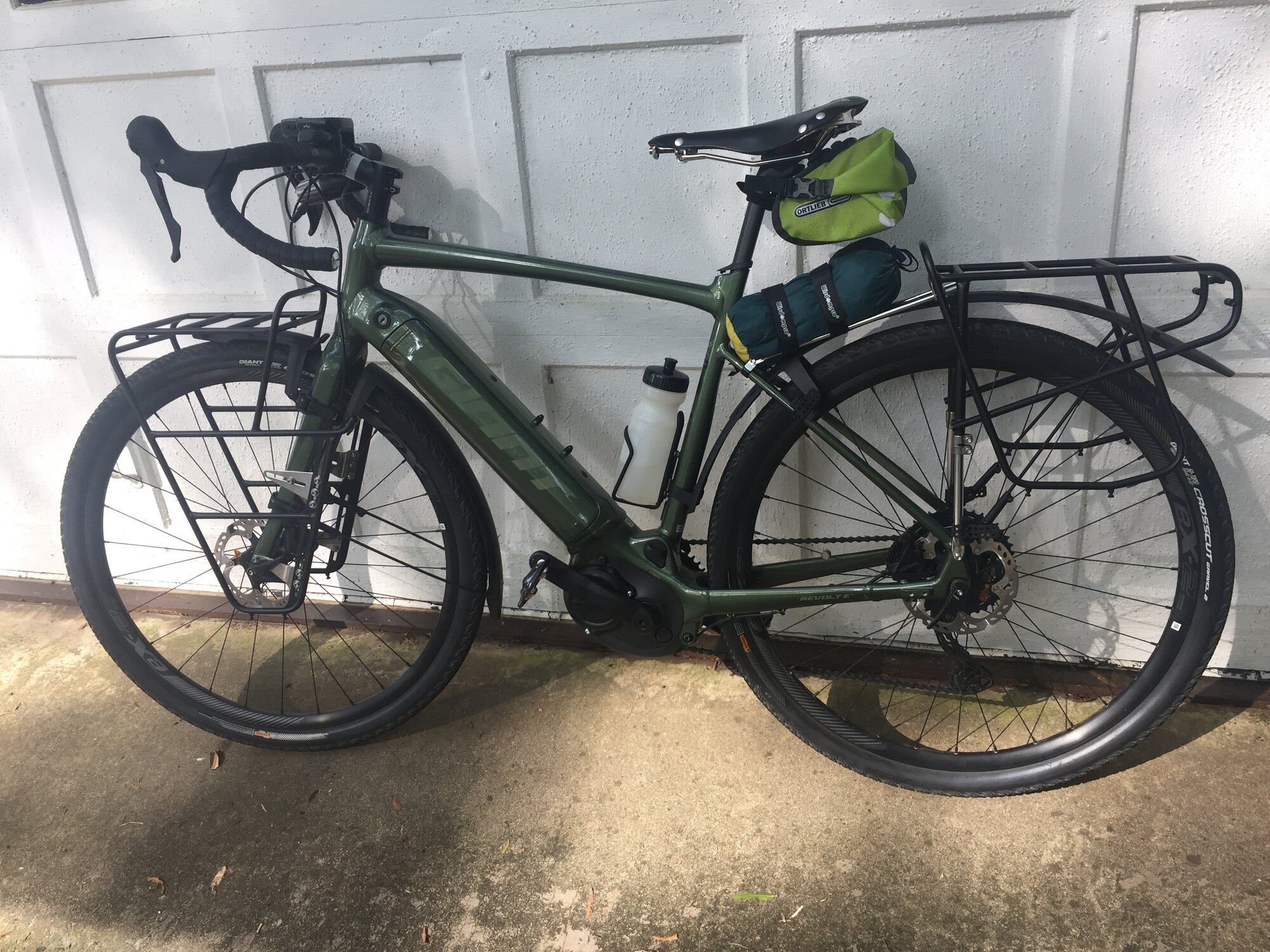

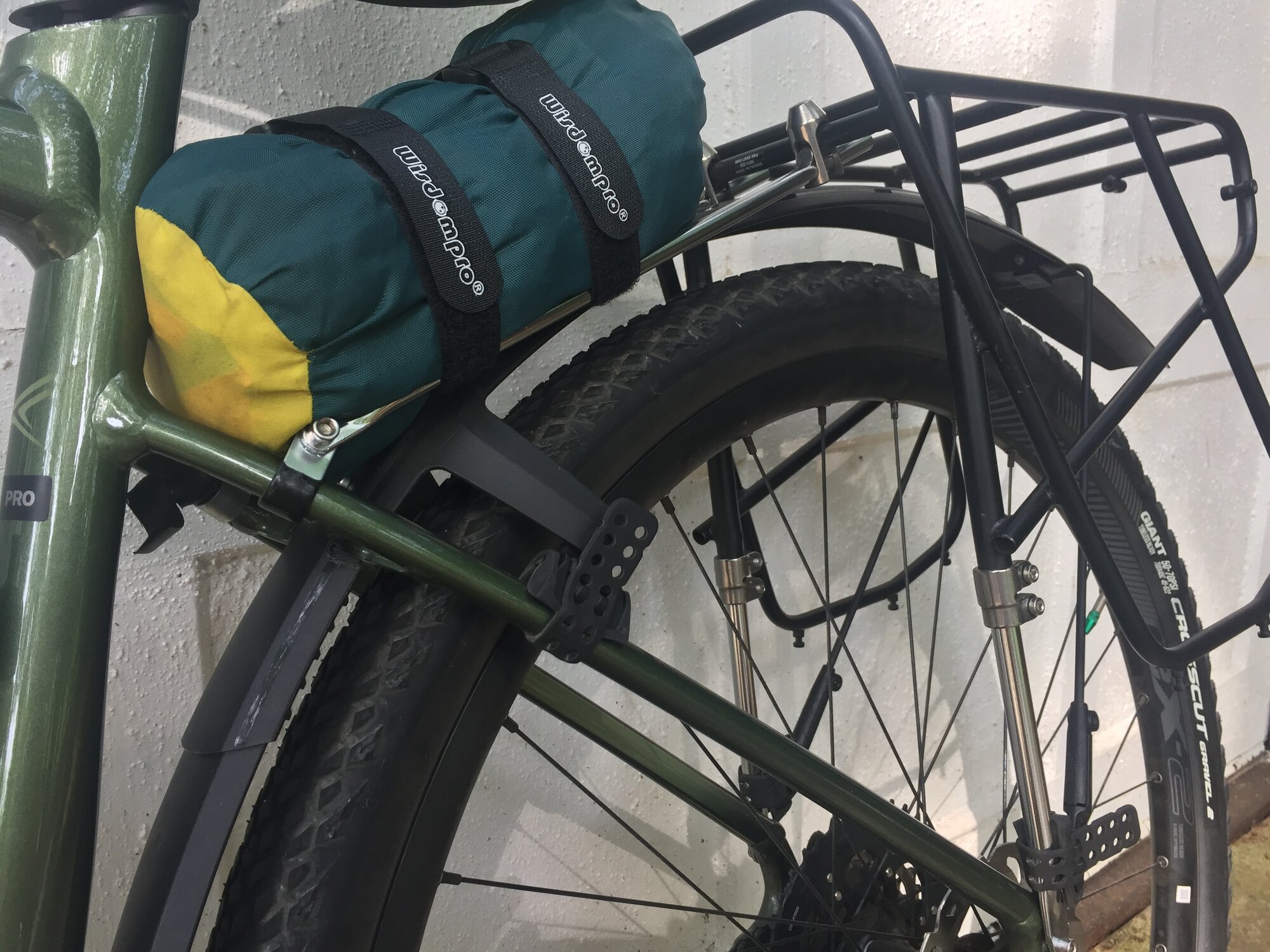

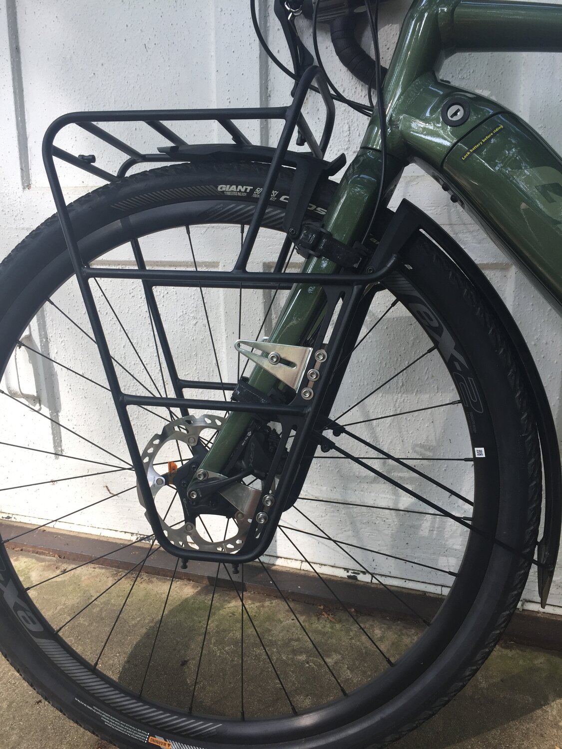

Thought folks might be interested in my Revolt E+ Pro rack and fender setup. Because there are few eyelets and no fork crown hole, I used SKS Speedrocker Fenders which velcro to the fork and stays. The mounting is surprisingly stable. The racks are Surly and go on really nicely. Had to use P-clamps on the seat-stays but there were threaded mounting holes everywhere else. The long rack seat-stay rods enabled me to strap my Showers Pass GoreTex stuffsack there and still mount the Arkel Tailrider bag. That bag is just barely (with some effort) long enough to hold an extra battery. Only operational problem is that the front wheel skewer lever won't clear the rack mounting bracket, so I'll have to loosen the skewer, then remove the lever (allen bolt comes right out) and unscrew the skewer by hand to take the wheel off. But that's not a big problem, and I could just leave the lever off and then get it out and use it as a wrench to remove the wheel. In the end, I've got a well-equipped bike for loaded touring, and my Ortlieb panniers fit beautifully on the racks. IMG_2986.jpgIMG_2987.jpgIMG_2988.jpgIMG_2989.jpgIMG_2993.jpgIMG_2994.jpg

What size p-clamps did you use on seatstays? Thanks

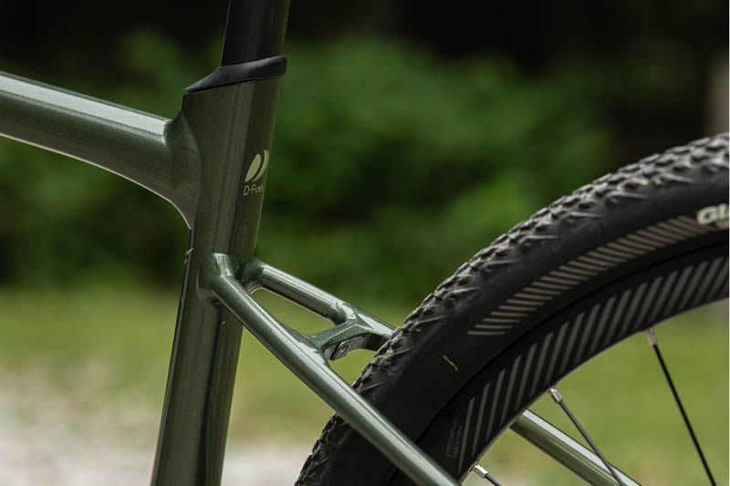

How did you mount the fender bridge mount to the seatstay bridge? The mount on a bike is usually quarter turned from where it is on the Revolt. Thanks!
drewberz
Thanks for the info. I have Bluemels on my Haibike and like them, but they had to be customized for the bike, so I need a new set.
I drilled out the L bracket and put a bolt through it to the bridge. Holding up fine!
