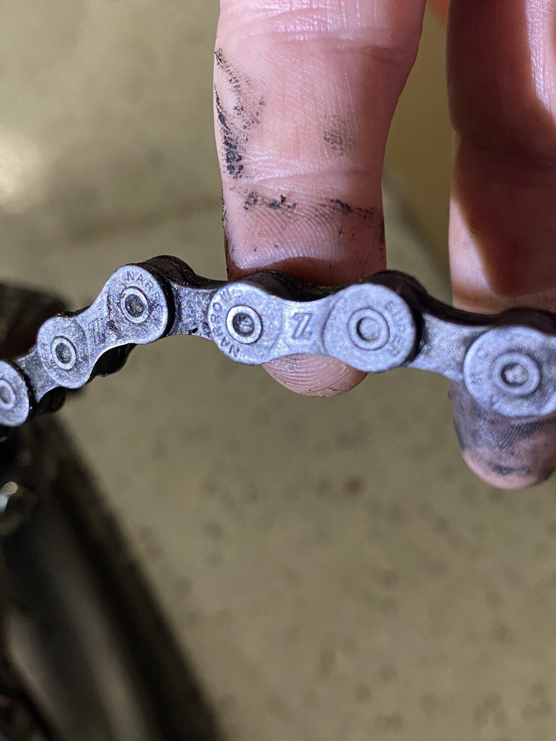

I am trying to identify the Ripcurrent S chain part number from KMC. My chain is 128 links. I think I may have to custom make the length. Does any know an Amazon link to a replacement chain?
IOUZIP
Tampa
Called and Juiced is out of stock on the replacement chains. I cannot find the KMC K99 BR (Rust Buster) 128 link chain anywhere online.
IOUZIP
Tampa
I kinda started to feel like I needed 2 Z99 RB 116 link chains and just make one longer. Is the stock chain 1/2" x 11/128" ??
I looked at the chain closer and found the markings Z and KMC on one side then on the other I found Super Narrow.
Update: After research I am going to get the KMC e9 EPT 1/2" x 11/128" (narrow) 136 links. I will shorten it down when I install it.
