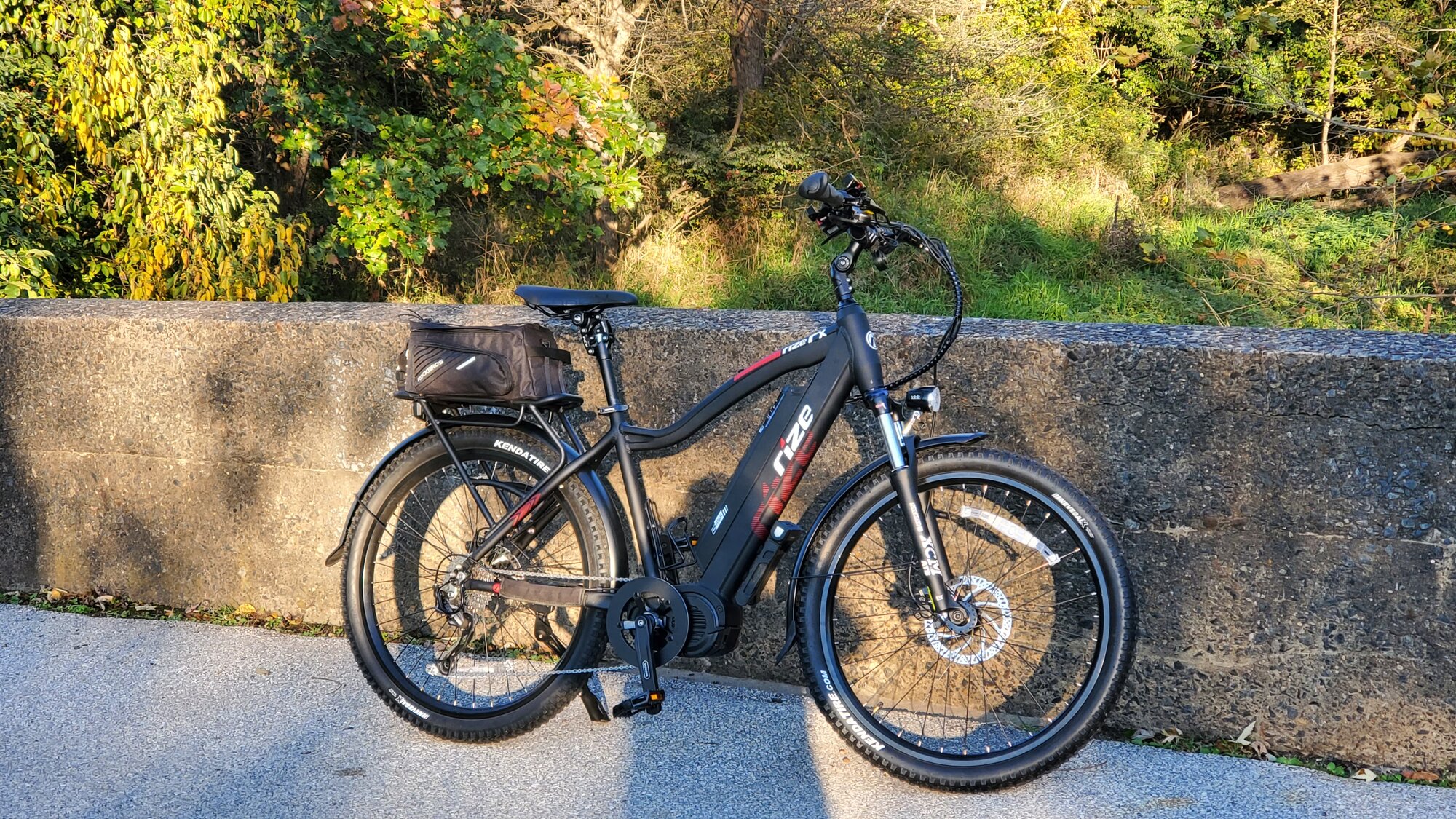

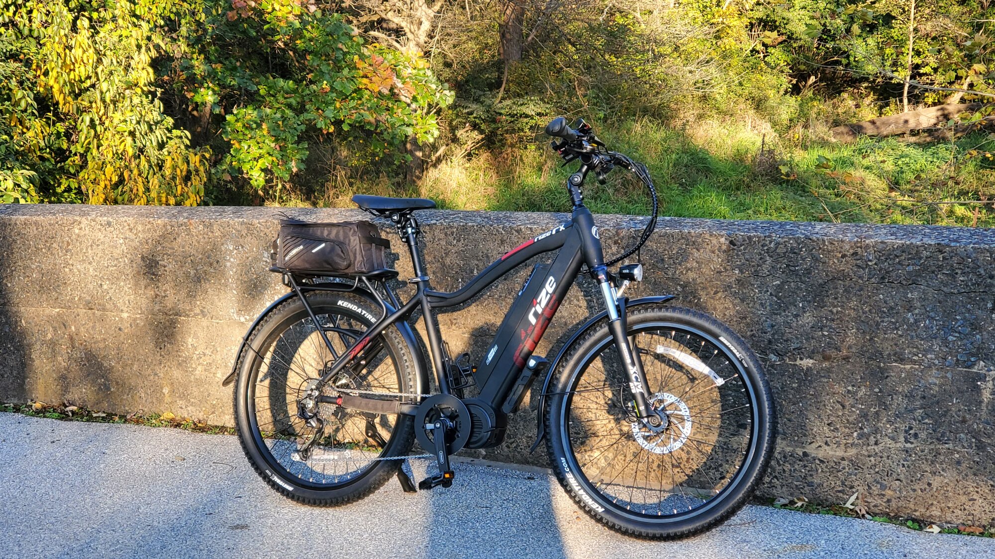

Hello fellow Rize owners.
A week into my new RX and here are some hits and misses for the bike, components and accessories. Overall very pleased, bike is a blast and feels solid on the road and handles well with good-to-great power. At this short point in time, I am very pleased with the purchase and would recommend this bike to anyone.
Hit’s for the Bike –
  • Build quality – While I am not an expert, I have looked at a LOT of bikes in local bike shops (LBS) and online. The welds are good, frame is solid nothing squeaks or rattles.
  • Components – I am coming from a 25 year old Schwinn, so for me the shifters, derailers, brakes…etc are all working very well and feel solid. Brakes have good stopping power without noise. (I did bed the brakes and too great care to keep them clean from oils).
  • Lights - The headlight and brake, really like the brake lights coming on when I brake, are working well but I have not ridden after full dark so I don’t know about the headlight power.
  • Powertrain – The Bafang mid-drive is strong and powerful. I personally like the 5-level pedal assist and it works for me in my daily driving thus far. It can always get me up to a speed I am not fully comfortable with or even need honestly just commuting around the area. (31mph+ easily on the flats with fresh battery) I do use the throttle a bit too much as it is just soo much fun. The engine makes a small bit of noise, but not too much.
  • Packaging and build experience – For me, the box arrived in good shape and everything was well protected. Other than a few mild scuffs, the paint is in good condition. Building the bike took about 2 hours, but I could have rushed and done it in 60 minutes. Handlebars, seat, wheel all went on without a hitch. I might have been lucky, but the brakes and shifter/derailer were all pretty close to spot-on out of the box.
  • Cable management – Between the brakes, throttle, shifter, Bafang display and lights, there are a fair number of wires all over the front of the bike but for the most part they all quickly tuck into the frame, have good cable protectors/cable management wraps and never seem to get in the way of my hands or vehicle operation. The cables pop-back out of the frame near where they need to get the job done and again seem to be decent craftmanship.
  • Front fork/shock – I realize this isn’t a top-end front fork but for me its doing a good job of absorbing the bumps and keeps the tire firmly planted.
Misses for the Bike – (all IMHO)
  • Instructions were OK- given you have to put together a few of these items, I would appreciate better instructions, details on where/how to grease and what to maintain as well as how to adjust the derailer. (I will just use the great Park tools videos)
  • Bafang display – Bright and easy to see but that 24 hour clock. Come on man!
  • Sport -vs- Eco mode – Difference is so very negligible as to be useless. I forgot about the sport mode for a few days and then thought, oh shoot – I gotta try this. Imagine my disappointment when it wasn’t really much of difference at all.
  • Tire noise – I like quiet – The tires started out pretty quiet, but after just 70 miles they are getting louder or I am getting more sensitive. I like a smooth, quiet, powerful bike. Right now, only 2 of those 3 are working.
  • Hydraulic seat – Just not doing too much for me. Hardly even feel like it is smoothing out anything.
  • Cockpit layout – Not a huge fan. The layout feels a bit cramped (large hands) and the bell is on top of the shifter. It is not easy for me to shift up in gears. I will need to re-do this at some point and perhaps move the bell.
  • Battery – Seems like we are burning thru the battery pretty quick. Yes, I am hitting the throttle a bit, but right now the battery is not lasting as long as I would suspect it should. More on this later as my 'joy' with the throttle settles down a bit and I try a few long rides.
  • Battery charger port – This is a nit, but why is the battery plug on the bottom of the battery and very low to the ground. Pain in the you know what.
Now, a few accessory notes.
  • Rize bottle hold – IMHO – Miss – This thing sucked.
  • My quad-lock iphone bike mount and case – Hit – Love that thing, fits nice to the left of the Bafang display and is very solid. Not worries about the phone getting loose.
  • Topeak Trunkbag DXP – Hit – The versatility of this is huge. Can even fit my tennis racquets in the pannier.
  • Rize fenders – Hit – I like them, they appear fairly lightweight, fit close to the tires and cover what appears to be the right areas.
  • Rize battery charger – feels and acts like a miss – Seems a bit cheap, not sure this will contribute to long-healthy battery life.
  • Rize Bike Grips – Hit – Very comfortable
  • Rize Seat – Undecided. I have not rode enough to offer opinion and I am too far out of practice to say it’s the seats fault I am sore.
  • My jeep-top-lift that doubles as a bike lift – Hit – Love that Harken Hoister – Only takes 20 seconds to utilize the straps to lift the bike to any height I desire.
  • Kryptonite bike lock – Hit – about 5 foot and not too heavy. Simple and effective and has worked well in 4 different situations.
FWIW - Black Rize RX - Not the pro model.
