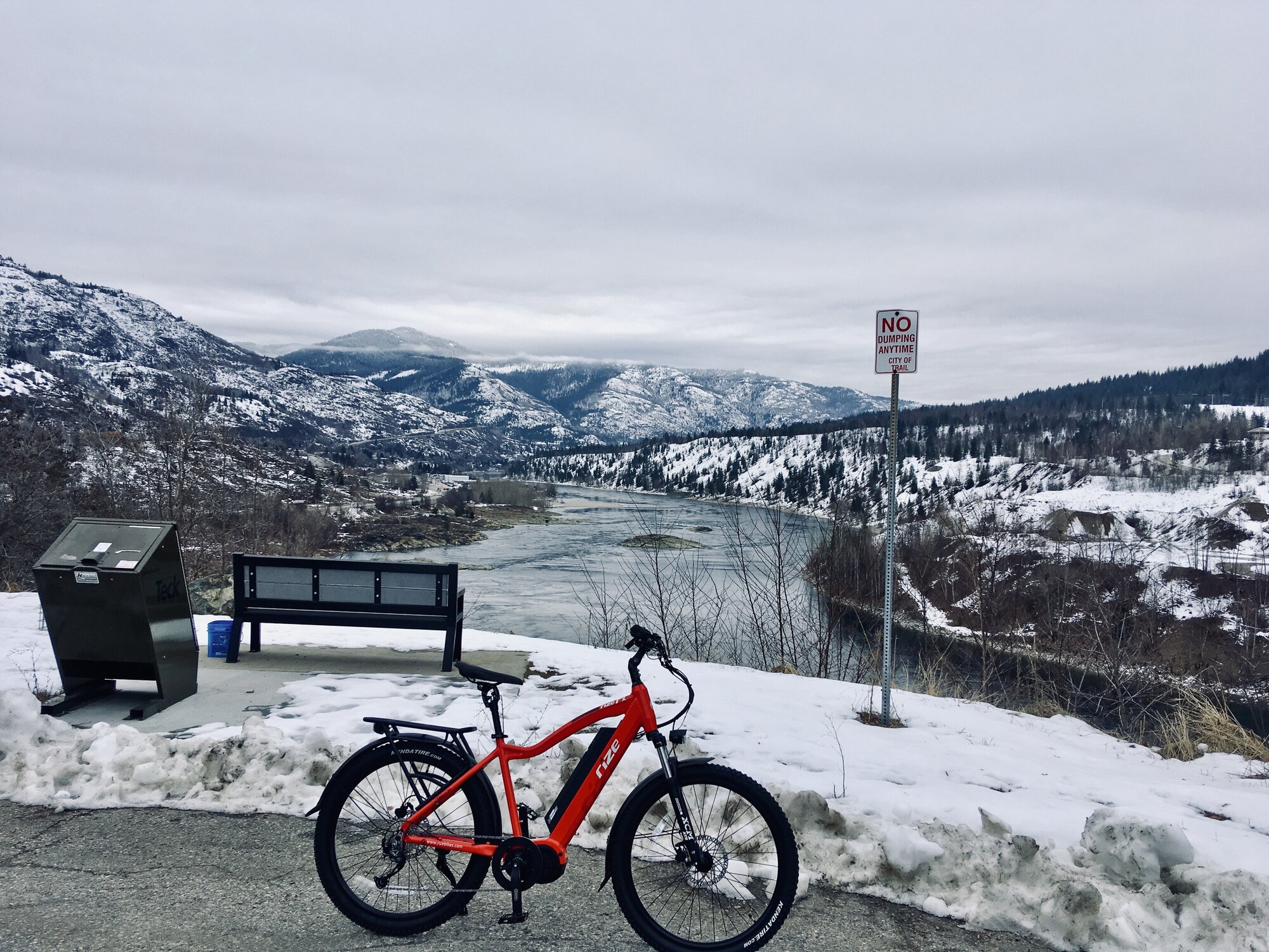

I’ve got 55 km on my RX. Not bad for January in the Kootenay’s. But snow is coming again and I’m unlikely to ride much. The power of the bike is amazing. I’m slaughtering hills that were painful before or avoided. Which is good cuz I live in the mountains. I’m surprised how smooth it is and quiet. I heard these were noisy. Not at all. Shifts great, brakes are very good, two fingers. I am bonding quickly. The red is beautiful. Have a look ....
Above the Columbia River In Trail BC looking south to the US border about 10 km away.

Nice, and consider a battery cover if you want to ride in the cooler weather and you'll see a lot more range. I found my range dropped by fully 50% when the temps drop close to zero (C - freezing). I made a simple one out of an old yoga matt for now, and it gets me back to at least 3/4 of the normal warm weather range.
