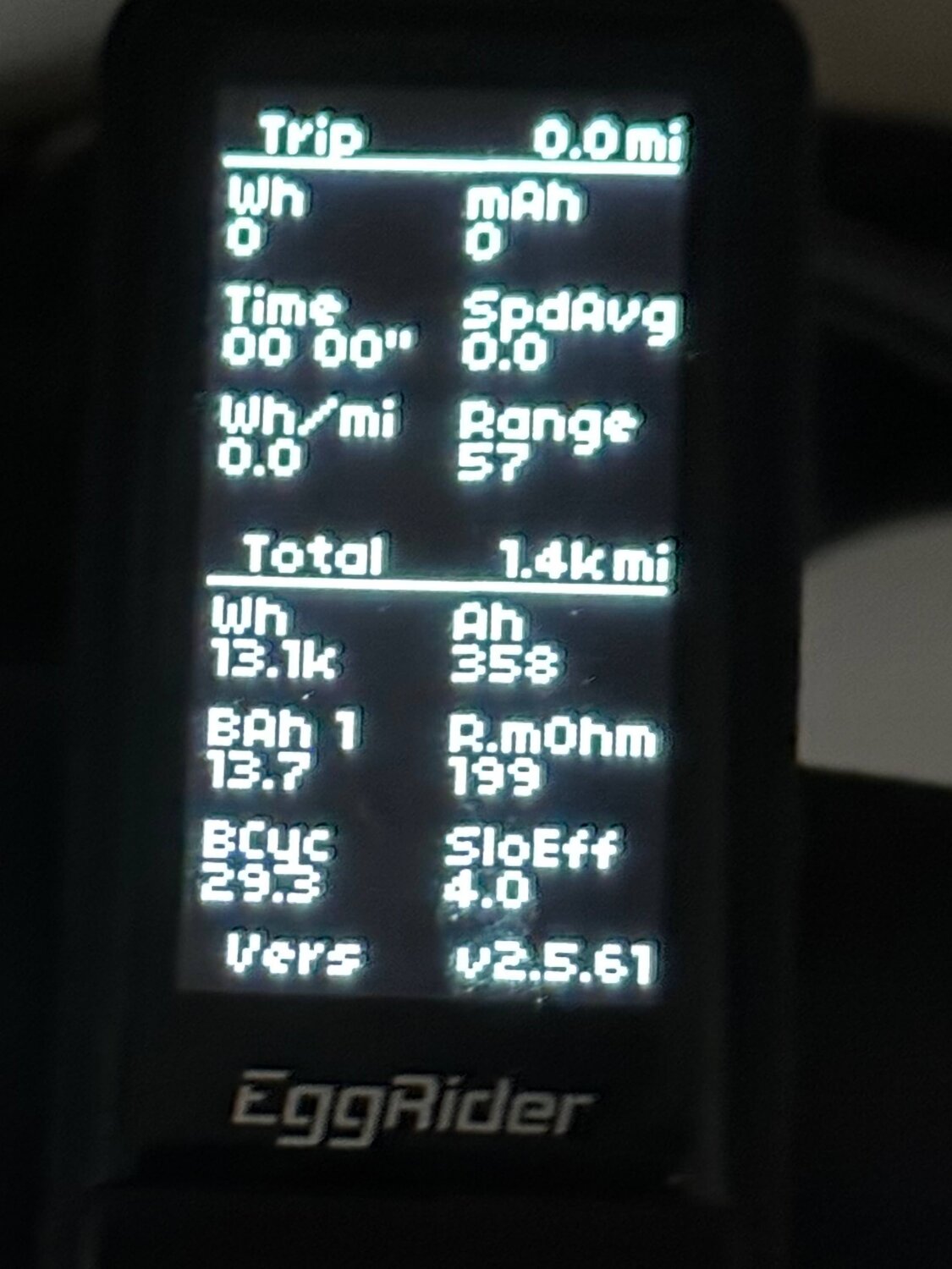

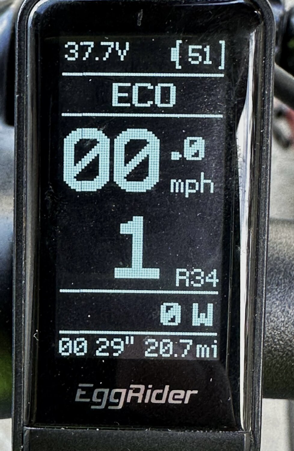

For a more exact reading of charge, I posted a thread about my upgrading the Roadster display to an aftermarket EggRider display. Still love it, for many reasons. Can’t provide voltage for the individual batteries though, only the total of what is plugged into the bike.
I can see battery voltage, [percentage remaining], R(ange in miles remaining, estimated), speed, assist level, ride time, ride mileage, on one of the two screens. And additional data on a second screen.
