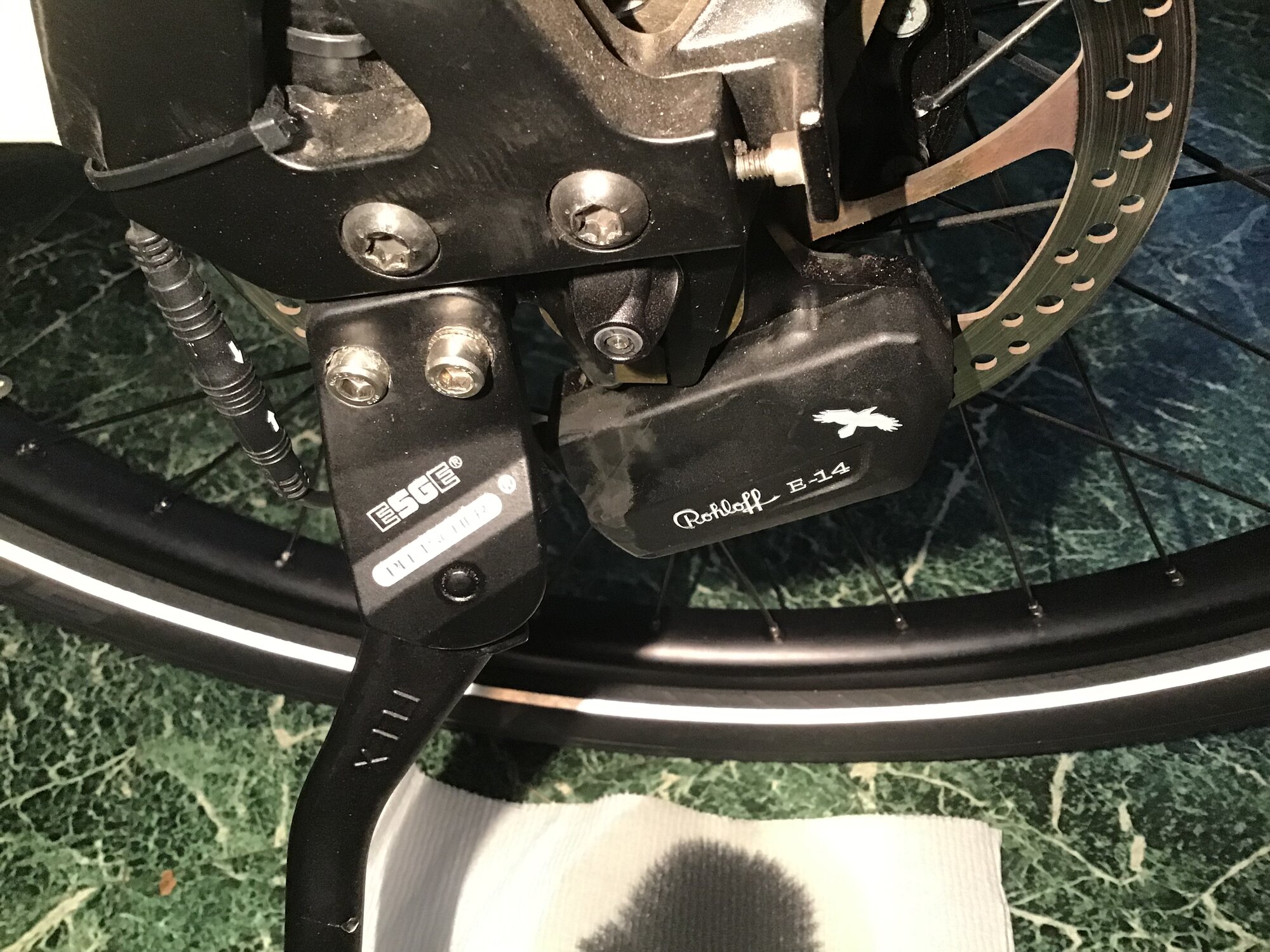

My bike has been leaking for six months. Before taking it to the dealer, I read all the Rohloff FAQS carefully. I noted that perhaps the hub had been overfilled when serviced. I prayed that it was so. But the dealer performed repeated flushes and refills under the mentorship of CM. Seals were replaced. No joy. Six months later, I receive an email where Rohloff suggests that perhaps ... it was overfilled. This is going nowhere.
Like dissolves like. The constant oil on the E14 cable/unit prompted my propping the bike upright as Rohloff suggests to reduce leaking. It had to happen .... bike tipped over, broken front fender and mirror. Im just tired of this. The first year of my warranty is soon over.
While this year seems unlikely, I do a lot of long distance traveling. I have zero confidence that in the event of a problem that it isn’t a trip-ender. These ppl don’t have a problem with leaving you high and dry.
It’s only a (severe) leak but it has revealed a lot about what to expect in the event of failure. It’s a bad bargain for such an expensive bike. They only care about sales, zero about service. I do not believe that Rohloff is unaware that the service model is subpar.

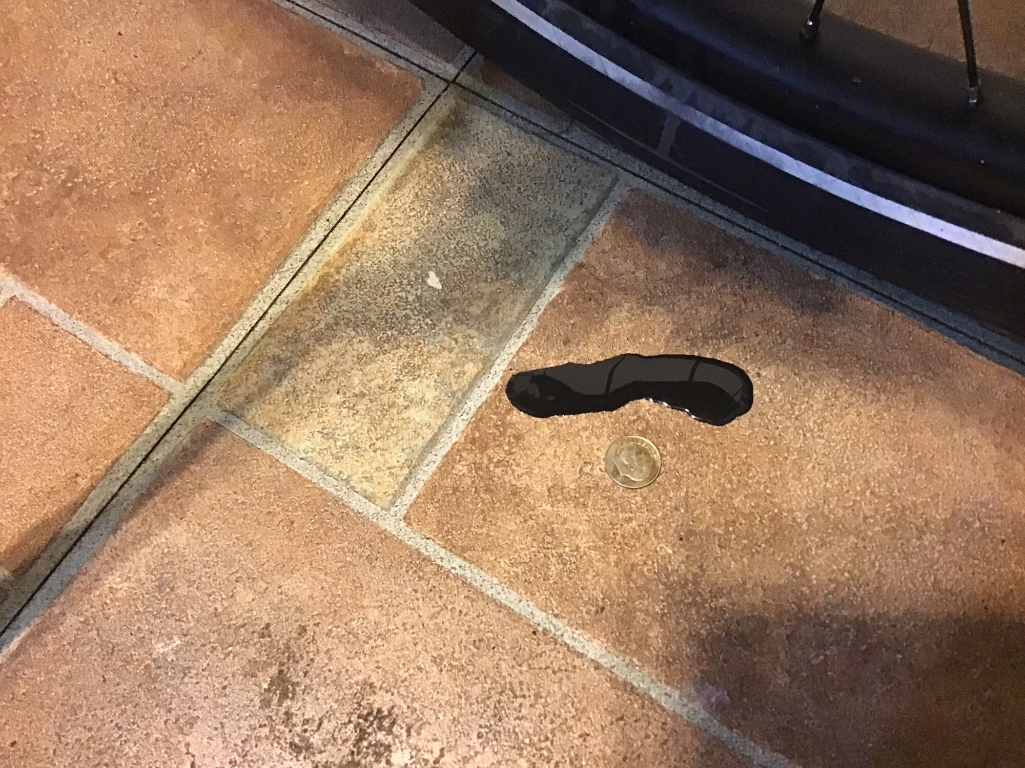

Ravi, I am open-minded to your position, but it strikes me as a tough sell that either the dealer or the manufacturer has responsibility but Rohloff has none.
The 2nd picture doesn't look nice at all. That should not be happening.
I can understand your frustration. Once you send the hub back to the manufacturer, what do you think happens? Rohloff will replace the hub. It is Rohloff's responsibility to replace anything defective. But a customer should not be held hostage during that entire process.
A truly great manufacturer will say .."Sorry, I sold you the bike. Send me the defective part, I am shipping you a working hub (new or used). I will deal with Rohloff"
The manufacturer purchases 1000's of hubs every year and they can deduct the expense or have Rohloff replace their inventory. The payment and service works differently at that level. The manufacturer may combine 25 or 30 defective hubs at the end of each quarter and ship it back to Rohloff for repair.
So, ultimately, Rohloff will have to standby their product and it is their responsibility.
Who should help you or facilitate this repair during the entire process? Why should you lose your warranty period in this imbroglio? Who has to keep up the warranty on your bike?

For the record, an offer to replace the hub was made by the dealer, but there hasn’t been much progress, partially due to COVID-19. I can’t say with certainty whether this will happen or not, or when.
You make good points, but presumably an offer to replace isn’t made routinely due to hub cost. My real issue is with the process that gets you to this point. You’ve conceded that support is limited due to Rohloff’s assessment of the US market as “minuscule.” With only “one dude” to advise on next steps, the process has felt interminable.
And for this reason, I shudder at the thought of the (routinely oil-drenched) E14 conking out in the middle of nowhere. Prior to this, I didn’t worry at all. I assumed I‘d have a week downtime. Ignorance was bliss.
