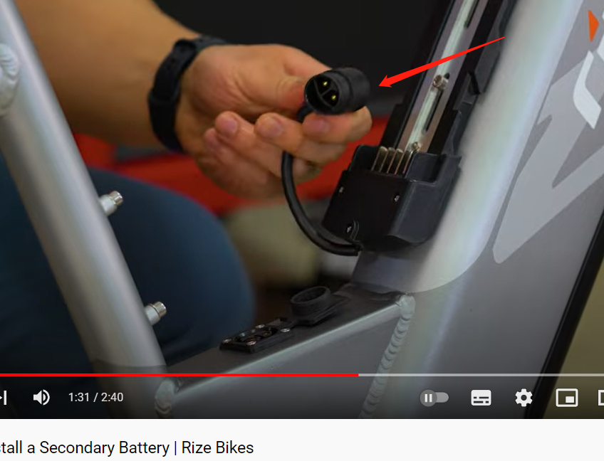

The secondary battery shall be Reention Polly DP-2170-5,368x95x125mm, max available for 52V 15Ah by Samsung 21700 cells as Rize offers.
DP-9, 368x90x141mm, 52V 21Ah by Samsung 35E 18650 cells is an upgrade option with compatible base plate.
Unfortunately we haven't confirmed what is exact connector model of the discharging port on the secondary battery.

Thank you @AHicks for recommending us always. As @tomjasz mentioned, the lockdown hasn't been lifted yet, but things are getting much better now.
