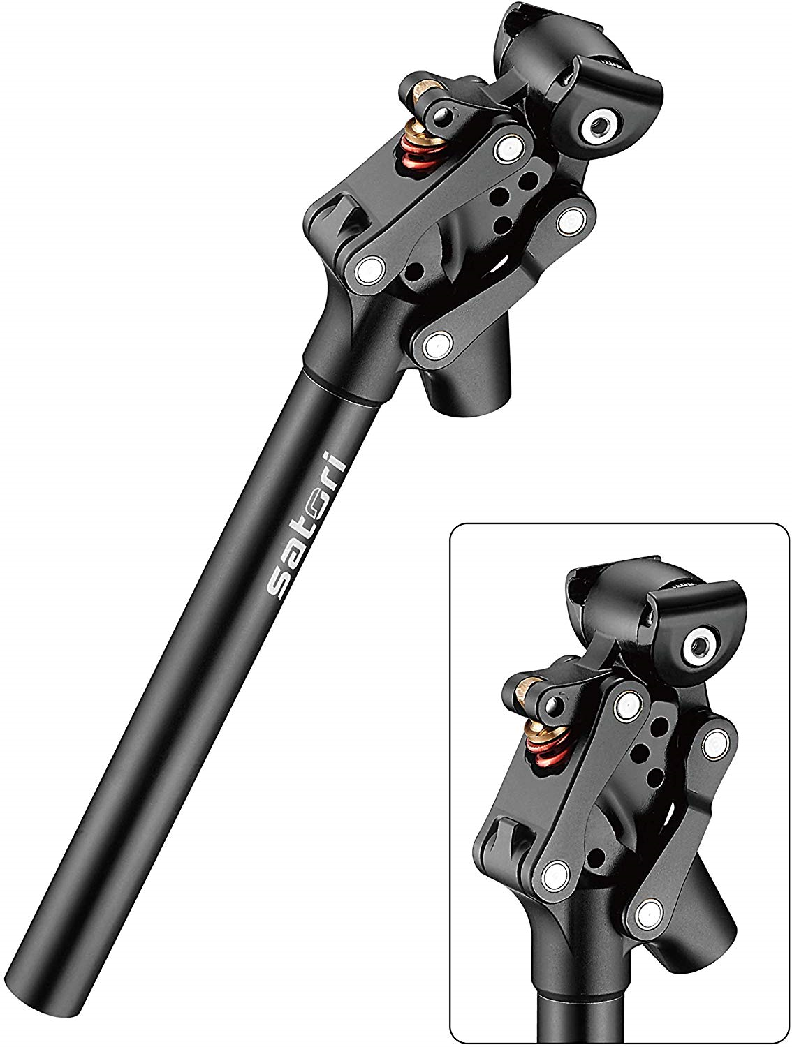

Here is a great option with an adjustable spring rate for up to 250 lbs... $59 on Amazon ;)
Thanks. Good price and the right diameter but it is about 4" shorter than the one that comes on the Rad Rover so not sure if it will work.
