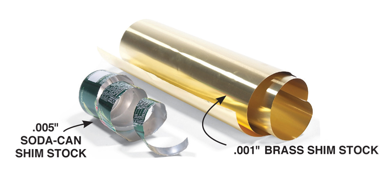

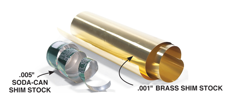

fine grit sandpaper works well as a make-shift shim.
Or use Finish Line Fiber Grip anti slip gel. I have a tube of this and it's like gel sandpaper as it's got lots of grit in it and will fill that micro mm
harryS
I'm pretty sure you could snip off a piece of aluminum soda pop can and it would fit nice. I'm checking out a piece at slightly under .1 mm.
FlatSix911
This is the correct answer... and has been used for decades by bike and moto mechanics.
Make sure you use Coke... Pepsi won't work! ;)

The soda can trick is tried & true. I've used it for years on my old Diamondback. Make sure you use aluminum. Brass or steel will cause corrosion.
