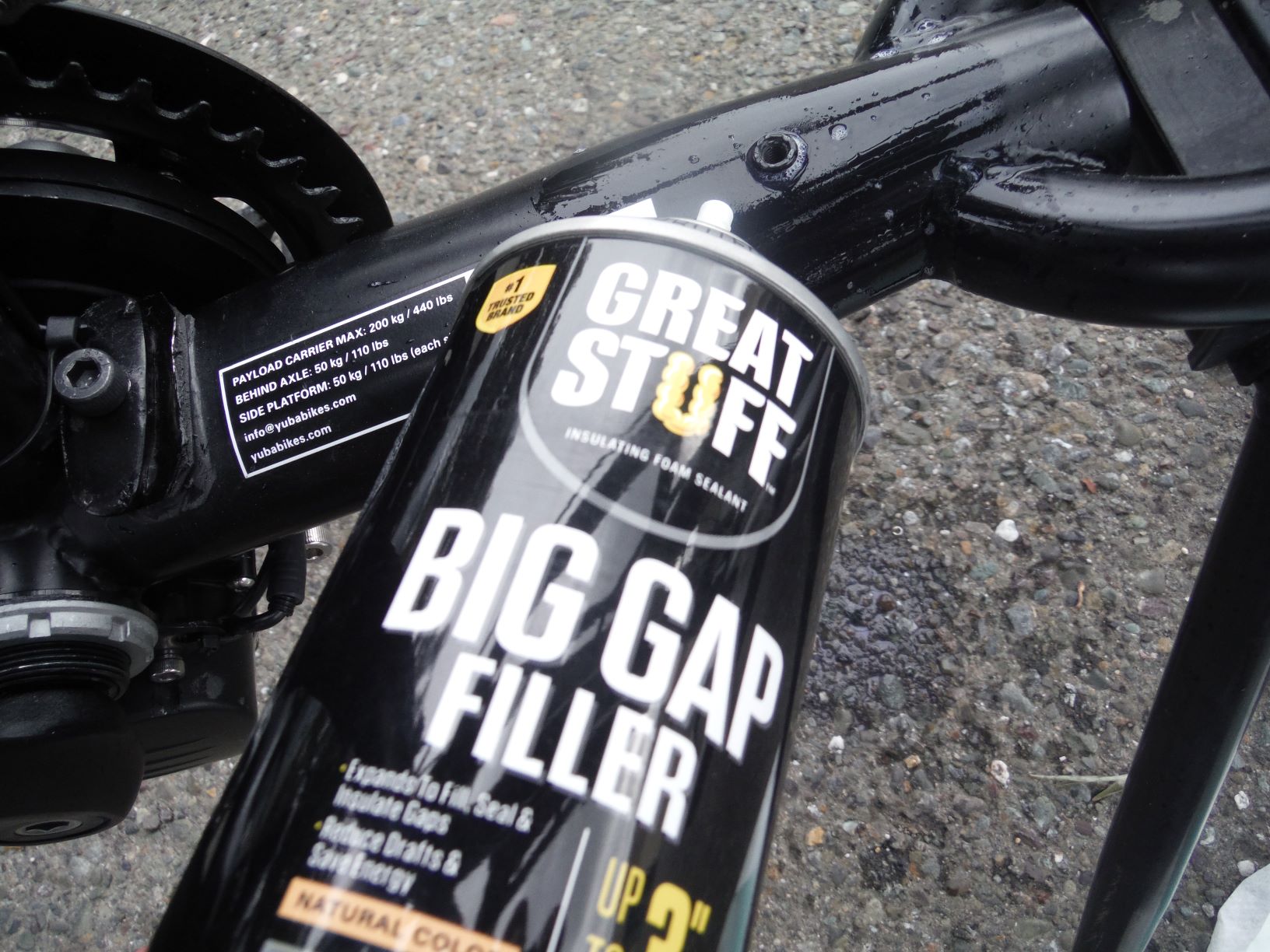

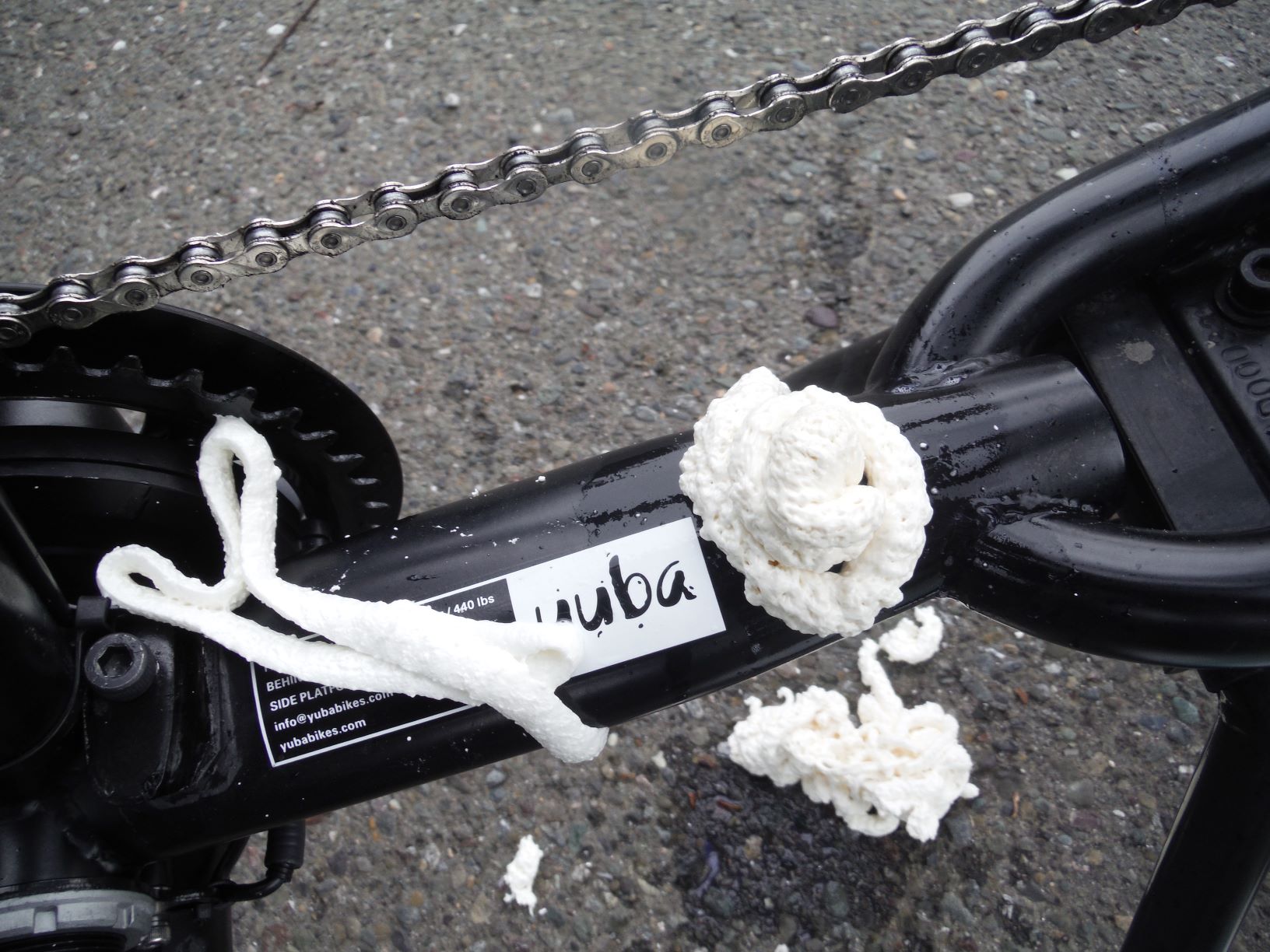

There are some things you do not want to do.

MANY of the newer bikes have the controller just sort of stuffed into the frame. It's VERY possible for these to rattle like crazy.
