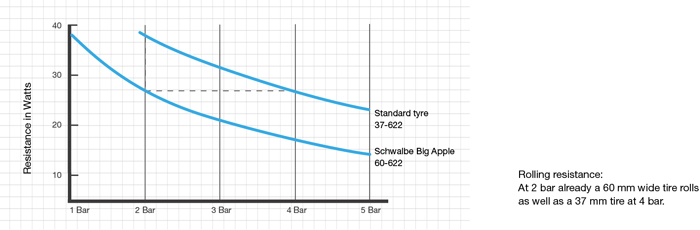

Schwalbe has a good article HERE that discusses the major aspects of tire rolling resistance. I particularly like this graph;
In this comparison the wider tire has lower rolling resistance than the narrower tire, even with the narrower tire running at a higher pressure.
Schwalbe concludes that wider tires will have lower rolling resistance than narrower tires when run at the same pressures. When the pressures are different the rolling resistance becomes a function of pressure difference, tire tread, construction, and other factors. Depending on the combination of these factors narrower tires can obviously have lower resistance, but it is not a hard and fast rule, just sayin' 😎

I've seen their chart before but my experience with different sizes of even the same model schwalbe (brand I usually have bought) tire in different sizes has always been that thinner, higher pressure tires take less pedaling effort. Tannus makes similar claims about their solid airless tire vs same size regular pneumatic tires but I have read a few reviews indicating that Tannus tire have noticeable increased rolling resistance vs similar pneumatic tires.

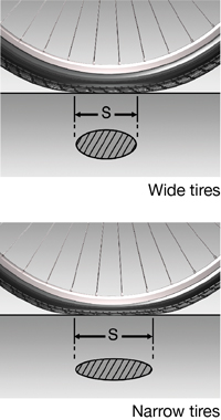

As the inflation pressure divided by inner area of the tyre means the force acting on the tyre wall. it is obvious the lower pressure in thicker tyres will produce the same force as higher pressure in skinnier ones. (Or, am I getting that wrong?) In other words, same air force exerted on the tyre walls means the same tyre stiffness, or the same rolling resistance.
What, however, about the fact thicker tyre has bigger contact area with the surface than the skinnier one? Is it not reflected in increased friction? (It is a question because I don't know the answer).
There also is another factor: The tyre tread. I can easily compare 1.75" Smart Sam (a slightly aggressive multi-terrain tyre) to 2" Electrak (slick but soft rubber tyre). Under the same road conditions, I'm achieving high speed on Electraks way easier than on Smart Sams! The difference is quite dramatic. (I use Smart Sams just because they allow me riding in light off-road while Electraks are road only tyres).
If the tire pressures are the same for a wide vs narrow tire the contact areas would of course be the same; a 200lb bike + rider puts ~100lb load per tire. At 100psi each tire would have a contact area of 1 sq inch to support this load. The Schwalbe article discusses this as being related to deflection, the wider tire deflecting less for each rotation.
Obviously for tires that are not at the same pressure or being of similar construction the situation is more complicated. Schwalbe explains this as a function of pressure difference, tire tread design, tire construction, and other factors.
Other sites also reference wider tires as becoming more popular in the pro races as data accumulates showing lower rolling resistance, all other variables being similar.
One of my sons is lead mech engineer for a bicycle components manufacturer. Among other products, they design and market bike tires. He confirms the same conclusions that Schwalbe and others have come to and the trend to wider tires in the pro circuits. He does stress that there are design variables between tires that impact rolling resistance so depending on specific choices, YRMV.

Inflation pressure versus rolling resistance
Lower tire pressure means fewer pounds of pressure on each square inch of the tire. Since the tire supports the same load at lower pressure, the contact patch will be larger. For example, Wheel Energy measured the footprint area of a 700 X 23mm tire inflated to 112 psi with 50kg of weight on it to be 75mm long and 15mm wide. The footprint of the same tire with the same weight on it, but inflated to 84 psi, became 82mm long and 14mm wide. The longer contact patch means that the tire deflection will be deeper, resulting in more internal friction and hysteresis within the tire’s layers. That makes the case that higher pressure reduces rolling resistance.
On rough surfaces, however, a tire at lower pressure is able to absorb more of the bumps than a tire at higher pressure, with less deflection of the bike and its rider. This is the same “sprung vs. un-sprung weight” argument that demonstrates why suspension makes a bicycle faster on rough terrain — it takes less energy to keep the bike rolling if only a small amount of weight is lifted (like a small section of the tire) than if the entire bike and rider is lifted by the bump.
If the bike were rolling on smooth glass, it’s clear that higher pressure would be faster. The question is, what is the ideal pressure for the surface you’ll be riding on?

I just found this thread. I appreciate that Schwalbe chart, We put Big Apples on my wife's bike, and she consistently overtakes my bike with skinny Kenda Kwests coasting downhill. The chart confirms what we see in practice,
