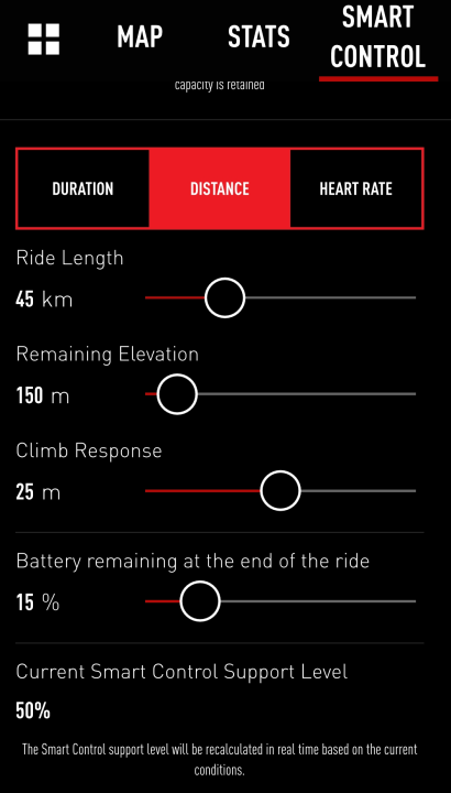

Say, I want to do a 45 km (28 mile) round-trip commute. I want to reach my destination on a single battery and complete my ride very fast. With traditional approach, I would probably set the Sport mode at 70% Support with 100% Max Motor Power and prayed the battery lasted. In case of strong headwind, I would realise (worrying all the time) that I might need to decrease the assistance level. Or not, because I might count on the downwind during the return trip to reduce the penalty on the battery. I would be worrying the whole time.
With Smart Control, I learned to stop worrying.

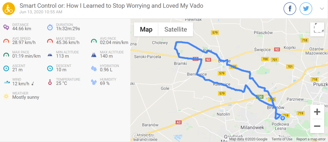

The Vado on, Mission Control on. Selecting "Let's Ride" and then Smart Control. Activating the Smart Control, then setting the parameters:
After the ride has started, I got powerful boost from my Vado. I literally zoomed towards my destination! Smart Control is continuously reading ride parameters and fluently adjusting the assistance to met the set criteria. I could cover my outbound trip of 21 km in 44 minutes (I need 30 minutes to complete the same route with my car). The battery use was as economical as it has never been before! The assistance is variable but it was around 60%.
I switched the Vado and Mission Control app off while I was visiting my daughter. On the return trip, I set the Smart Control again, for the remaining ride distance. As I was partly riding upwind (and Smart Control detected a lot of battery charge was left), the calculated support level was even at 75%.
Without slightest worries, I completed my 45 km ride in 1 h 32 mins with the average speed of 29 km/h. Returned with 26% battery left.

I took safe approach to the test: The route is very well known to me. I knew I would make it with the 70/100 assistance with 5% battery left. The Smart Control performed far better than I expected. As for me, that was a very fast ride and I admit I worked hard; I sweated. The ride feeling was as if I were a Superman. Still 26% battery left!
All this gives me a lot of confidence. I and my brother go for a long ride tomorrow early in the morning. I intend to set Smart Control to 60 km and 150 m elevation gain for each battery with 15% battery left and let us see how that works out. If it works, the way for making 120 km is open.

@Stefan Mikes can you still change the support level during the ride? I realize this might change the pre trip planning programmed.
I think you need to quit the Smart Control before you set the manual assistance level. Or, pressing the +/- button leaves the Smart Control, not sure. Smart Control is the fifth Support Mode (the other being Off, Eco, Sport, and Turbo; the Walk is the sixth mode). The display shows two upper bars marked on the Support Level graphics. It is like the automatic transmission.
I'm not sure how it is done but Smart Control is aware of the fact you're riding uphill (it will increase support after you rode the Climb Response distance uphill; it could be 0, meaning an instant reaction). Yet, the Smart Control must assure you can complete the ride as planned, so overall support might be decreased on the whole ride.

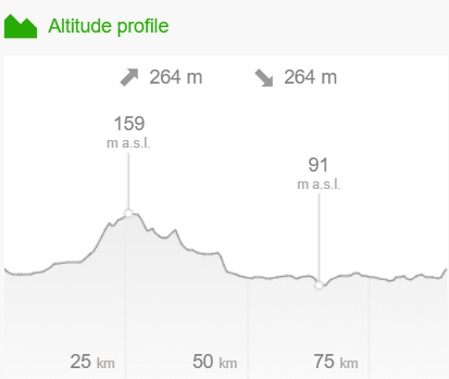

It is vital to enter the proper Remaining Elevation if you live in a hilly area. If your bike route planner tells you your total elevation gain would be 3000 ft, such figure has to be entered in the Smart Control.
Here, I can see I would meet 264 m of elevation gain for the first 60 km. I need to enter 300 m so Smart Control is properly informed.
It is a lot of fun to ride up an overpass or to emerge from a tunnel with Smart Control. Before I rode onto any overpass, I was downshifting two gears and continued pedalling. That's a fantastic feeling to ride up at 27 km/h.
Here, I can see I would meet 264 m of elevation gain for first 60 km. I need to enter 300 m so Smart Control is properly informed.
