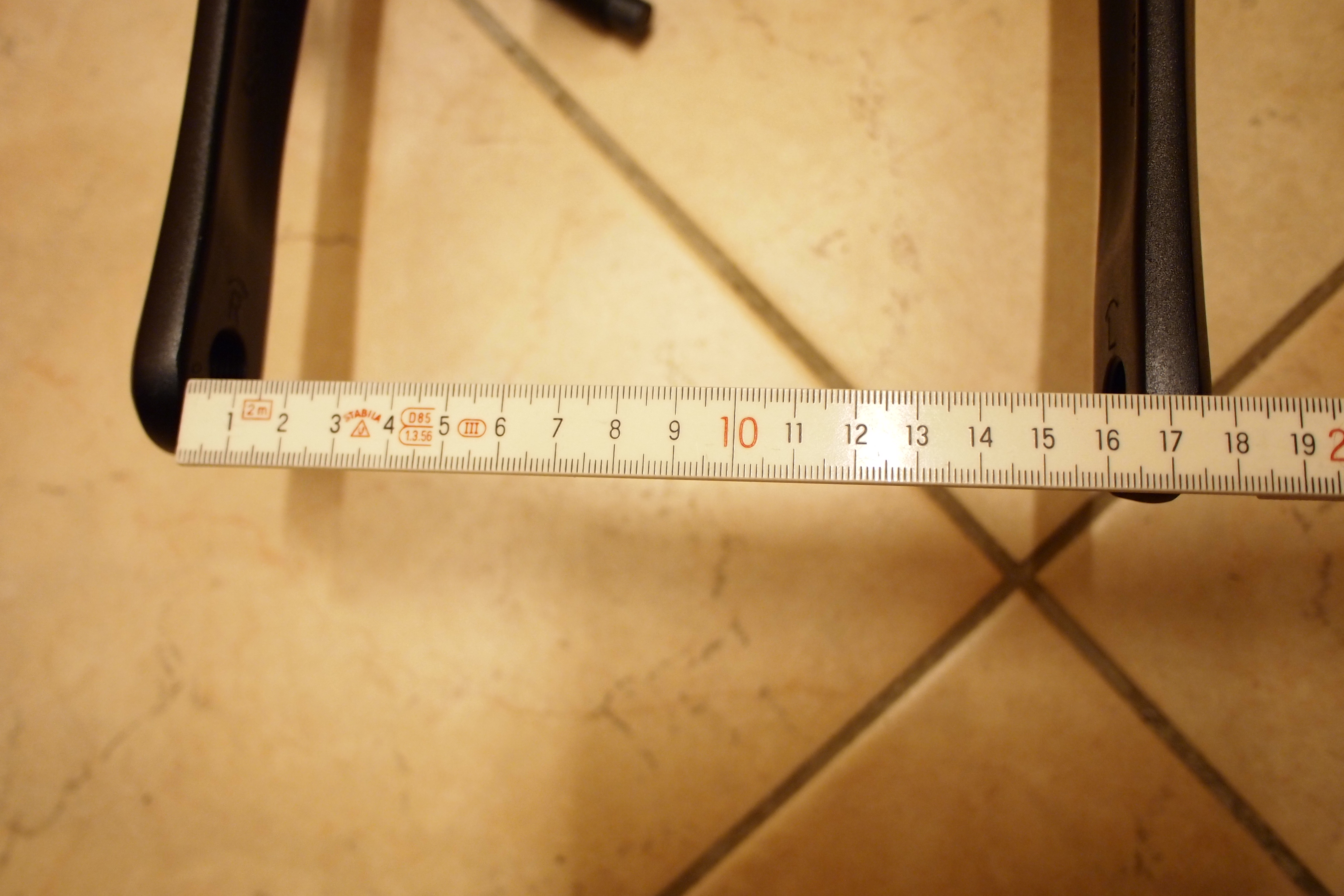

Hi MLB,
here are some measurements at last:
the inner distance of the (generic) crank to crank is 16+ cm (cranks were just loosely fitted on the axle).
As the BaFang has quite an offset to the right when mounted on my 73mm BB I partially adjusted this with another left crank that reaches a bit more outward so I actually end up with about 18cm from inside to inside (and still got some offset).
A few more pics concerning this topic here: http://electricbikereview.com/community/threads/my-surly-troll-half-fat-e-bike.993/page-2#post-22968
Hope this helps,

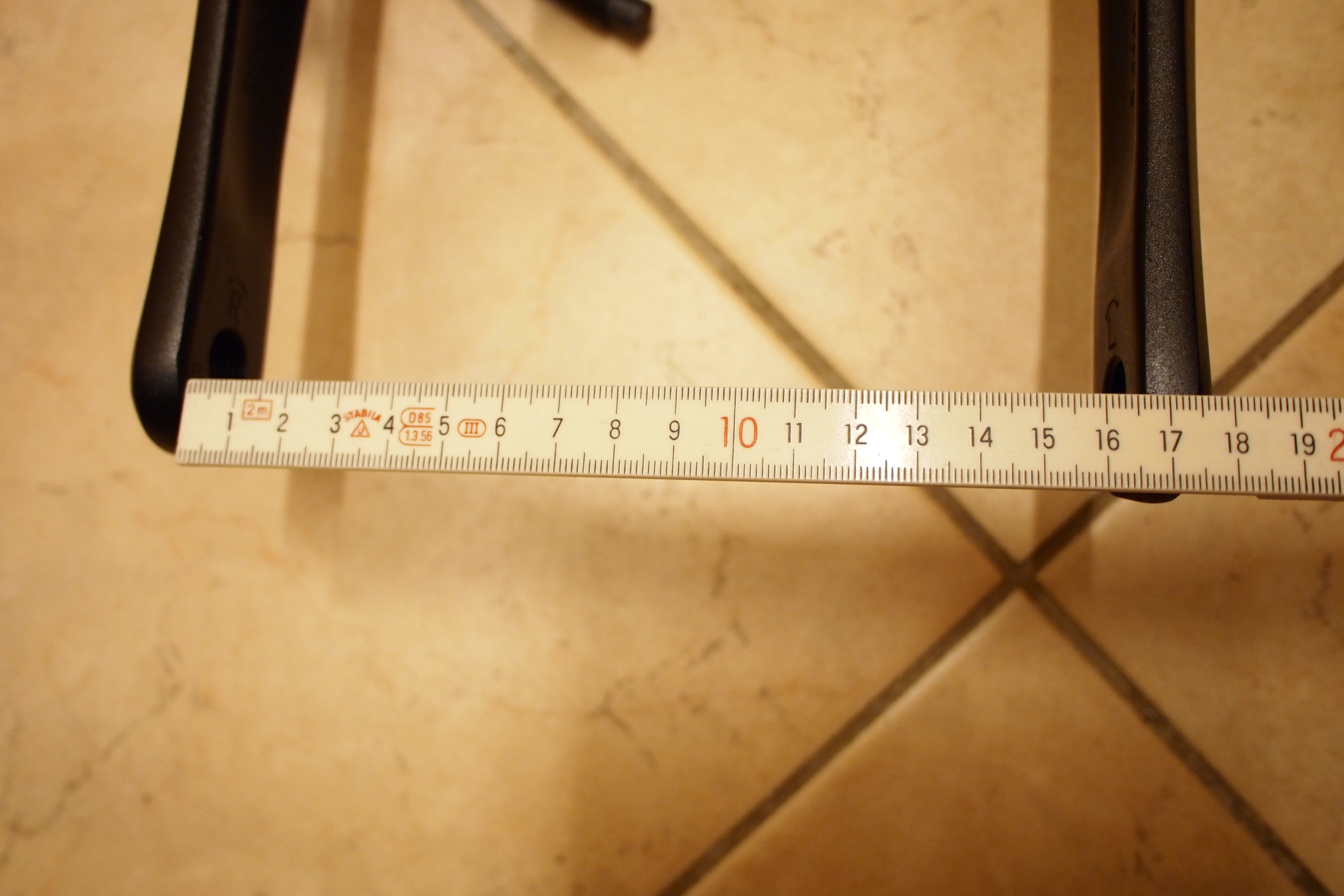

Hi MLB,
Hope this helps,

That helps a ton! I measured 2 other bikes and my trike and all are around 14-15cm. 18 doesn't "look" like it would be a big deal at all. (to me).... but I've been wrong before. LOL
