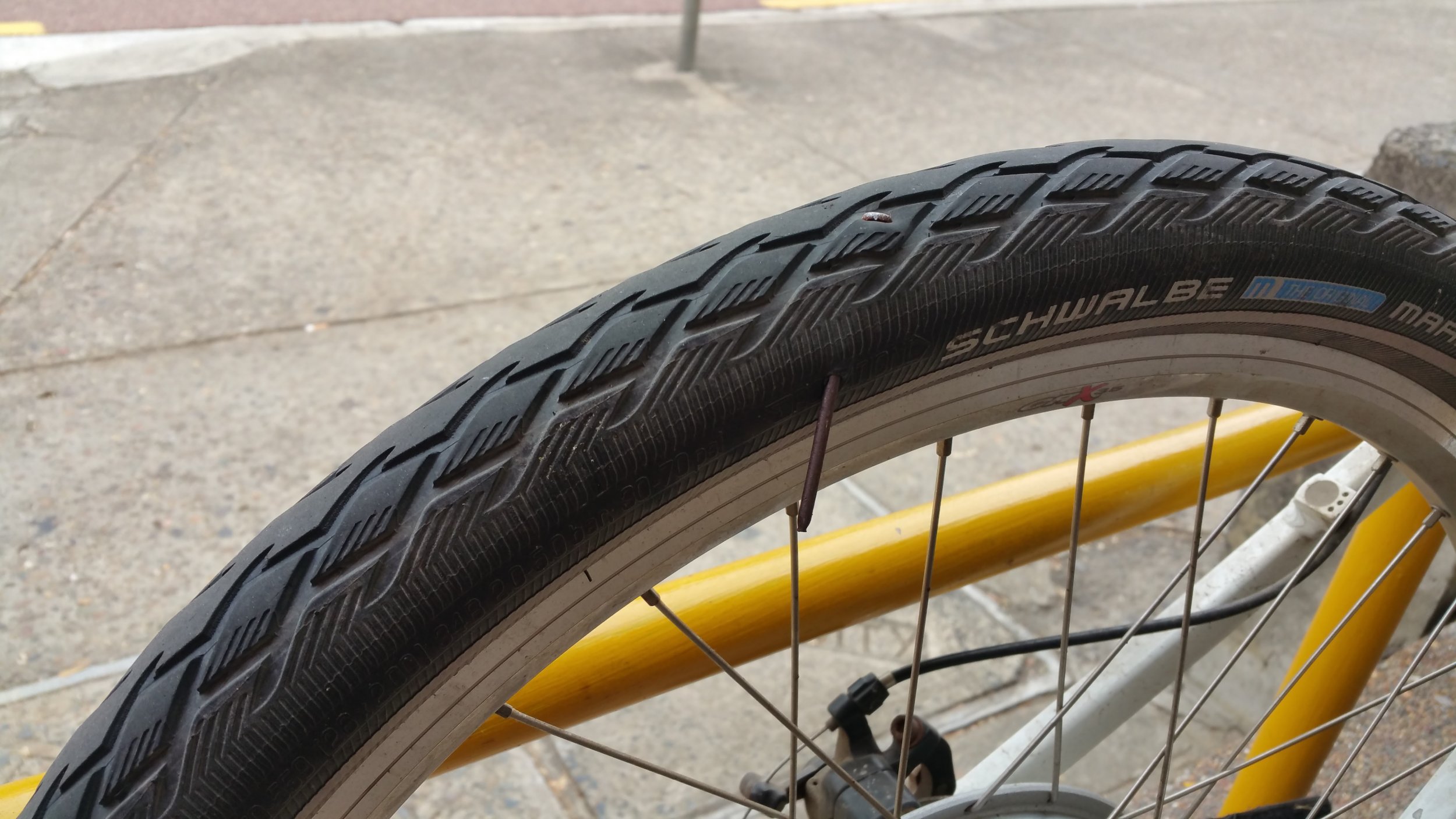

so much for puncture resistant tires.
fooferdoggie
I think it sipped in more on the side where the protection is thinner. Schwalbe Marathon Plus Smartguard then of course I use a co2 cartridge and the new tube won't pump up. so I had to find the hole on the first tube and patch it . of course I am late getting home and it is dark and 40 degrees. its been maybe 8 years since I changed a tire so it took a bit. but I found my lumos helmet worked great as a light to help it all out.

Traveling at speed i think it doesn't take much to drive a nail through a tyre, as your bike passes over the nail the front tyre skips the nail up putting it a perfect position to drive it into the back tyre, that's what happened to mine, also marathon tyres, just had this thumping noise coming from the back wheel, pulled into post office bit later and found the nail, left it alone since the tyre was still holding air and cycled three kilometers home and removed the nail, thanks to the slime in the tube it still holds air and did so until i fitted a new tyre a year later. 43274

well I guess the patch was not perfect I guess it was too cold out to work well and my tire was flat this morning. but I could pump it up and ride. found a slit in the new tube so thats why it did not work. I guess I better check new tubes right off the bat. but it will hold till Monday when I can use my lift at work to make changing the tire easier.

my patched tube was leaking overnight so I filled it this morning went on a ride went to get a bottle of fix a flat came out the tire was flat but I needed a hose clamp to get the fix a flat in so I went to Home Depot less then a mile away and the tire went flat fast. I got the hose clamp put the fix a flat in but the tire would not hold I walked home only a mile. got home and found a blunt metal piece that went through the tube in two places. it went a little to the side of the tube where protection is thinner. so I just replaced the tube.

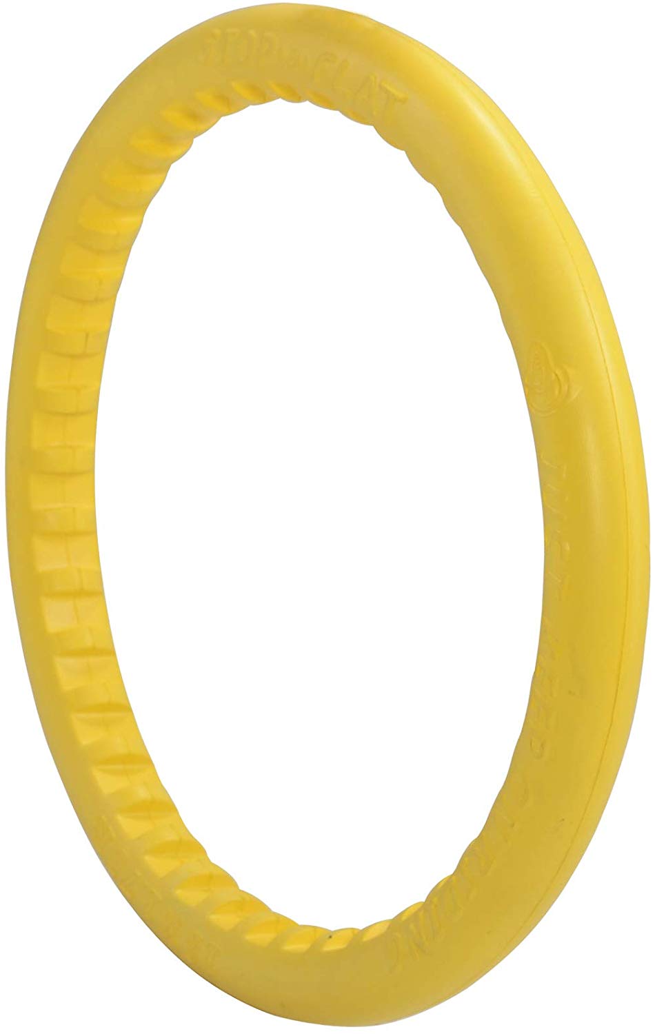

Anyone tried these solid tubes?
Bell used to make a similar product but they are hard to find.
The idea is interesting but somehow I think they would give a very rough ride.
Those will be heavier and like the Tannus Airless tires ( which get poor reviews) they will have more resistance and my guess is the handling performance will be weird. On the other hand it seems virtually Impossible to get a flat with those. It looks difficult to mount those also.
