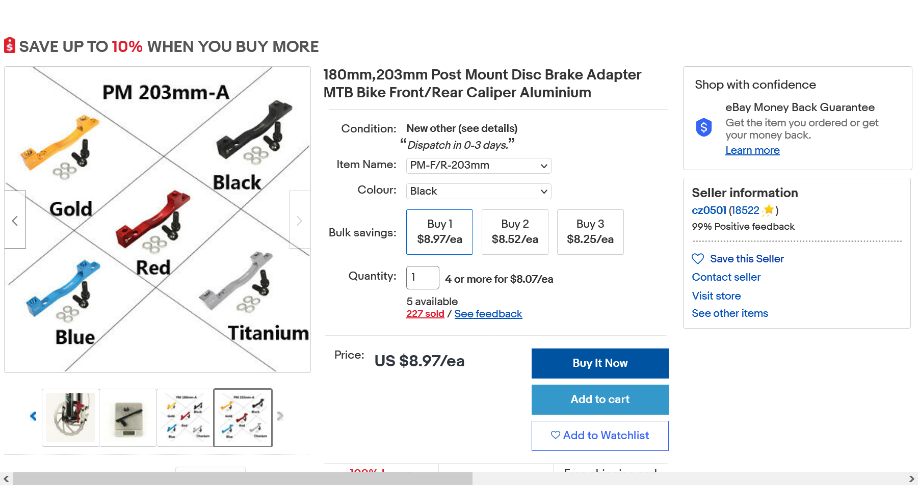

I want to upgrade to 203 mm rotors on my Tektro hydraulic brakes--actually on my non-ebike, a Surly, but I may want to do the same on my M2S as well. I'm searching all over the place and only find front adapters but never rear adapters. What's the deal? Anyone got a source? This is really strange. Help!

They are out there. You don't have to get the Tektro brand, any brand of adapters should work. My Surly Disc Trucker uses IS style mounts (bolt from the side). I am not sure if there are Surly models that use Post style mounts.

You guys are great! Thank you. I wondered if there were some sort of generic part I could use. I'll check this out.
Just checked the bike. They are bolted on from the side, not post mounted, so that adapter from Northwest Bicycle should work.
