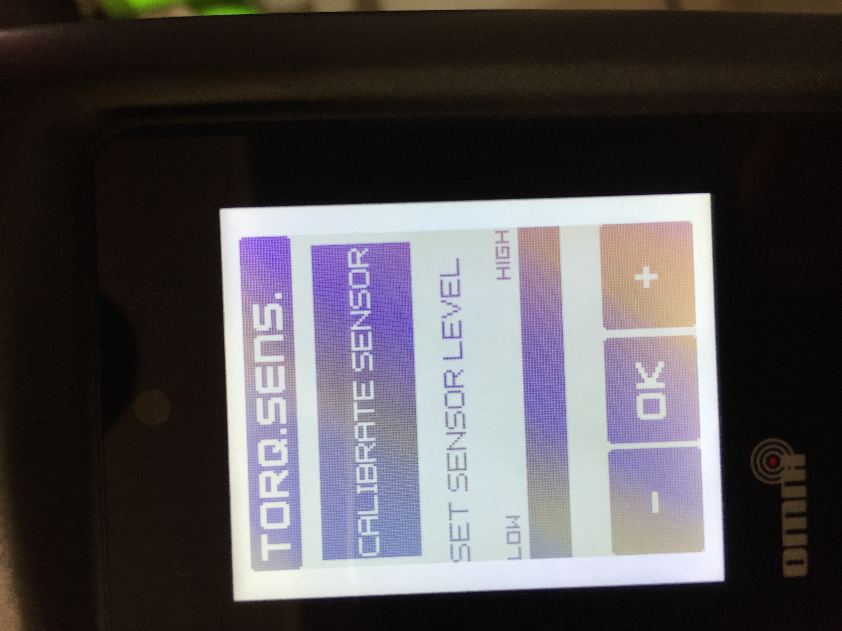

After retightening my axle, I noticed my Stomer ST2s power was very touchy, on/off during pedaling and it was hard work getting above 23mph in setting 3. I stopped, accessed the torque sensor setting in the menu and selected recalibrate (you have to be sitting on the bike without touching the pedals or brakes). Immediately, I had full power back, smooth power transition and excellent cruise speed again. YMMV

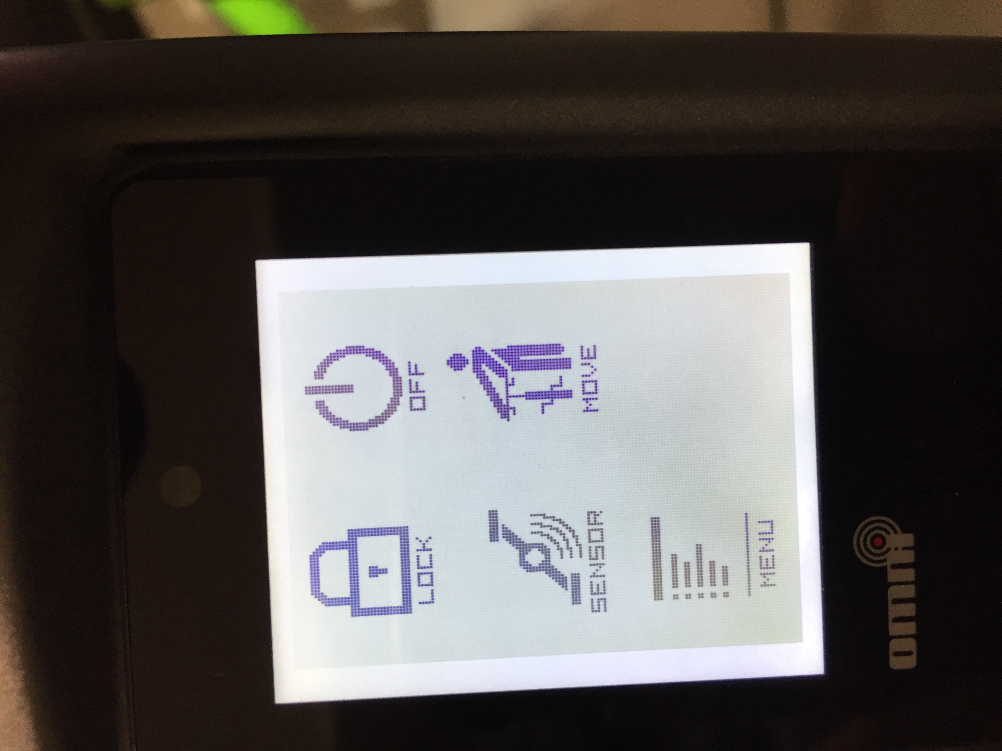

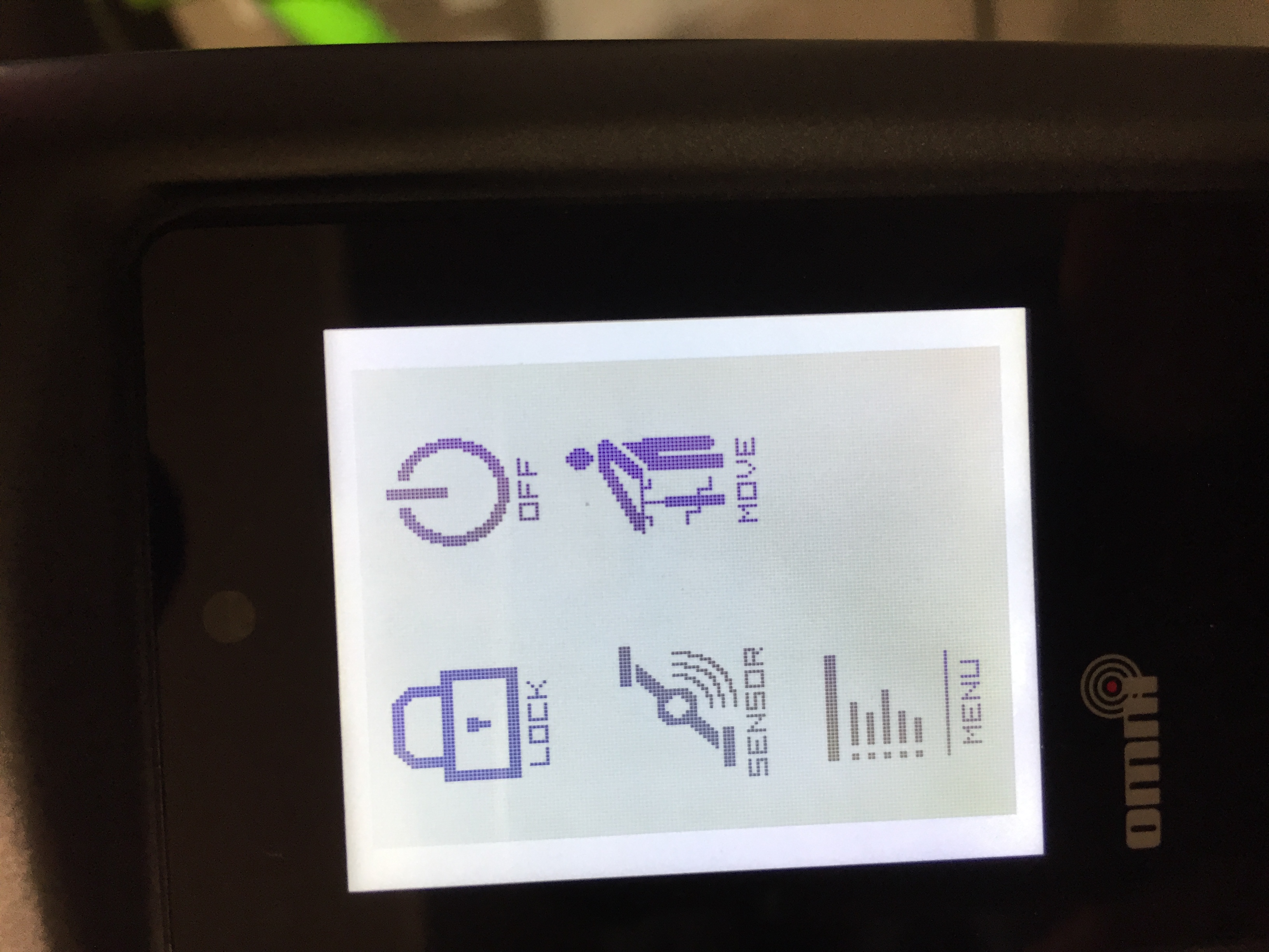

  • On my Stromer ST2s, I access the settings menu using the "on" button under the crossbar.
  • Then the "SENSOR" menu

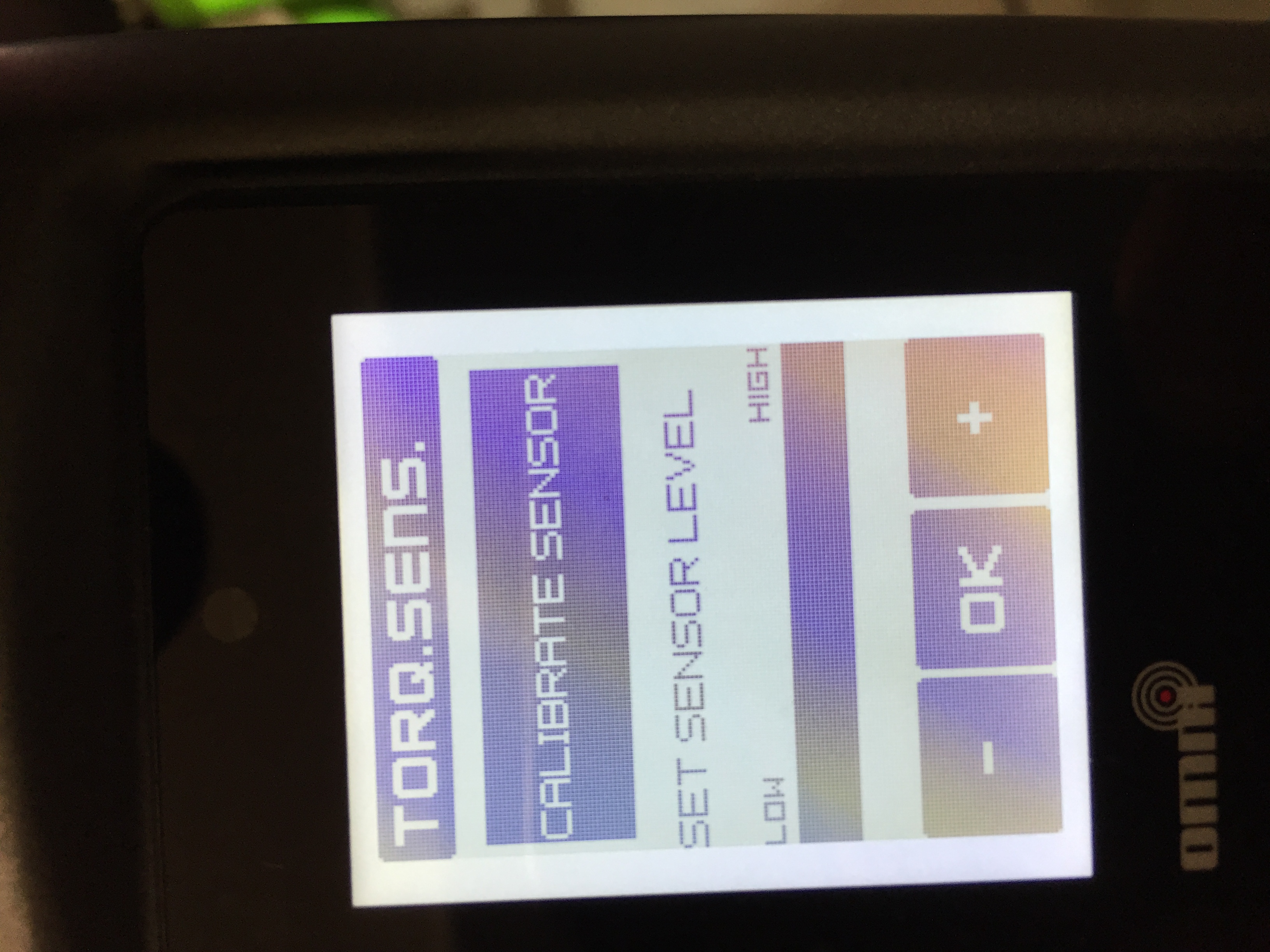

  • Which brings up "CALIBRATE SENSOR" or "SET SENSOR LEVEL"
  • Sitting on the bike, without touching the pedals or brakes, select "CALIBRATE SENSOR"

I've done the above, but??? I have not been able to recalibrate the sensor. In the menu I to go to settings, torque sensor. Torque sensor bar is on the middle between the - and + sign but theres not recalibrate option
