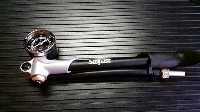

A Quality Pump is Provided
The StaFast stem is available in two stem lengths. The 95mm length is typically found on Mountain and Urban bikes, while the 105mm length is typically used on road bikes with drop handlebars. I measured the stem length prior to receipt and found the Stromer ST2 to have a 95mm stem length (as measured from the center of the steering tube to the middle of the handlebar).

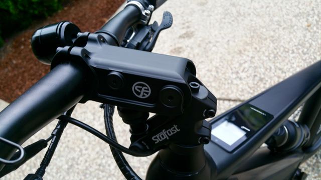

Fit and Finish
The StaFast stem body is made from the 3D forging of aluminum alloy 6066T6.
The cylinder is manufactured via a Swiss CNC machining process with controlled and tight tolerances. The fit and finish is excellent and you can tell that attention was paid to delivering quality materials and tight tolerances. While not intentional, the matte black finish provided a very close match with the Stromer ST2 stem I removed and I am surprisingly pleased that most folks would not know that the StaFast stem was an aftermarket add-on.

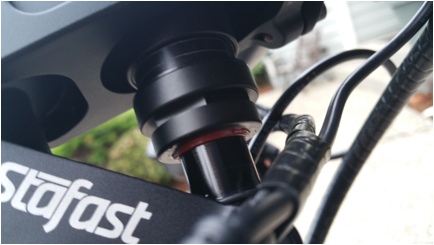

Air Cylinder and Stem Angle Adjustment Nut
Give the quality of construction and the tight tolerances on the StaFast stem; it requires a delicate yet firm push to properly seat the stem. We did notice that the StaFast stem scraped the carbon fiber steering tube but there was no damage and the scrapes are covered up completely by the StaFast stem.

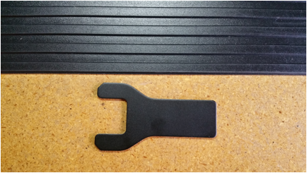

StaFast supplies a small wrench to adjust the stem angle.
