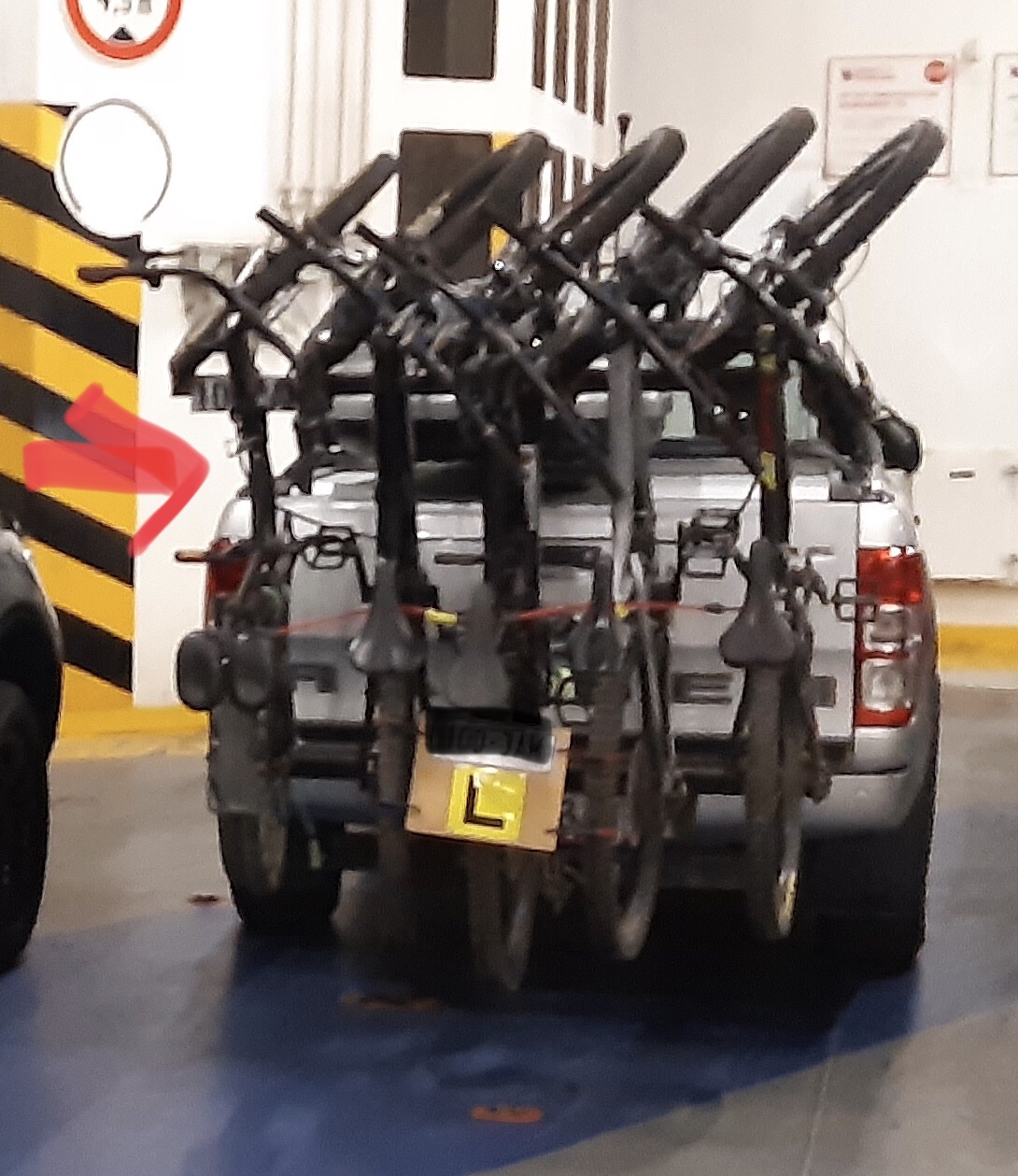

Shouldn't need step-through if bike as dropper post.
except she wants one - aesthetic +/- she often has panniers on the back so finds a step through easier.
We already have a fleet of mountain bikes with dropper posts
