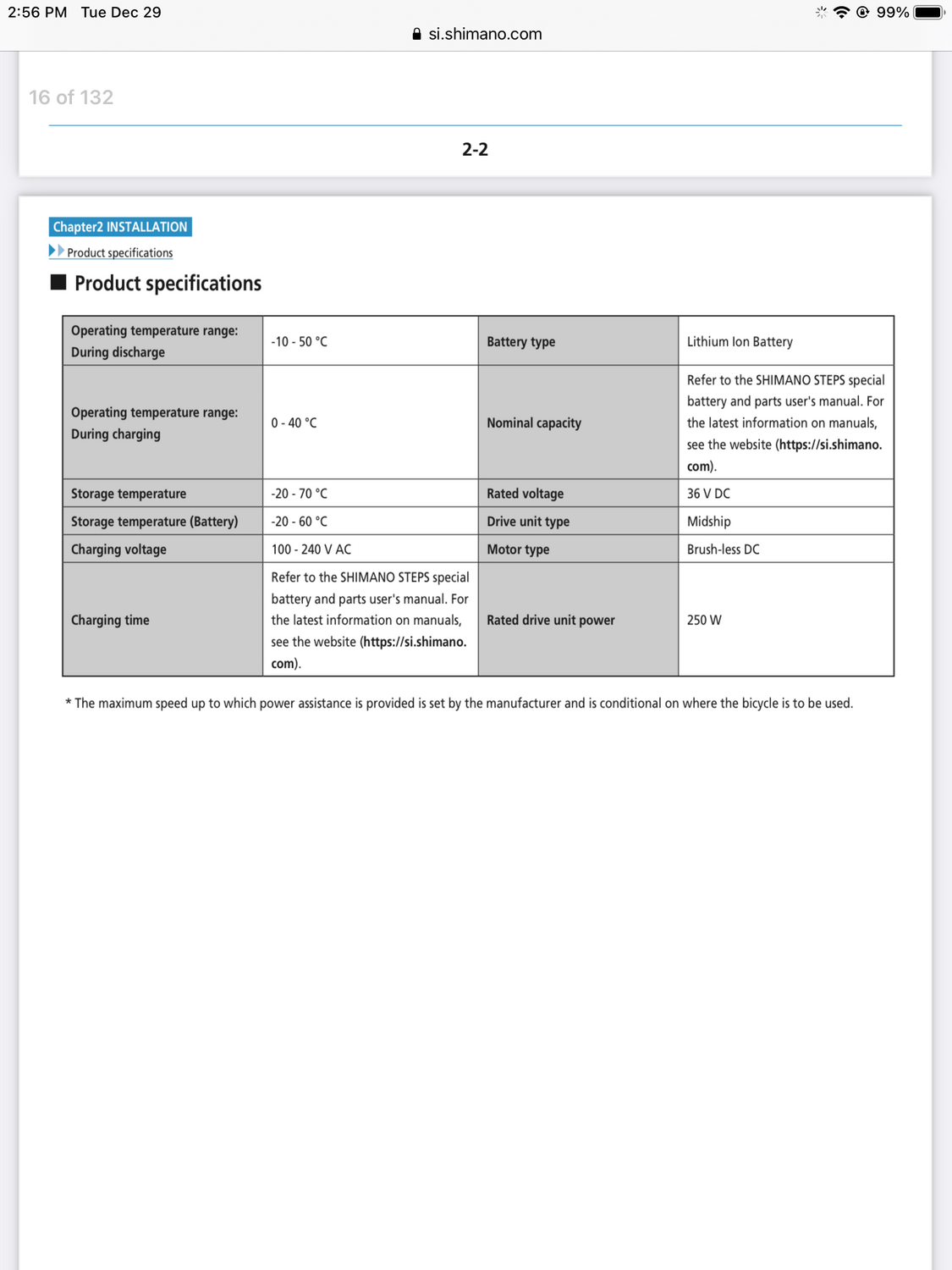

These are the specs from the E8000 series manual. I believe they are for both the motor and battery.
Thanks, I have seen this, but I'm not convinced, based on my issue that this is the drive unit's operating temperature range. If it is then it mine is not working anywhere close to the spec as it was well above -10.
The way it is worded and every other reference to temperature and STEPS that I have seen, it looks like the battery only temperature range.

I have to disagree. I believe the discharge operating temperature is for both the motor and battery. Why would they list two storage temperatures, with one being specifically for the battery only? With that said, unless specifically noted, I’m pretty confident the temperature specs are for both.
Furthermore, the table also lists the drive unit type, motor type, and rated drive unit power. These are not battery specific.
