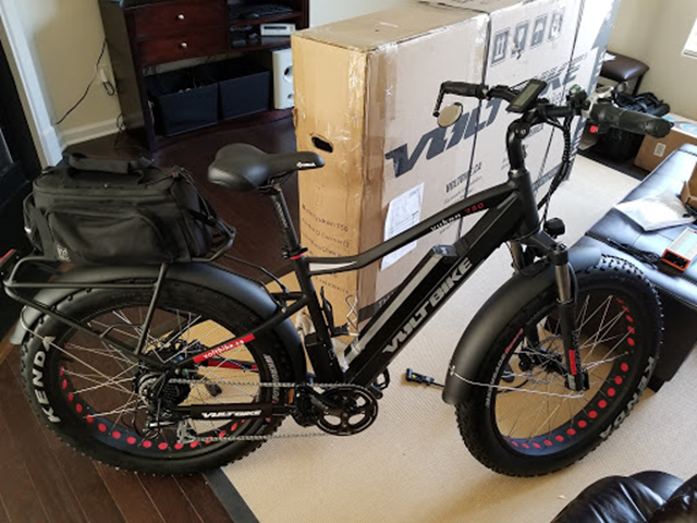

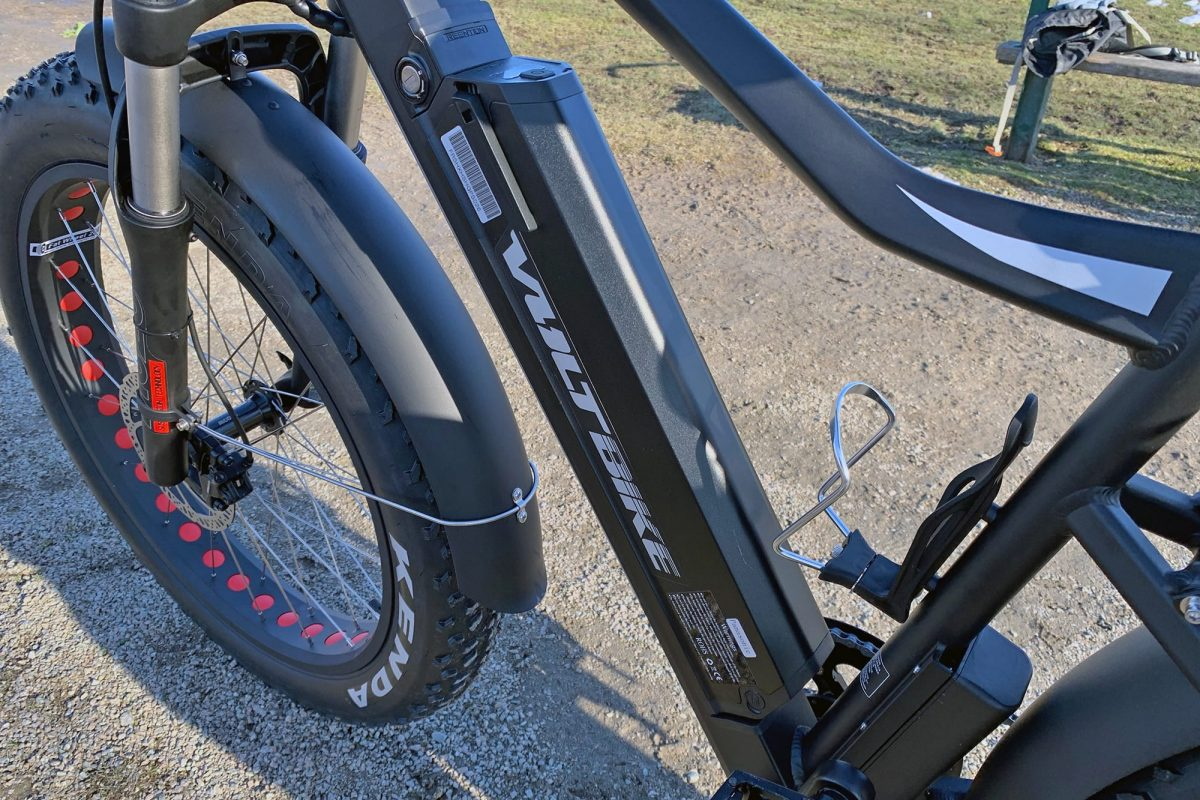

Here's an example photo I found - Dono Be would have to confirm it matches/closely matches his wife's bike.
Have a look at those rims with the 4.0" tires mounted on them. What do you think - 60-65mm or 80mm?
I ask simply for fun and in support of helping Dono Be out. :)

I didn't bother to take a look at a Voltbike but just guessed 65mm....for sure those look like 80mm. Anyway a quick search revealed this site that seems to list a plethora of low rolling resistance tires:
(and yes, full credit goes to Calicoskies here on EBR as the photo below comes from his review thread here on EBR - https://electricbikereview.com/forums/threads/voltbike-yukon-750-limited-2018-edition.24155/ ) :)
I checked Courts full review on EBR for the specs... looks like 80mm internal rim width.
