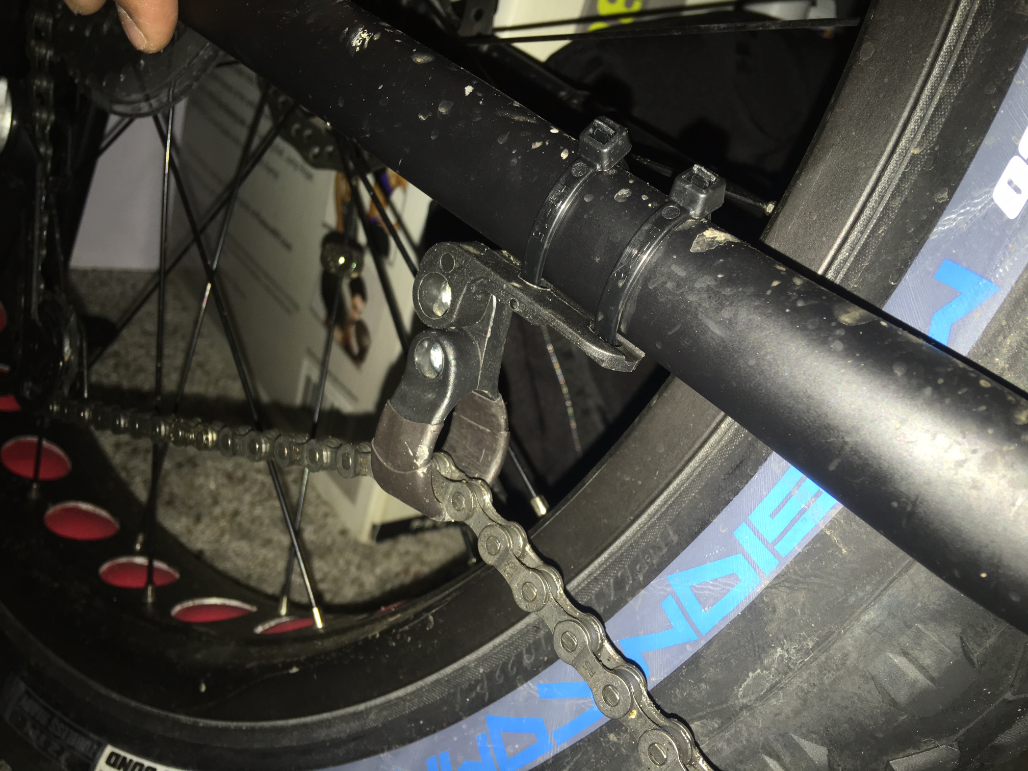

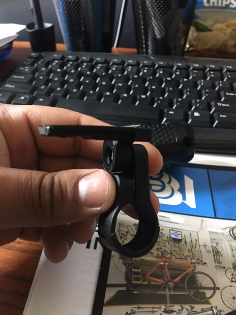

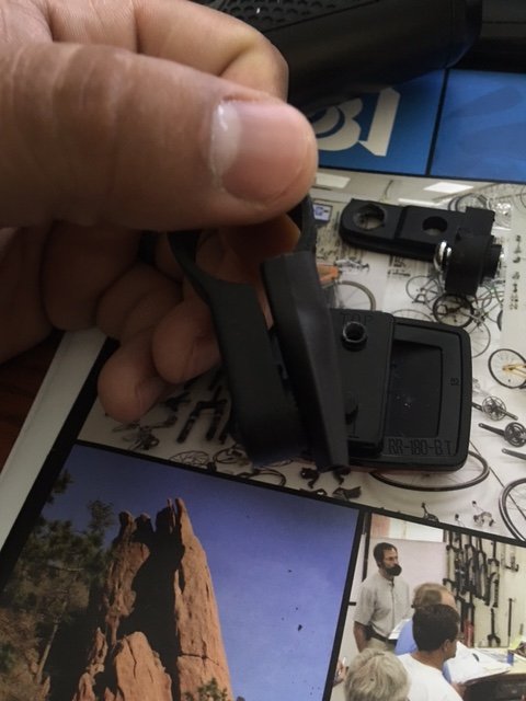

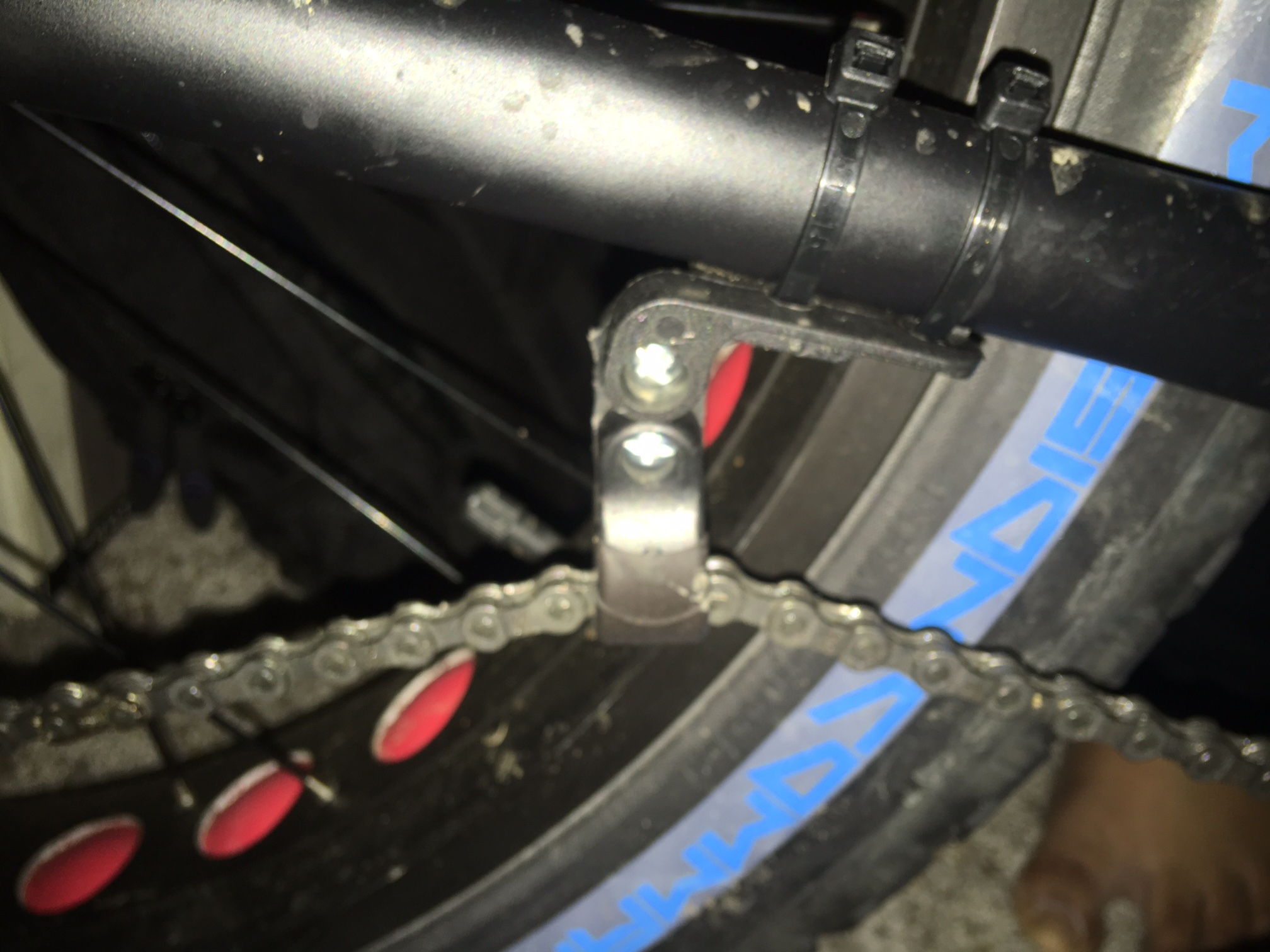

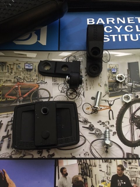

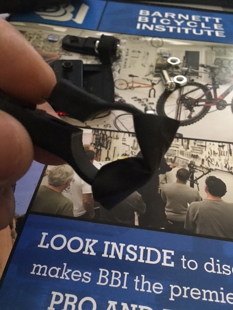

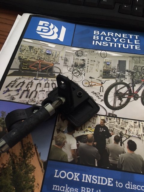

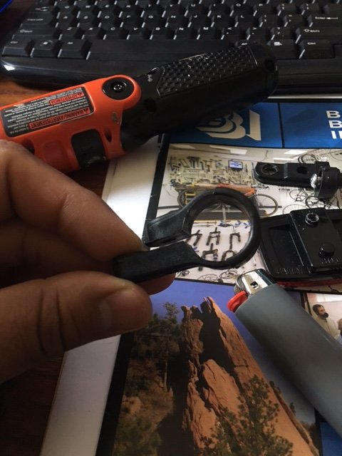

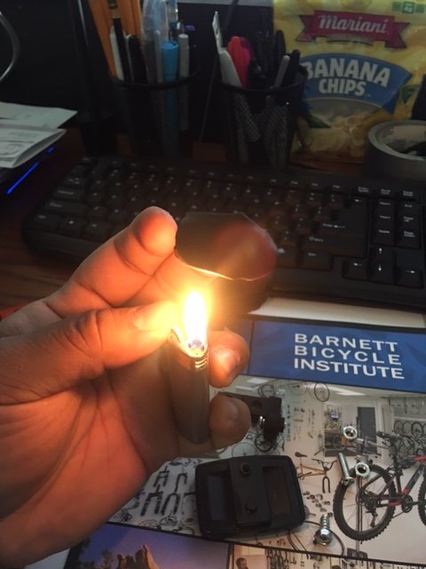

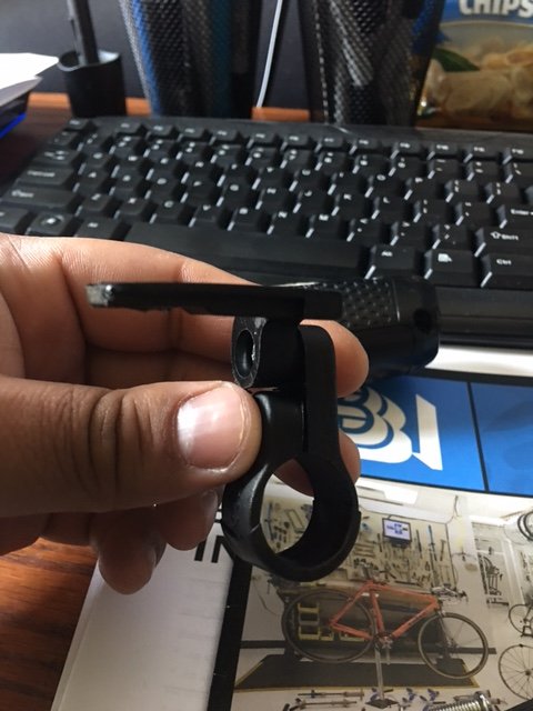

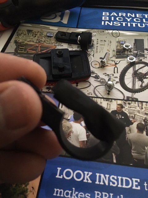

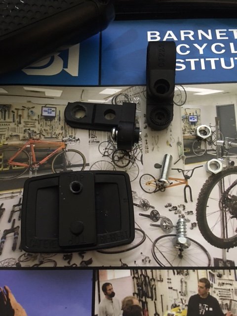

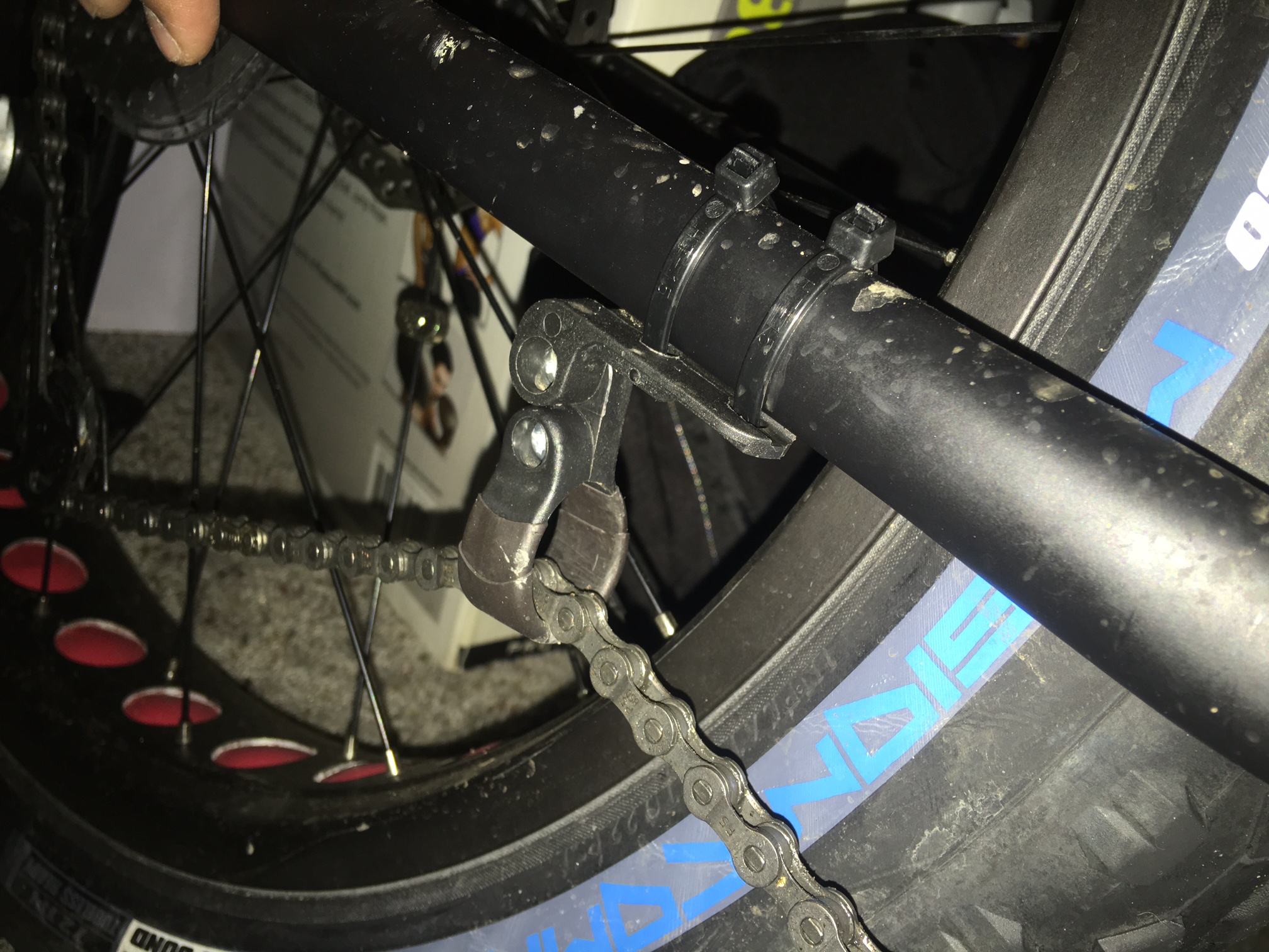

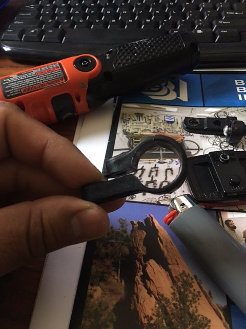

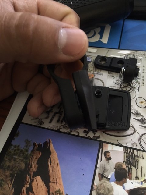

A chain guide will do the trick as well. Check out my DIY version.

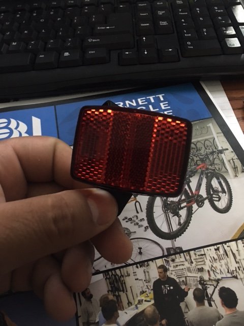

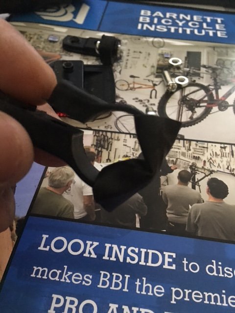

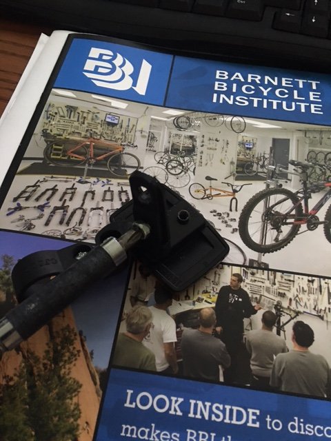

Haven't been riding as much as I'd like. Mainly due to my own laziness and my chain which kept dropping off when switching gears. So I started doing some research and even though there are some guides out there that are like 50$-60$ which is reasonable and some that aren't, I decided to build DIY one myself.

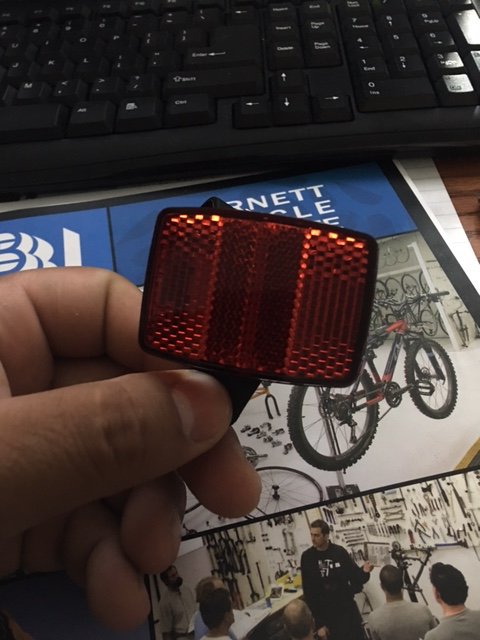

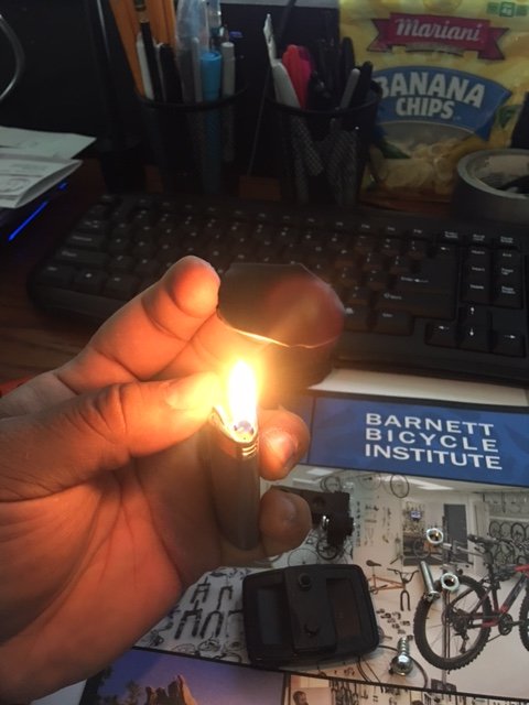

Using a rear reflector I completely disassembled it. Next I wedged some heat shrink on the coupling part and using a lighter formed it to the ring.
After that its just a matter of reassembling the reflector in a way that using some zip ties it will hold tension on your chian. See pics below.View attachment 5364 View attachment 5372 View attachment 5371 View attachment 5370 View attachment 5369 View attachment 5368 View attachment 5367 View attachment 5366 View attachment 5373

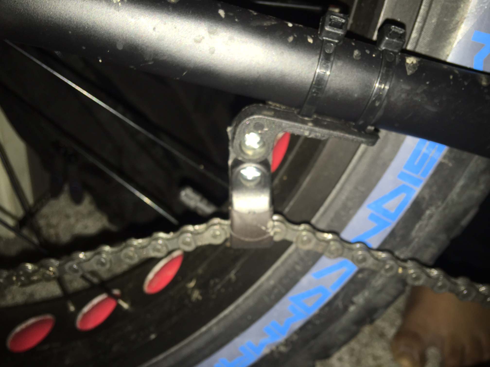

When all is said and done it should look like this on your bike.
View attachment 5375 View attachment 5374
And that's how I fixed my chain dropping issue with spending any money.
