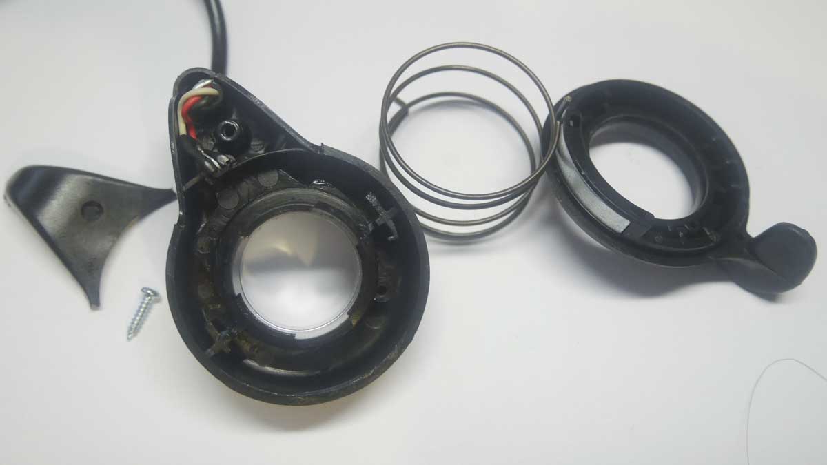

Have had two Rize bikes, first one is great, therefore decided to buy a commuter mid drive from same company. Unfortunately, l think l have a lemon. First….to date, customer service has been great. They’ve replaced a freewheel after 7th gear broke some teeth. Company admits they had issues. Just got a new replacement battery as the original had issues getting any reasonable distance per charge. Today went for first ride with new battery. Just a quick 30 second ride to see if all systems go. Always use throttle to overcome initial inertia. Seemed fine, turned around to get home and go for ride later. Stopped, straddled bike, took hands off brakes….bike took off like bucking bronco. Finally, got under control by shutting power off, not easy because hands had to stay on brakes. Noticed small wrench error sign…04. Checked manual…no 04 error message. Go online, see Juiced Bikes has an 04 error message. Indicates a throttle issue. Check bike….sure enough the throttle had not snapped back. Played with it, got it unstuck, error message disappears. Happens again though, but bike is at 0 PAS, so no problem.
Here’s the rub…l could have had this happen a hundred yards further at a busy intersection, lots of cross traffic. Had l taken my hands off brake there, could have bolted into traffic. Might have been my demise.
Waiting to hear back from Rize, 2 phone calls and an email. Have lost all confidence in bike. How could l morally sell this to someone and not tell them about this? I sure don’t want to keep it now. Bike has 100 miles on it. Mostly, it’s been waiting for parts or in LBS. Check your throttle readers.

Basically, the thumb throttle just stuck. When pressed and released sometimes worked...other times remains stuck. Scariest thing... is l would never have believed this could happen. They're sending me a new throttle...but now l know NOT to trust it will release itself when applied. I use my throttle at times on my heavier fat tire bike when biking on trails near my house, when my momentum slows. I must stress that customer service is good...but l would not recommend using the throttle on this commuter e bike if there is traffic. The KEY TAKEAWAY here is.... don't trust your throttle regardless of who sells it! I may not replace the throttle or disable it rather than use.

Nothing more than a piece of plastic and a return spring. There's a magnet embedded in the plastic that rotates around a Hall sensor to generate the throttle voltage.
There's several common trouble spots.
One is when the handgrip is too close to the throttle and prevents it from springing back. This has happened to me.
Another is a break in the wire. The throttle has three wires, power, ground, and signal. If the ground wire breaks, you get full throttle. I've seen this too.
Another is if the wiring gets wet, the throttle may come on. This has happened to my wife.

One time I was changing handlebars and tightened down my throttle too much, it started to stick
Not 100% sure if I had to close to something else or if I cranked down the cheap plastic too tight but that might be another thing
