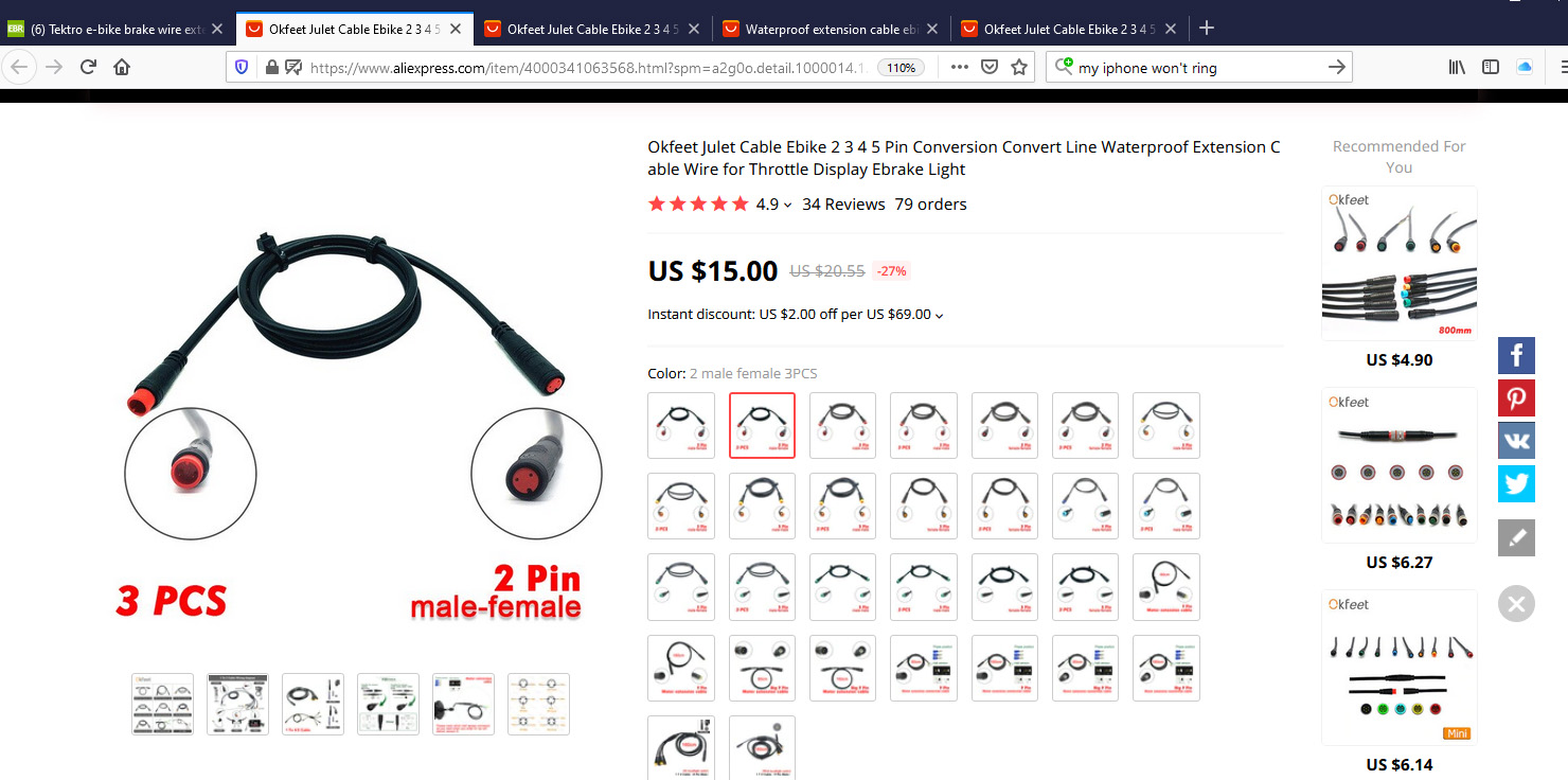

Strange, but most vendors on ebay/amazon carry male/male or female/female. What good is that? Here's a 2 pin male/female on Aliexpress. Julet and Higo differ, but should work, except for being 700mm (27 inches) long. You're going to want to shorten it, and if you do that, you can just buy the individual connectors on ebay with none of the aliexpress hassle.

Hmm, so far I only found this one with locking mechanism
Timpo
Strange, but most vendors on ebay/amazon carry male/male or female/female. What good is that? Here's a 2 pin male/female on Aliexpress. Julet and Higo differ, but should work.
The link you provided does not show what OP was looking for.. :(

That's not the same one.
The OP has different 2 pin connector, they're not compatible.
OK. I didn't look at the picture. Didn't think they were different. I've had two ebikes with Tektro disk brake levers, and they use the two pin Julet/Higo,
You are lucky they do. Julet/Higo are standard. And easy to get. I did order the one from Hilleater as it looks life I can adapt that one. I do have another work around to make it work the way I want. It requires moving the display closer to the right motor cutoff and just disconnect the left. I use both brake levers at the same time, so one cutoff will work.
