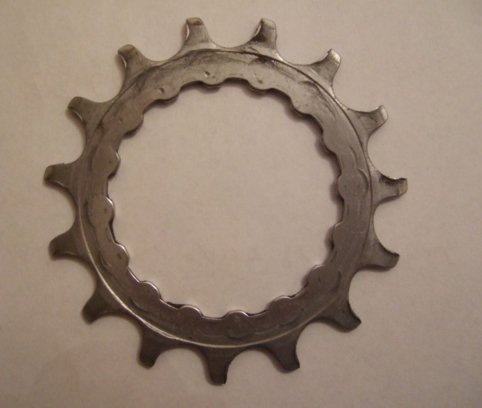

Oh hi,
Below are two drive sprockets with 600 miles on them from Bosch Gen 2 motors. My motor is Active line, they other sprocket is from EddieJ who as Performance line.

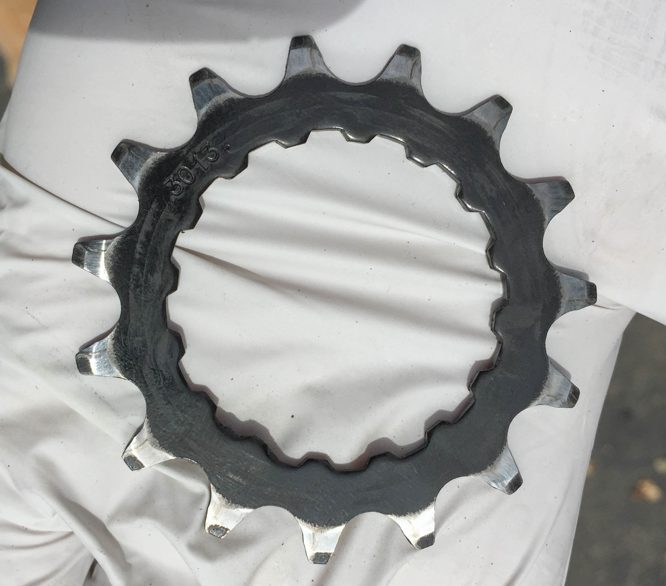

Eddie's Sprocket....
Quite the difference in wear. Even the splines for mounting on the shaft are rounded.
I conclude three things:
1 Performance line must contribute to wear faster than Active line
2 Eddie is a very aggressive rider in harsh conditions (okay we already knew that)
3 I think I am afraid to ride with Eddie :)
