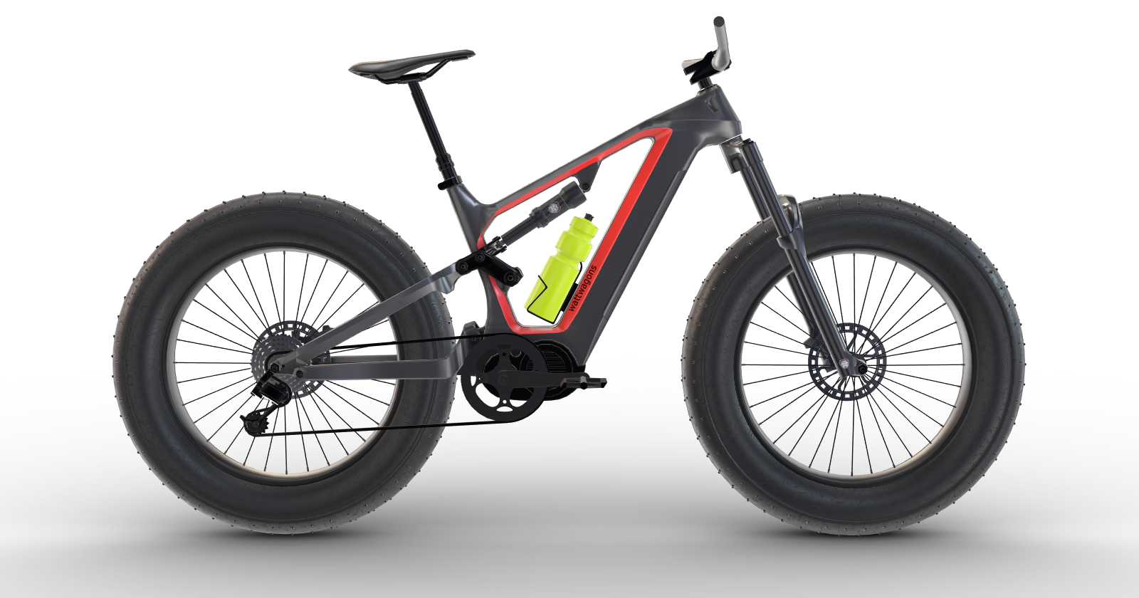

Frame Dimensions- The picture below is what brought me to WW in the first place; the 21” Hydra Frame. The forum has many locations where others have asked for XL but were only offered a 19” Large. I’m so giddy I kept bugging @pushkar to go for the XL frame investment! I suspect there will be many more big guys like me that will be happy for this decision too. 15” Small, 17” Medium, 19” Large and “NEW” 21” X-Large frames are available.

That’s a Hydra!!!

As to frame size. My 19" large frame AM 1000 is bigger than my 21 1/2 Specialized XTC MTB. Longer and taller. Going off the dimensions in the above table the Hydra is at least as big as the Frey and bigger in some measurements. I like big frames but too big is a problem. I'm 6' 2" with a 34 in inseam.
