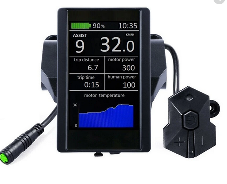

The 850c display I have on my Open Source TSDZ2 has that info and more but it took some doing by a community to make it happen....
It is nice to see how much effort you are putting in to inspire you to get with it and PHDI
Do you find the human power accurate? It seemed about 1.5x to 2x higher than expected when I used it.
Back when I was playing with my opensource tsdz2 in early 2019, I focused alot on the code that calculated human power. In the end it was a simple cadence/crankarm length/force calculation. Of course its not that simple in the bigger picture as you have to scale it due to not having constant pressure throughout the pedal stroke and it wasnt clear to me how fast the torque sensor was being sampled (of course the sw does this but the hw delay in the low pass filter was pretty big). In the end I was just going to scale the human power but decided to just set the assist levels lower.

Mr. Lemming, quite frankly I don't get that scientific about it. I just ride, but with the info that is there I do notice that it goes up with effort and down with less effort on the human and motor side. Heck I have never even gotten the speedometer to work and don't use the odo either. I've been using a TS since '18 with the stock display that I pay even less attention to. The only reason I mentioned it is that it seemed to address the OP's needs although it would probably never be of use. What can I say....cabin fever?
