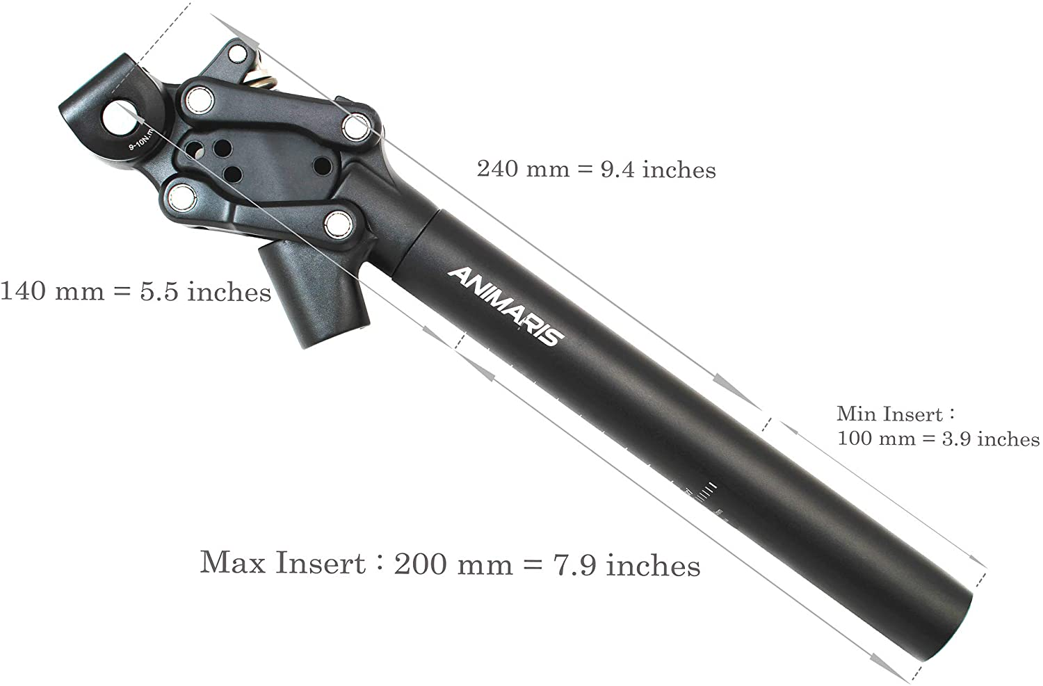

I would recommend that you take a look at the Satori Animaris... best of both worlds with both a spring pre-load and elastomer.
AmazonSmile : Satori Animaris Bike Bicycle Suspension Shock Seatpost - Mountain Bike or Road Bike 31.6x350mm : Sports & Outdoors
AmazonSmile : U/N Satori ANIMARIS Damping Suspension Seatpost Mountain Road Bike Seat Post 30.9/31.6mm Seat Tube 350mm Length : Sports & Outdoors

yes the Suntour works well as does the Animaris! i use both these post, i like the Suntour ride a lil better but i hate that the adjustment screw is in the seat post! i also think the Animaris is built more sturdy but time will tell.

ElevenAD, thanks for the reply. I had seen the Animaris and wondered about how good it was (or wasn't) The rubber bumper in the center should act a little bit like a damping mechanism.

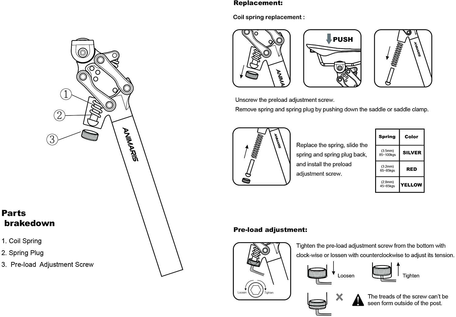

This is a good value but it didn't work for my weight class (135-140 pounds). It was way too stiff for me no matter how I adjusted it. I've read that the spring could be swapped out but I went with Redshift instead.
Thanks for your feedback... the Redshift shock stop Seatpost is a nice unit. ;)
Regarding the Satori, various springs are available to adjust the preload flexibility.
99-143lbs AmazonSmile : Spring for ANIMARIS(2.8mm) : Sports & Outdoors
144- 187lbs AmazonSmile : Spring for ANIMARIS(3.2mm) : Sports & Outdoors
